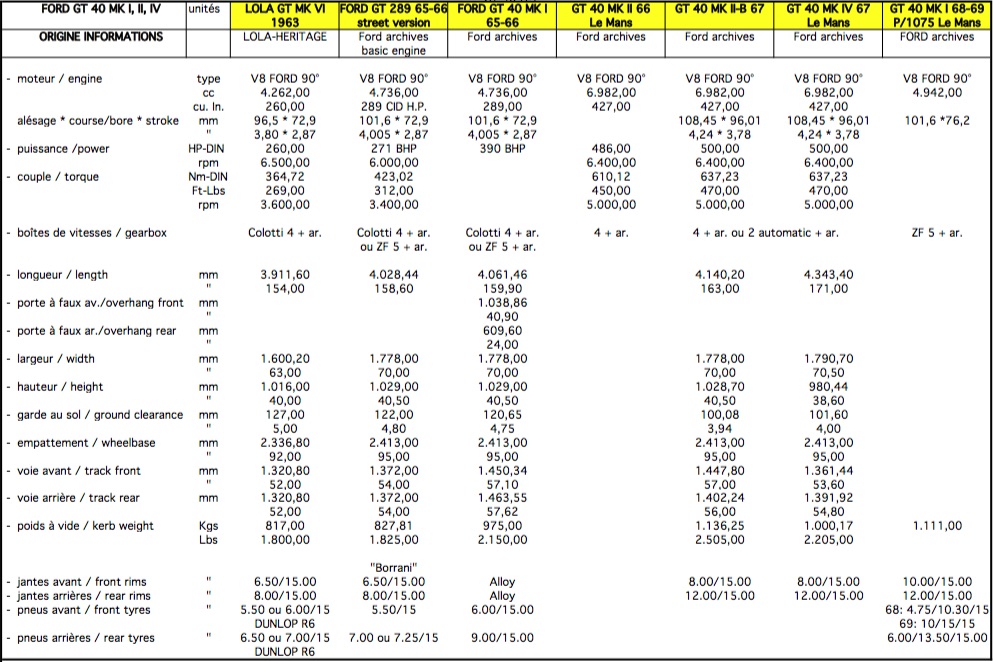

After several contacts with a FORD archivist, I was able to obtain some documents from the 60s about the different GT 40s.
I made a summary but would like the experts to confirm it, or tell me about possible errors.

The Gurney Weslake engines used in GT40s had a single cam in the block and pushrods to activate the valves.
