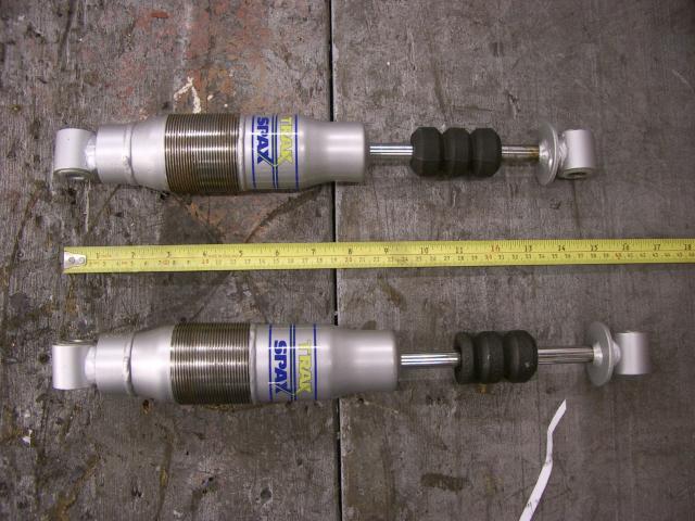

Hi Simon,
These may help, they are standard GTD.
Regds,
