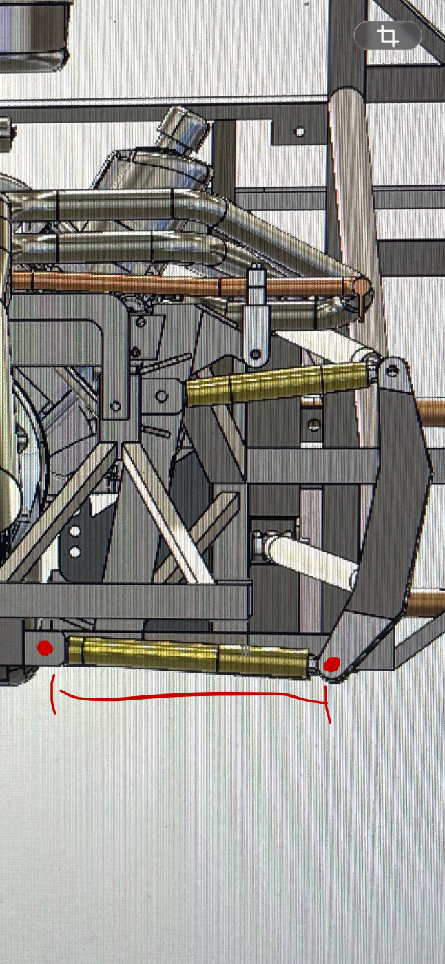

I’m making good progress on my 3D model of the Ford GTD 40 Mk1. However, I would like to confirm a measurement that seems a bit surprising to me.
Does anyone here own a Ford GTD and could measure the center-to-center distance of the rear lower suspension triangle?
P.S.: please see the attached photo.
Thank you

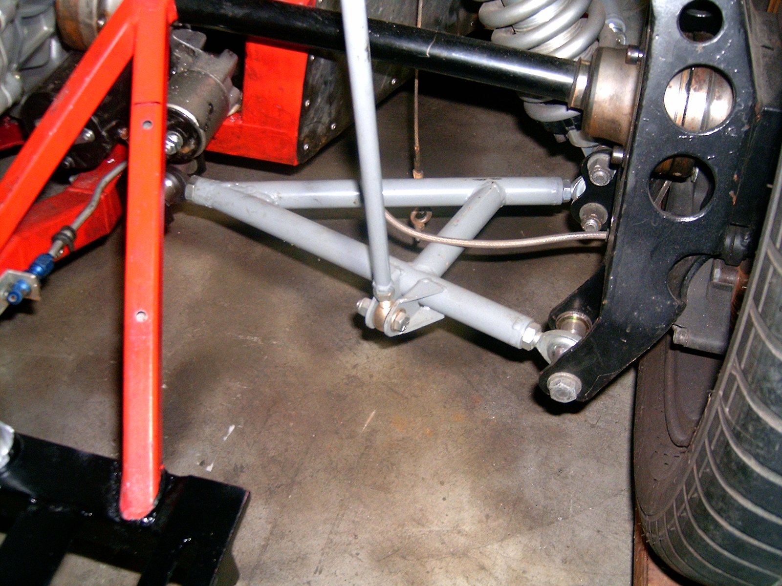

This is the rear of my GTD. The lower A Arms are home made and use rodends as you can see. That makes them adjustable. However they were made on a jig that used the orginal GTD part as a template. The measurement you asked for is 16 inches center of bolt to center of bolt.
