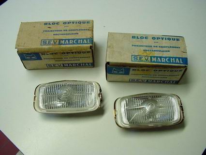

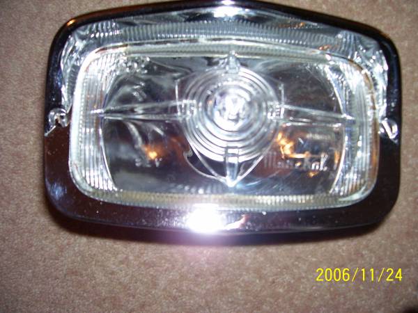

I have the 652 spot lamp and would be happy to buy the one you have to make a pair should you find the fog lens you are looking for. I have posted both types for reference.
Regards
Stephen

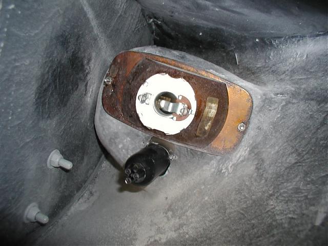

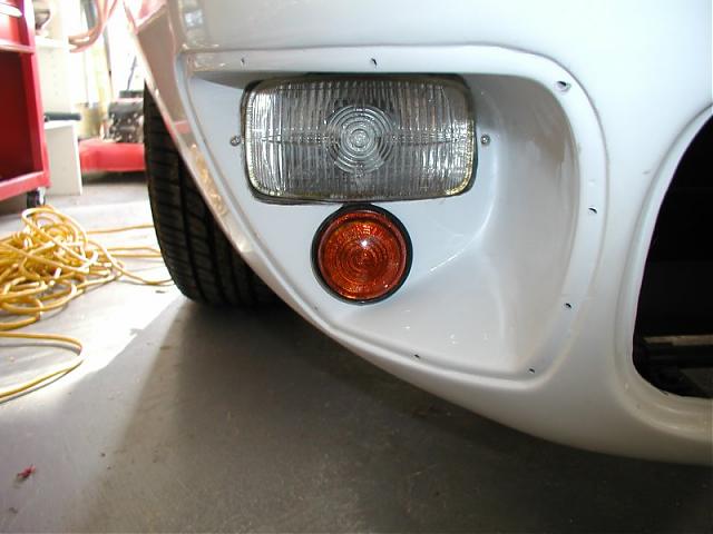

Hi Richard - I made a card template of the lens first to get it straight before cutting the openings for my Marchals. I installed them from behind so just the lens protrudes. It's a tight fit and you might have to sand down the inside fiberglass mounting area for them to seat flat. I also used L488 indicators, tossed out the chrome ring and trimmed the rubber boot to fit better.
I can snap a few pics if you want reference.
Chris
Hi Richard,

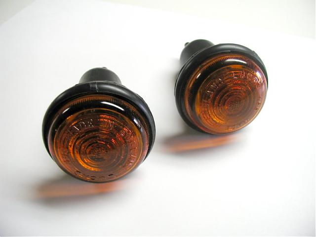

Hopefully these help, let me know if you need anymore. The original holes were cut for the spot lamp and indicator supplied by MDA but since then I've changed many parts to original where possible. Everything needs a clean-up and I will probably put a small bead of sealant around the glass.
The L488's are shown after trimming the rubber boot and tossing out the chrome ring.
Chris

Thanks Chris. Thats brilliant.
I take it you aren't going to fit any of the chrome surrounds - just the lenses? I already have indicators fitted, so will have to possibly move them. But yo pics show me everything I need.
Getting rid of the chrome ring gave me more room to play with & I didn't like the chrome anyway so it worked out for me. The L488 lens seats snugly in it's rubber grommet so there is no issues of it falling out with the ring removed.
Happy to assist-
Chris
