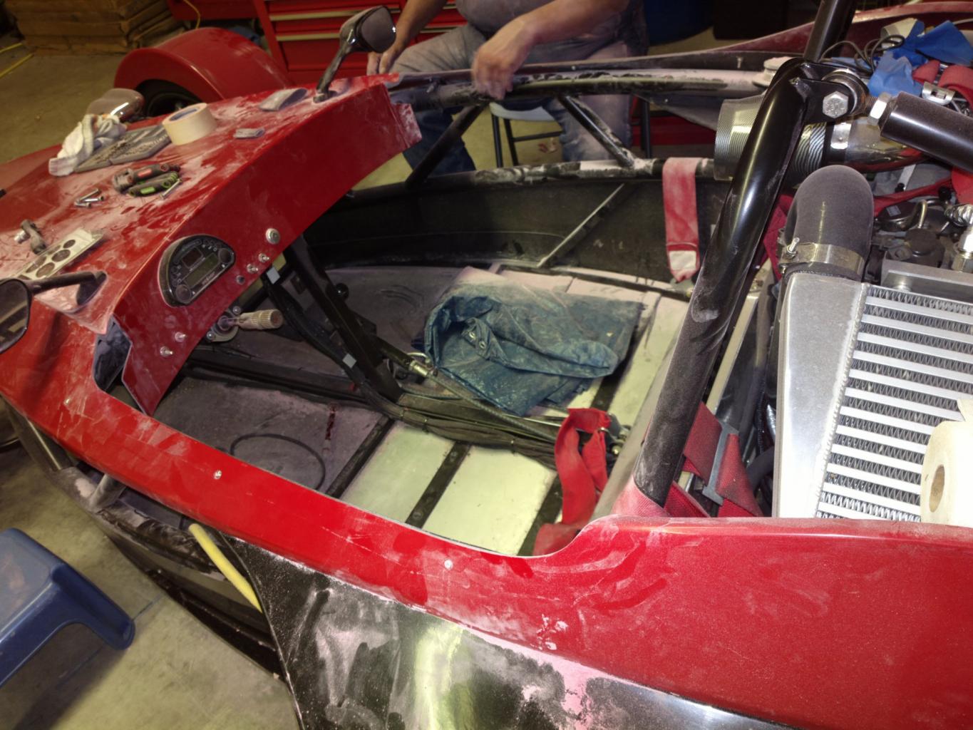

First order of business: Trim bodywork to get back 6" of cockpit width...

Steering column raised 2", body cut to clear the tie rods, body cut for more cabin width, pedal box moved, fenders removed and mounts in process of being cut and welded for proper fender orientation, shifter relocated and braced, roller bearings on shocks installed for easy adjustment, front wing mount fitted, turn signals fixed, finally got the title so it can be in my name, seats almost done, got the tuner lug nut adapter so I can take the wheels off and get some proper rubber. Don't have brake lights yet and haven't fixed the firewall.
Hope to be on the road soon, then I'll work on the tune. My rollback wrecker is supposed to be done with fresh hydraulic lines by June 1 (drop dead date) so I can take it to Putnam Park.
