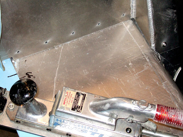

Hi Folks,
Does anyone know what these five holes on each side of the rear bulkhead are for?
Best regards,
Al
They are for attaching the angle bracket to hold down the firewall...which should be in your parts box.
This bracket gets epoxied on when your final body fit is accomplished as this position can vary due to body alignment..
