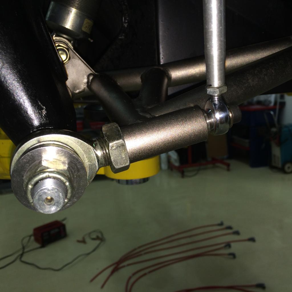

During the last couple of sessions at TWS if I accelerated hard the GT would pull to the left. But with aggressive driving it seemed to do fine. Could not figure out what was going on.
Well I found it Saturday by accident which probably saved an accident in the future.
This is a weak link that I noted when taking the car apart and reassembling it after I got it some years ago but didn’t do anything about it.

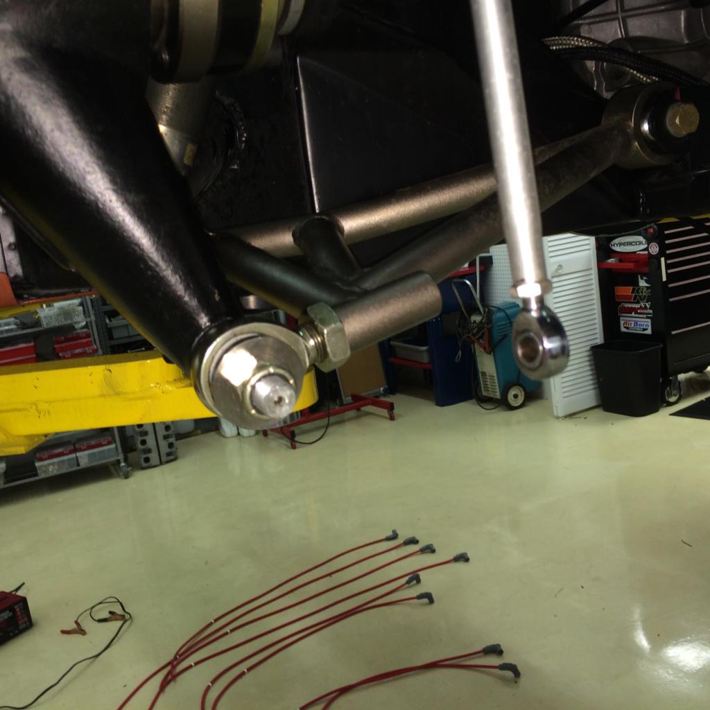

It has to do with the way that the rear sway bar link connects to the lower control arm of the rear suspension. The part that I didn’t like is that the same 8mm cap screw that connects the link to the lower control arm spherical joint is also the same 8mm bolt that keep the spherical joint in place. The joint does not screw into the lower arm but is held in place by this 8mm cap screw. Granted this allows for easy suspension adjustment but it places a lot of odd loads on this small cap screw.
The cap screw had sheared right where it screws into the end of the joint. Because it was so long it stayed in place and actually still allowed it to do it intended job of transferring sway bar loads to the suspension. What it couldn’t do is keep the lower joint from sliding in and out of the lower control arm sleeve under hard acceleration. What is weird is that it stayed in place so long. I was simply cleaning the road grime off the suspension and hit the sway bar link with my arm the cap screw and link fell off. I could grab the bottom of the upright and move it in and out of the sleeve by hand. So under hard acceleration the joint was sliding out of the sleeve causing the left rear wheel to go excessive toe in. When power was removed it would slide back in and all was good again.
This is my fault for not replacing these low grade cap screws with better bolts as I had done with all of the other suspension bolts that I had replaced with air frame bolts. I would suggest that you replace this before any possible drama happens. There are some quality ARP blots on their way to me.

I don't have a horse in this race, but I'm curious as to the rear-lower-outer rod end, and how it is attached to the arm? Does it simply slide into the arm, and use the jam nut only to prevent it from moving inboard? If so, then is the M8 bolt used to prevent the rod end from moving outboard? is so, is the rod end rifle drilled and threaded to prevent the rod end from moving outboard (which makes no sense)? I'm have difficulty in understanding how the M8 bolt holds the larger rod end in the sleeve.
Mike Trusty
That is correct. The rod end simply slides into a sleeve. The sleeve is NOT threaded.
That is correct.
The sleeve on the cap screw end has a smaller diameter sleeve/washer welded to the larger sleeve where the rod end resides. There is then a stepped bushing with the outer diameter the same as the smaller sleeve opening and an inner diameter of 8mm.
The purpose for this arrangement is to allow for quick adjustment of the rear toe. If the rod end was threaded into the sleeve then you need to disassemble the lower suspension, guess at the adjustment and reassemble and probably get to do it again. Not very conducive to quick adjustments at the track. I think the problem is two fold. One is the apparent low quality cap screw and that I found that every bolt on the rolling chassis had been over tightened from the factory. That is why I replaced all of the major bolts with AN airframe bolts. I recognized this problem from the beginning but failed to do anything about it. My bad. I often joke about the actual gorilla that I envision they have at the factory doing the final tightening of the bolts.
It is evident that the stretch load on the cap screw isn't that much because I'm not dead or hurt. It only slid out part way when full power was applied and then went back in place. That is why it was a mystery. You can not just look at it and see the problem. The cap screw was still transferring the sway bar loads because the side load on the cap screw was holding it into the sleeve described above. It was only when I put the car on the lift and hit it in the right direction that the remainder of the cap screw slide out. The rod end was happy to set there even when driving normally.
Now that we know that "aladinsane" had the same problem I think it acceptable to consider this more than a coincident.
It is much easier to replace the cap screw now. The repair required taking the suspension apart to retrieve the threaded end of the cap screw out of the rifle drilled and threaded rod end.
