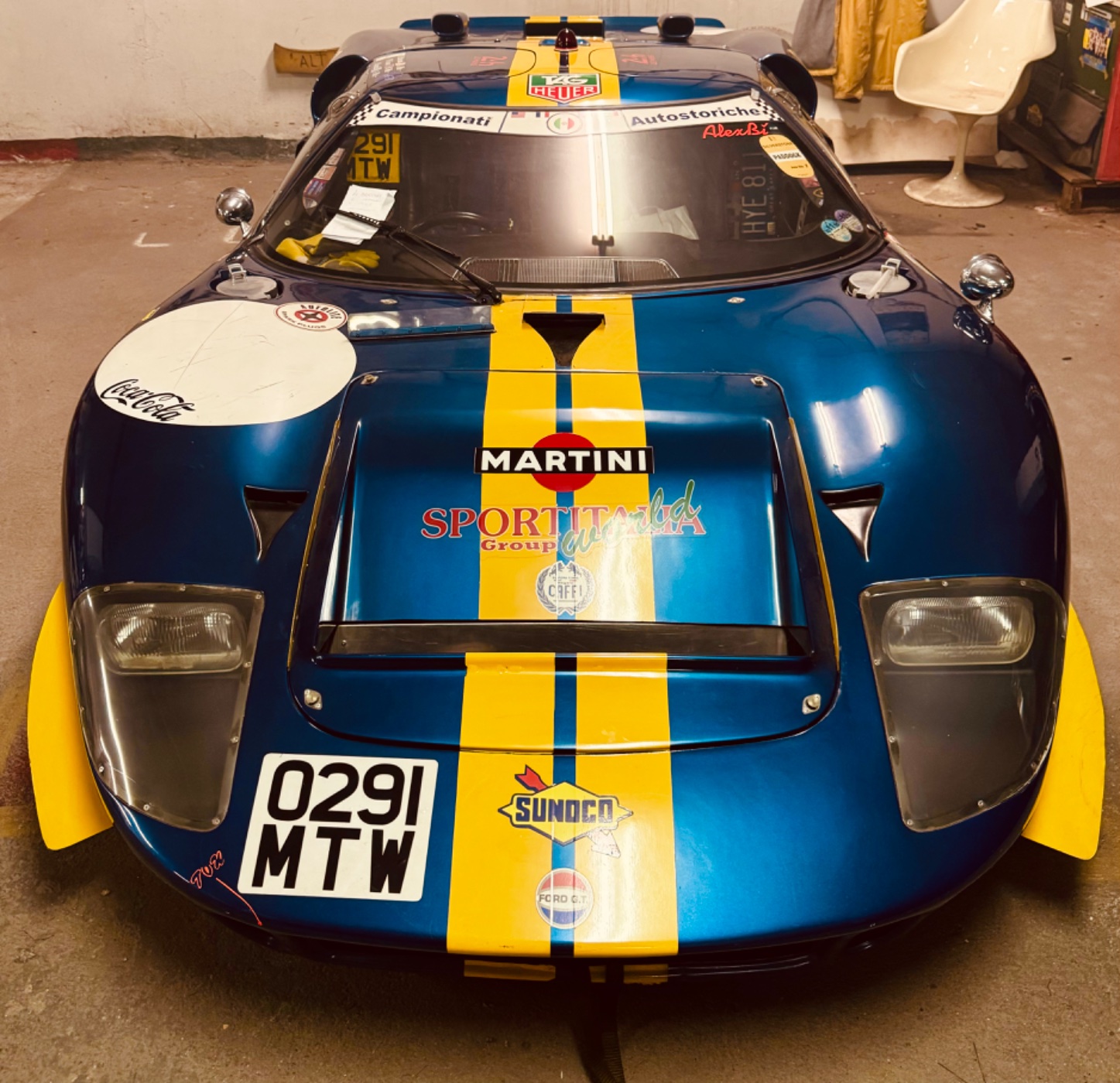

Good morning, I am Marco from Italy. After years reading your precious posts I decided to join the forum because the GT40 is my all time favorite car.
I am writing here because a GT40 has been offered to me and I am trying to find out the real identity of this car. The story looks to me a bit complicated. I’ve already seen a couple of discussions about this car in this forum. Hope that you experts will manage to help me to find out the what this car is and its story.
This is what the current owner told me about this car:
The car is a 1971 MK1 converted to MK2. He doesn’t know what she really is, he like to name it a rebuilt.

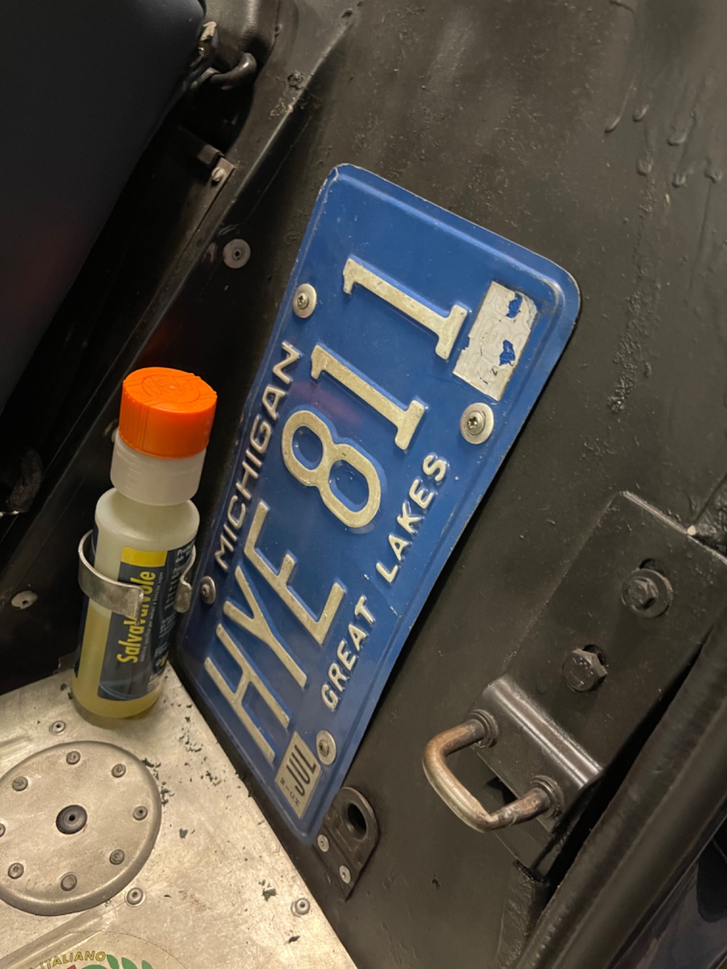

She was purchased by the current owner in UK in 2007. The previous owner said that he bought it in USA from a certain Mark Patterson in Michigan (don’t know the year). The car still has its own UK and USA plates. The current owner never registered the car because he’s a ex racing driver and upgraded it to race specs and raced it untile a while ago. For example it’s equipped with a ZF 5 speed transmission. The car has a FIA Passport.
D26F9604-A4E7-4106-B5AB-017D213A624C.jpeg1595B8D8-02AB-42EF-9F32-495D8FFD7999.jpeg549AC810-F9A5-40C7-A5B1-159E1C32316C.jpegEB93454A-049E-429F-9ECD-9462F8082C4C.jpeg78F4152F-1A75-4FDC-ABE5-EC6850A191EA.jpegCCC843F4-9C07-4F11-94C5-22783317F3AD.jpegF50B9434-A558-40ED-8404-0EA535AF4921.jpegD1AF7DD9-4839-471C-ABD8-62FC3F68CB27.jpegC11B894C-9C40-4491-BE77-2D36503F3F01.jpeg

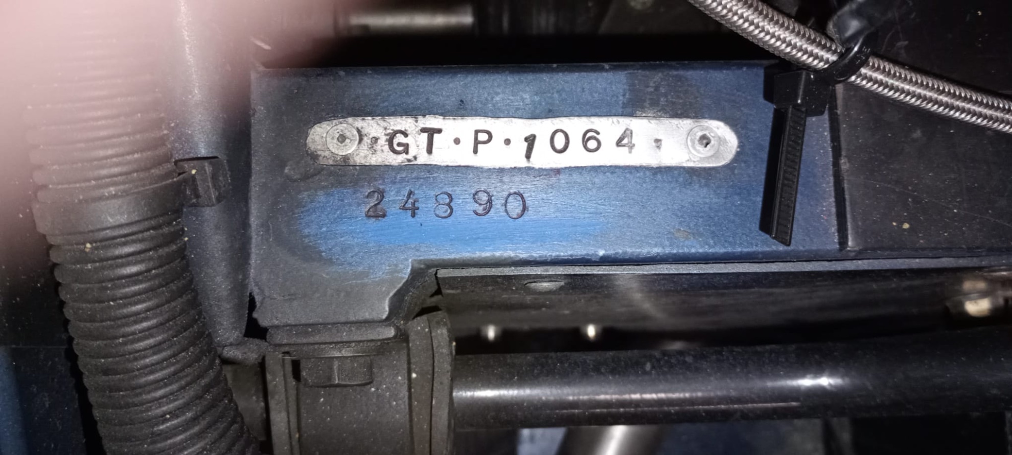

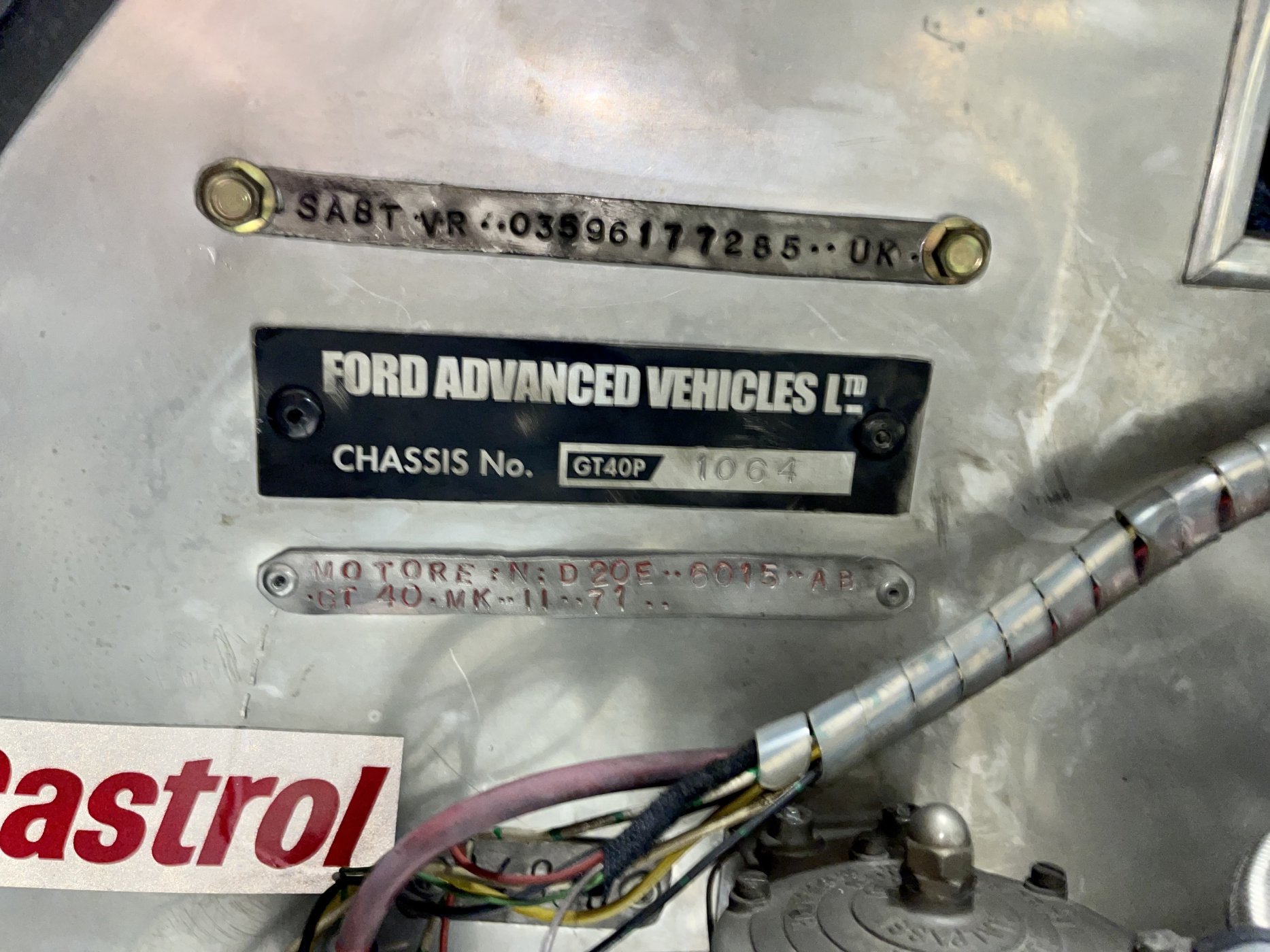

Now I am attaching VIN pictures
I am not so expert but the car looks to me to have at least 2 different VINs if not 3.
These are located in the engine compartment, left side, behind passenger seat.
While this is on the passenger side inside the cockpit
And these are on the front chassis

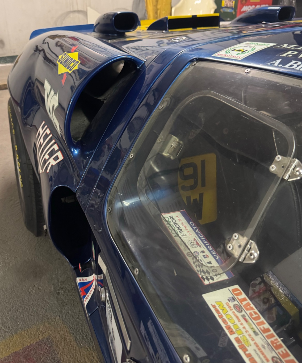

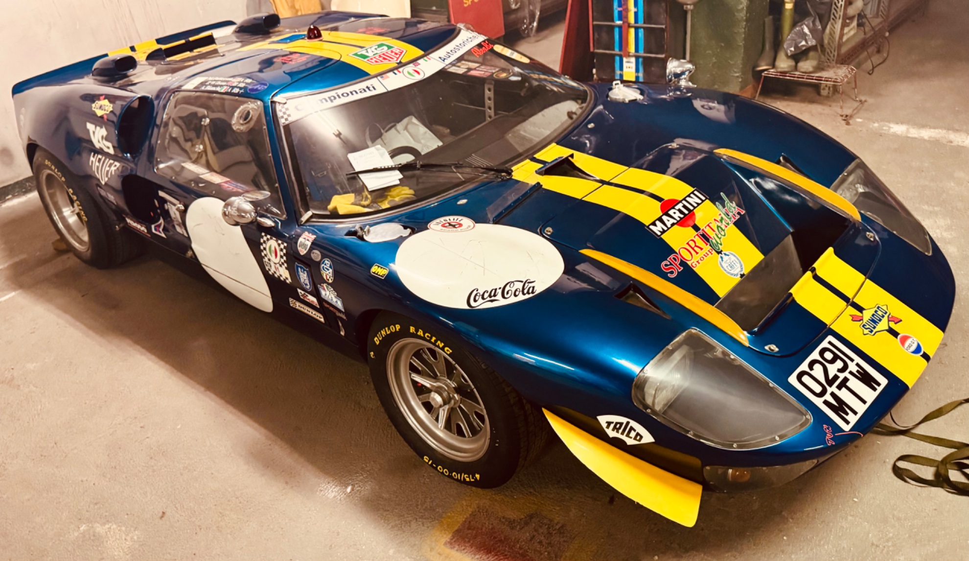

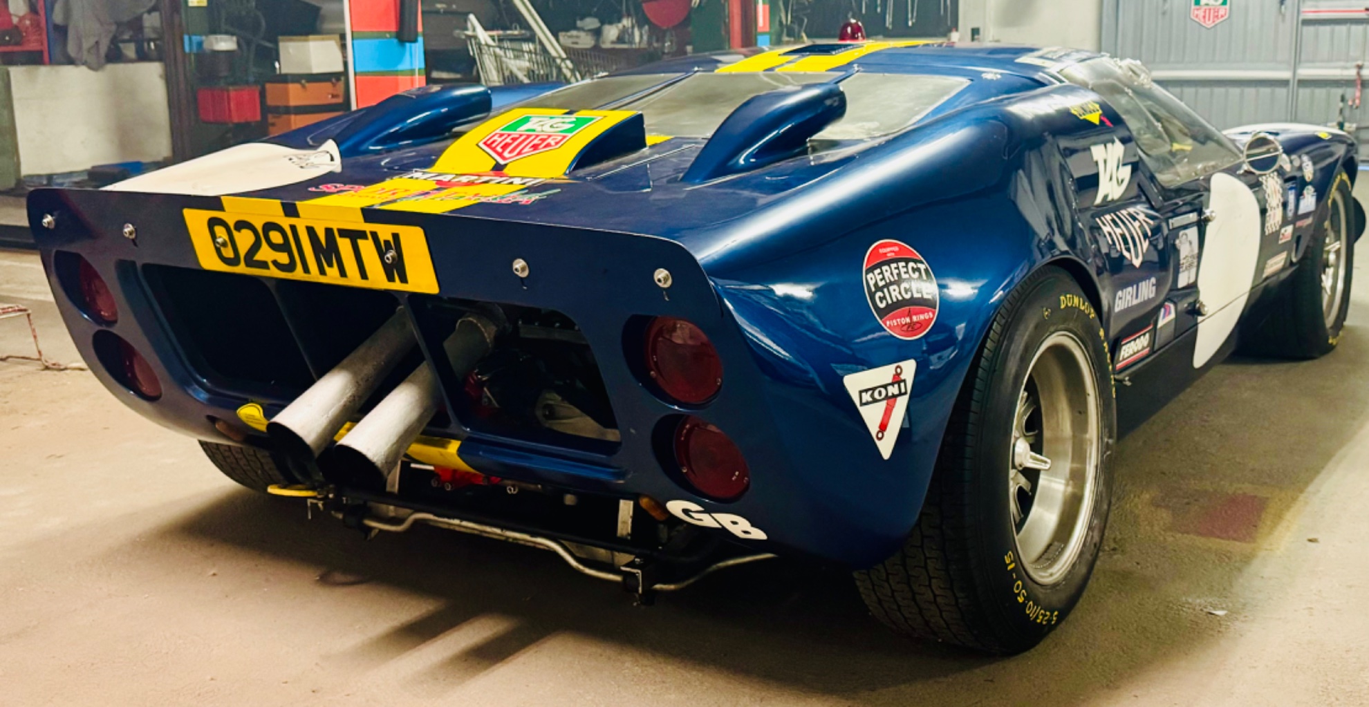

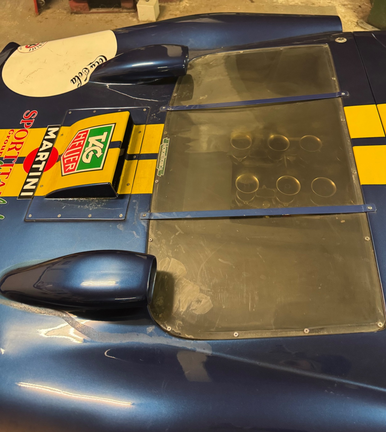

Before writing here I tried to make my researches and judging from the rear clamshell, taillights, and dashboard I would say this is one of the few GTD40 MK2 (I’ve read they have produced very few units). I’ve seen very few pictures of other cars with the same rear clamshell.
The VINs look weird to me. I’ve learned that SABTVRO vins mean “SABTVRO stands for, Stolen And Brought To Vehicle Recovery Office” and these cars are re registered on Q plates.
I’d be very grateful if someone could help me to understand this car, and to know what could be its value. The owner wants 180.000€.
It has been put up for sale on facebook from time to other for a long time.

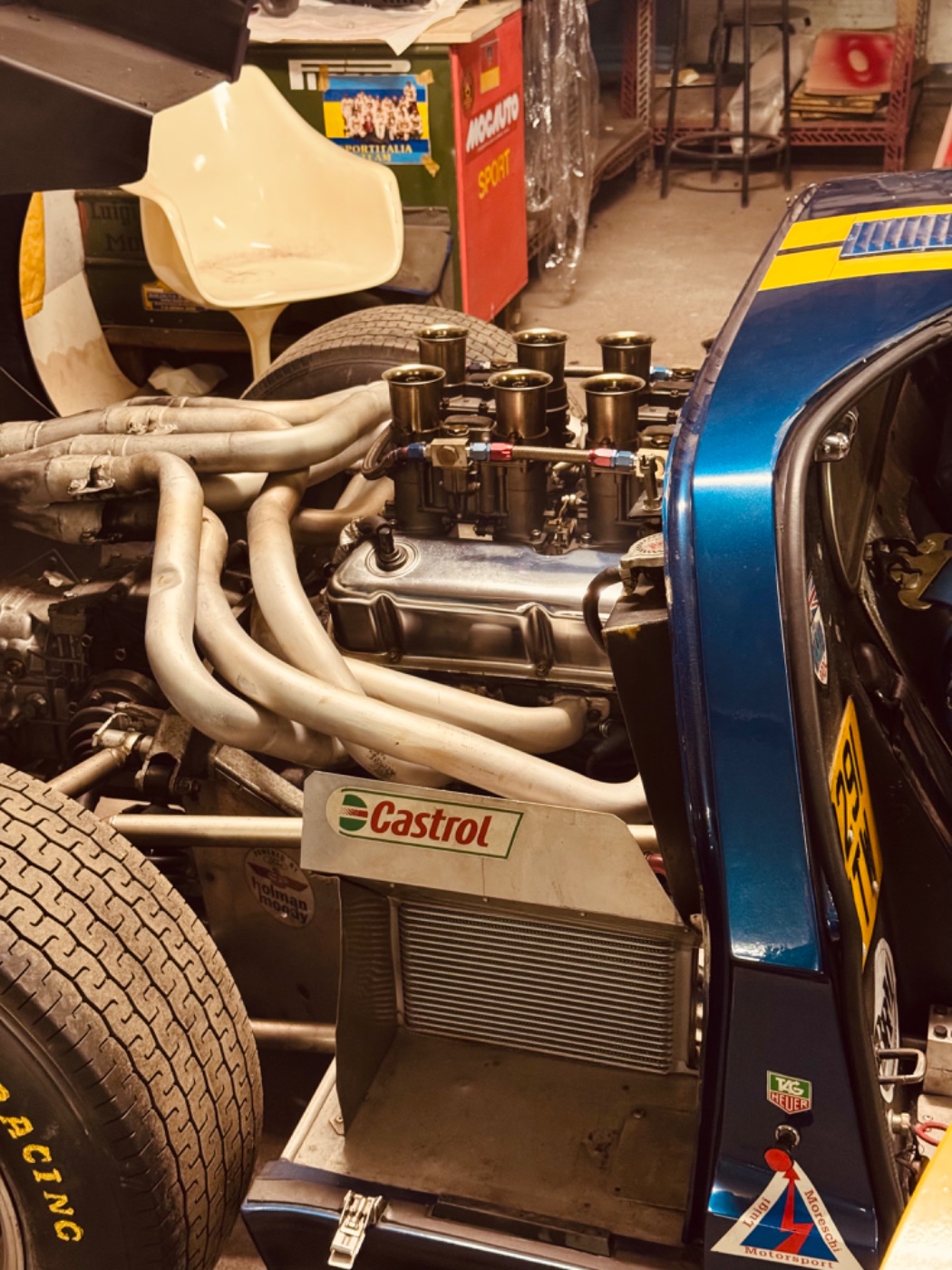

It is for sure not an original car as it is a spaceframe and not a monocoque. The rear clamshell is typically a gtd one (mk1 with mk2 scoops added + additional rearlights which are too big compared to an actual mk2 and a bunch of other differences).
A mk2 would not have a small block engine, neither a zf transmission.
I dont understand how it has been given a fia htp...

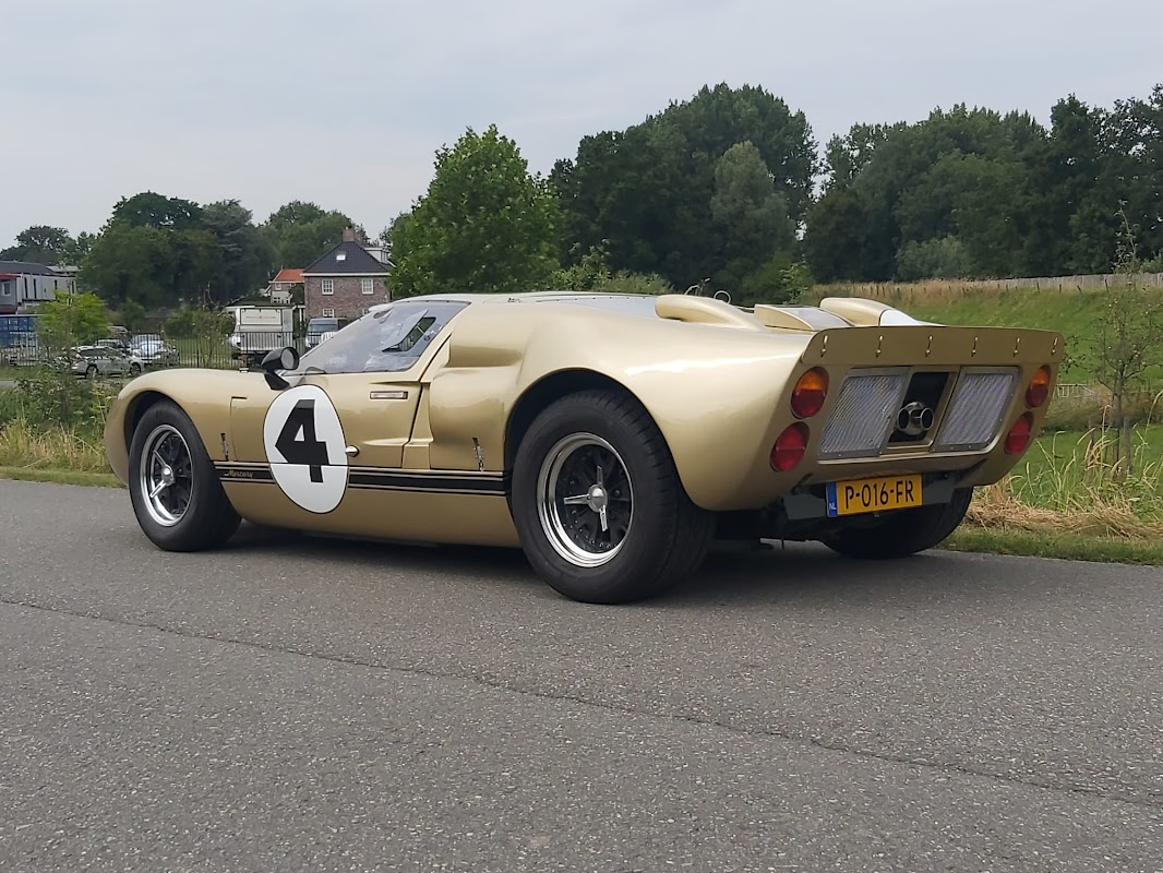

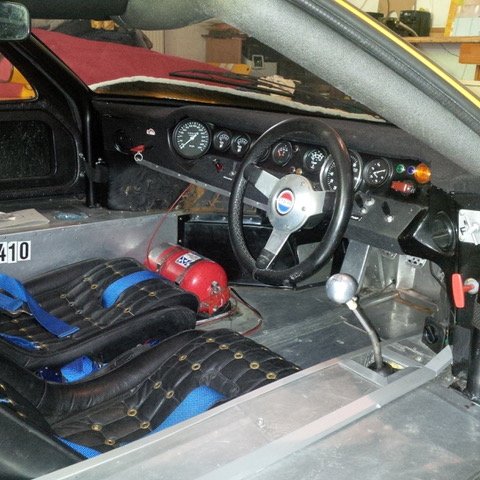

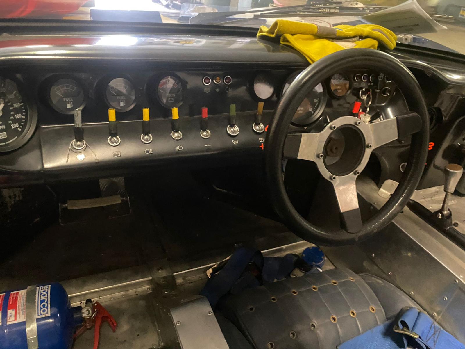

Hi Marco: I have pictures of a GTD MK2 - factory ``lightweight" from 1992. The car was up for sale around 2020 in the Netherlands. Here a few of them.

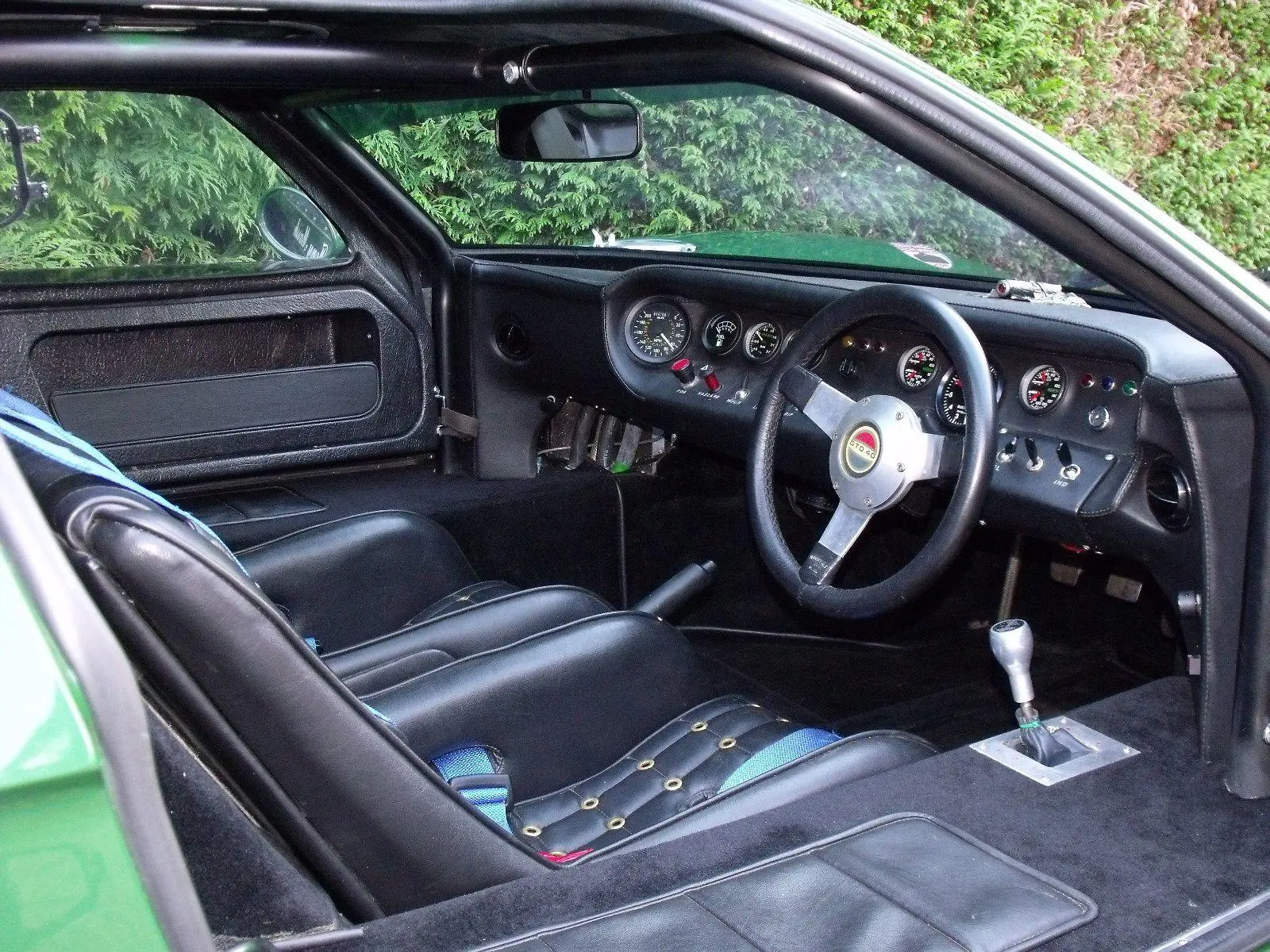

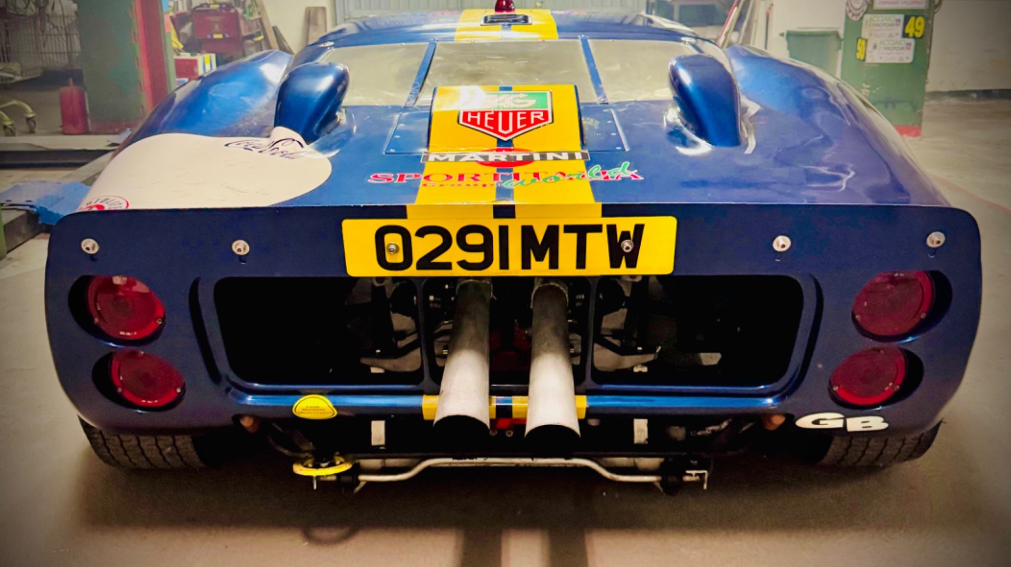

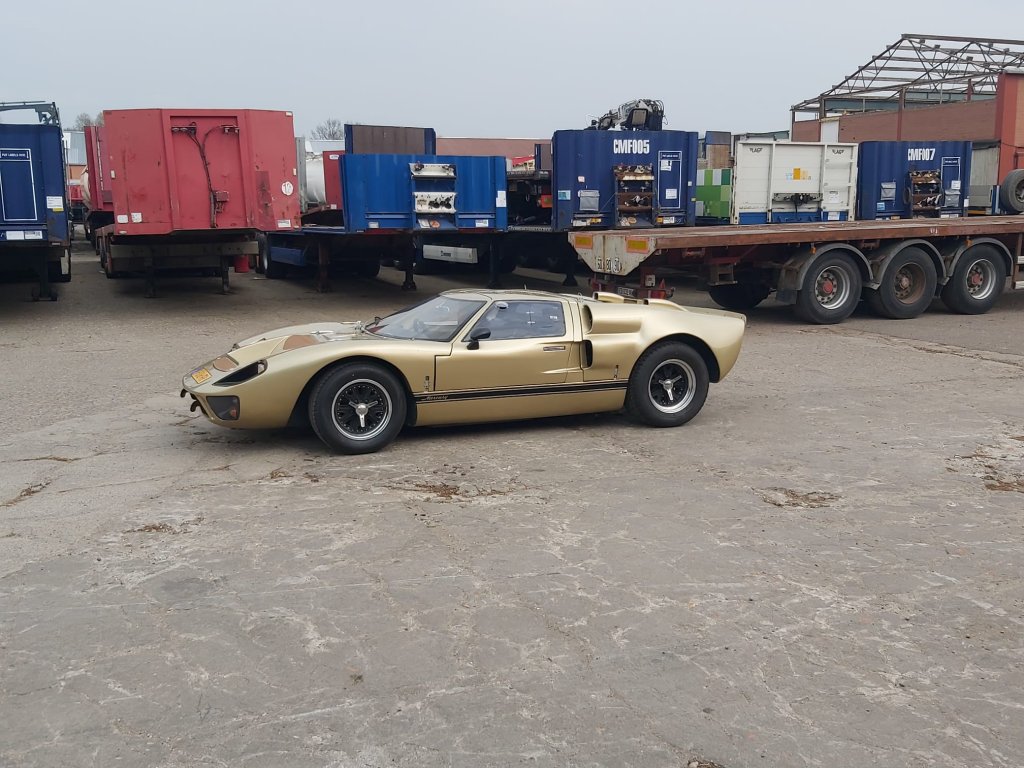

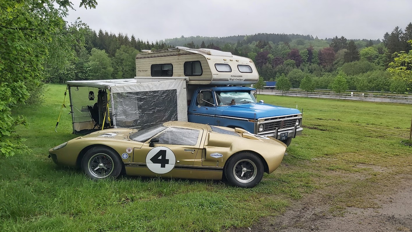

Thats a GTD MK2 for sure. I have one in the Netherlands, see pic.
Even the dashboard is a GTD piece.

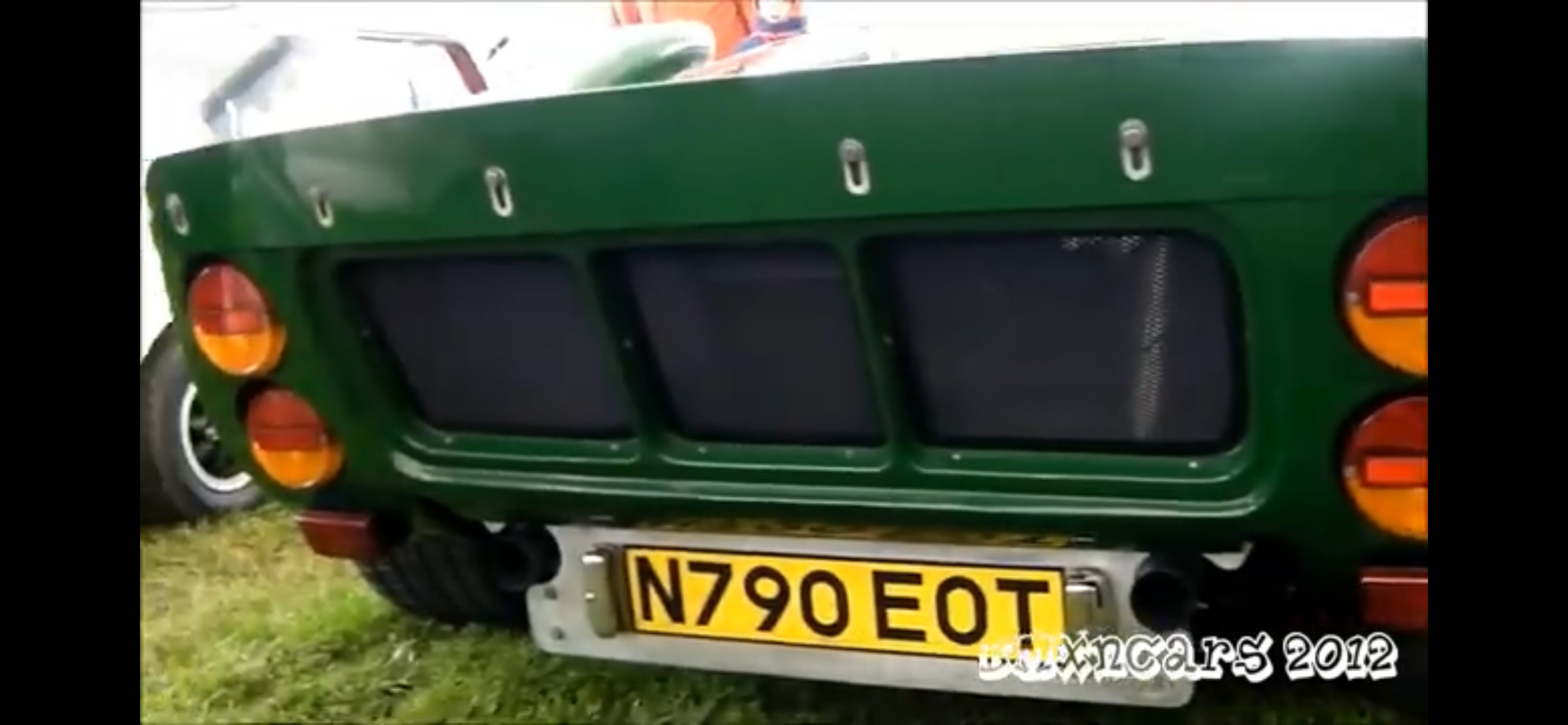

Rearscreen is GTD and not MK2 as is the rear valance.
GTD made about seven of those according to Lee Dawson early nineties. As I believe three lightweights where made.
They used sewer pipe as a template for the MK2 airscoop.
Vin number SABTVR03596177285 is a DVLA (UK) given vin for re-shelled cars. In this case probably a '71 Ford Cortina donor car
Engine number D20E is a 1972 302 V8 which is incorrect for a genuine GT40.
Rob Klein

The title is wrong, because it's not an real GT40 MKII

Hi Marco: I have pictures of a GTD MK2 - factory ``lightweight" from 1992. The car was up for sale around 2020 in the Netherlands. Hear a few of them.
Thanks a lot for sharing! She looks identical especially the interior. Only taillights are different. Do you know at which price it was sold?

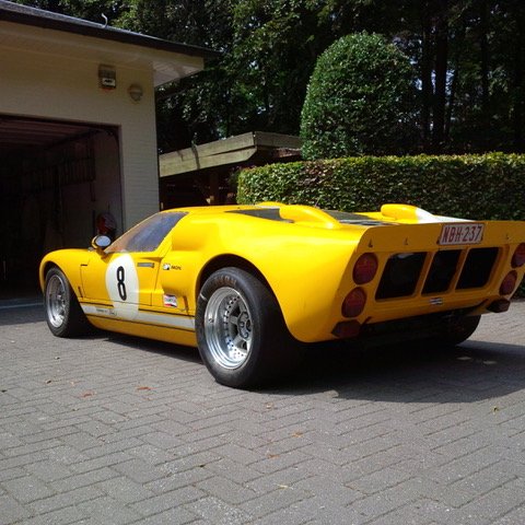

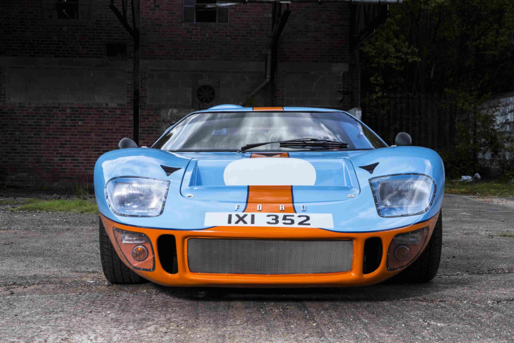

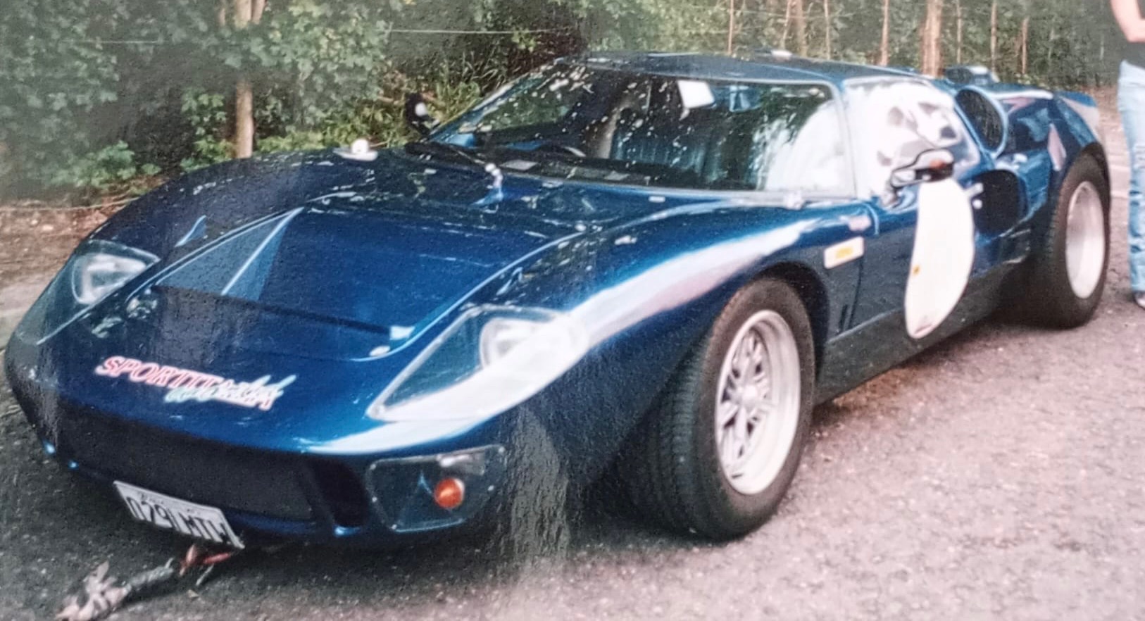

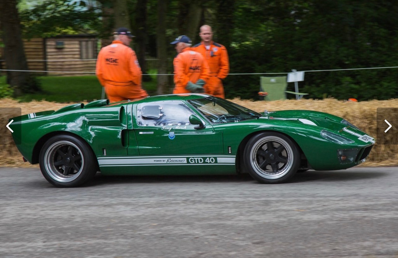

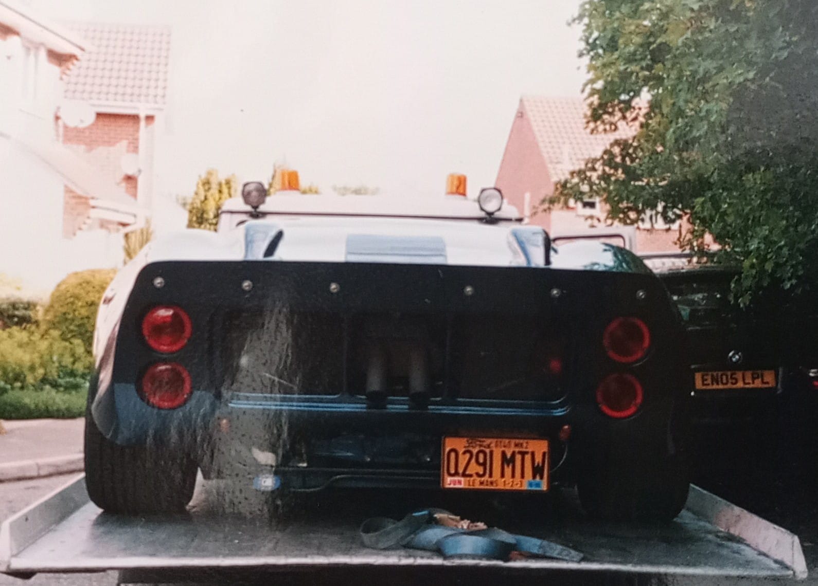

I tried to put all the GTD40 MK2 known by me together:
Factory lightweight from Holland
F5DE1F32-925E-475E-A26D-811F218FB3B5.jpegEDA3C000-82C3-442C-8B3A-7E894D0BCB80.jpegA325D72C-BC5A-4D12-8C83-CD7787FAF93B.jpeg
The car I am talking about in this topic
Gulf livery
B31DF470-A145-46D1-A356-1BF964BCB3E9.jpeg1DC1D52C-4C69-4E33-83B7-AFAE097EB516.jpeg42BAEE9B-5D04-4EAA-BEFA-2917C72565A7.jpeg6333449F-2C90-41C4-8F93-D55D35811803.jpeg

from the mounts near the steering rack, it looks like it is a tubular steel space frame in places. The interior looks to be clad in sheet aluminum. This would be consistent with most replica cars.
The original cars had a sheet metal monocoque chassis that is very different to what is shown here in its construction, even if the geometry and dimensions are similar.

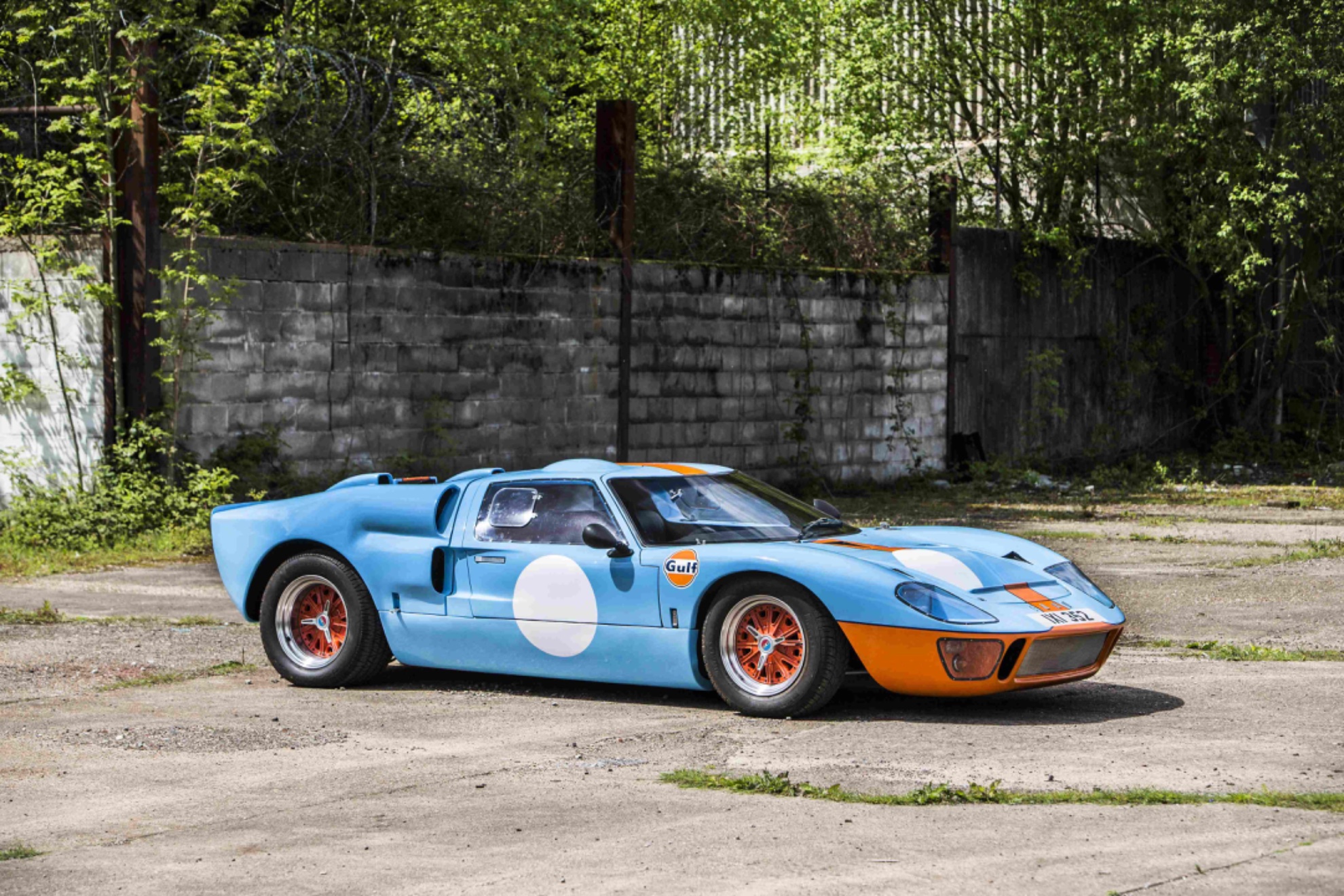

Thank you very much for your information. This car really fascinating me. But what do you think the real value is? While searching on the web I’ve found a 2020 auction of the yellow lightweight posted by Walter. It had almost the same kms registered on the one that is for sale now.
“ Estimated: € 85.000-95.000,- “
What is the real value of the GT40 I posted?

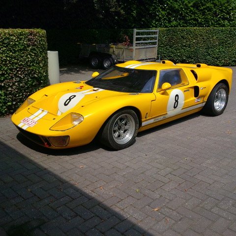

This car sold for 86K GBP some time ago;
Regardless of how you look at it, it will always be a spaceframe replica. It is a nice car with lots of potential though.
So honestly somewhere in the area 80-100K euro seems like a more realistic price given what others sell for, like the above SGT mk1.
