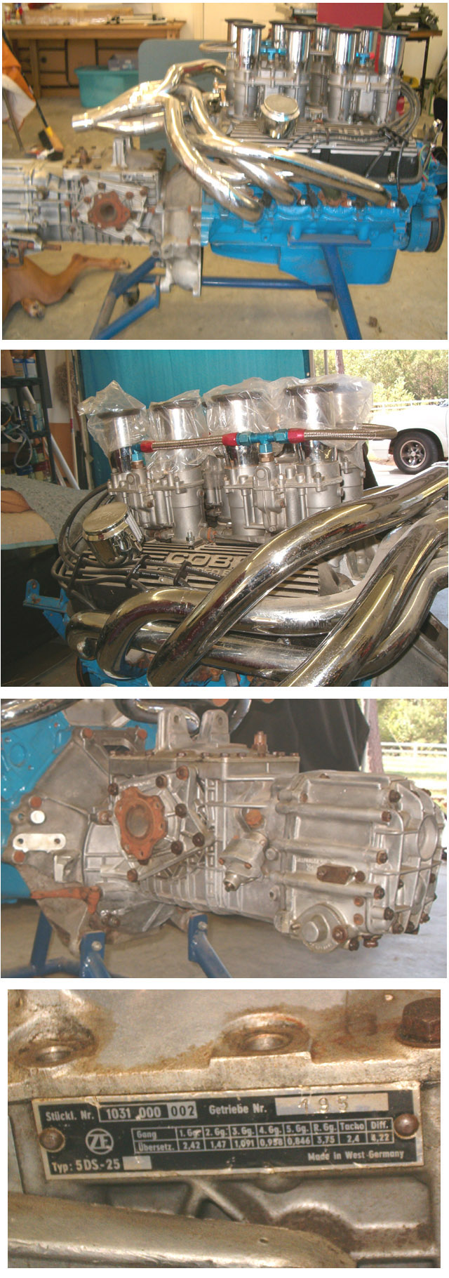

Here are a few photos of the engine/transaxle and a bit more history.
The engine was in a Lotus 40 (“a 30 with 10 more mistakes.”) owned by Kitchner Race Developments in England. He removed it and installed it in a Lotus 47GT which he then sold to a driver in the States, who wrecked it.
The car sat in a salvage yard (!) in Kansas City for three years. When I bought it in 1972, there was standing water in the cylinder bores, and pretty much everything that could rust and/or seize had. Sadly, the block was not salvageable according to the engine rebuilder. Keep in mind, this was in 1972, and who knew the engine or even the block had any potential worth as a vintage motor back then? In retrospect, I should have hung on to it, but being young, and poor, and in a hurry, I didn’t.
Fortunately, the Webers cleaned up, and the ZF was unharmed, so the builder blueprinted a 289 block he had laying around and we put it back together. It’s not been run since the rebuild, but I don’t think it has value for a “numbers matching” level restoration. My intention was to get the 47 restored and keep the motor with it. That car can be seen at http://home.swbell.net/toy264/

Yes, they're blocked off and the fuel line connects where the filter element would normally be. Never could figure why that modification was made.
And I've learned since this was posted that the engine more probably came from a F 5000 car rather than a Lotus 40.
