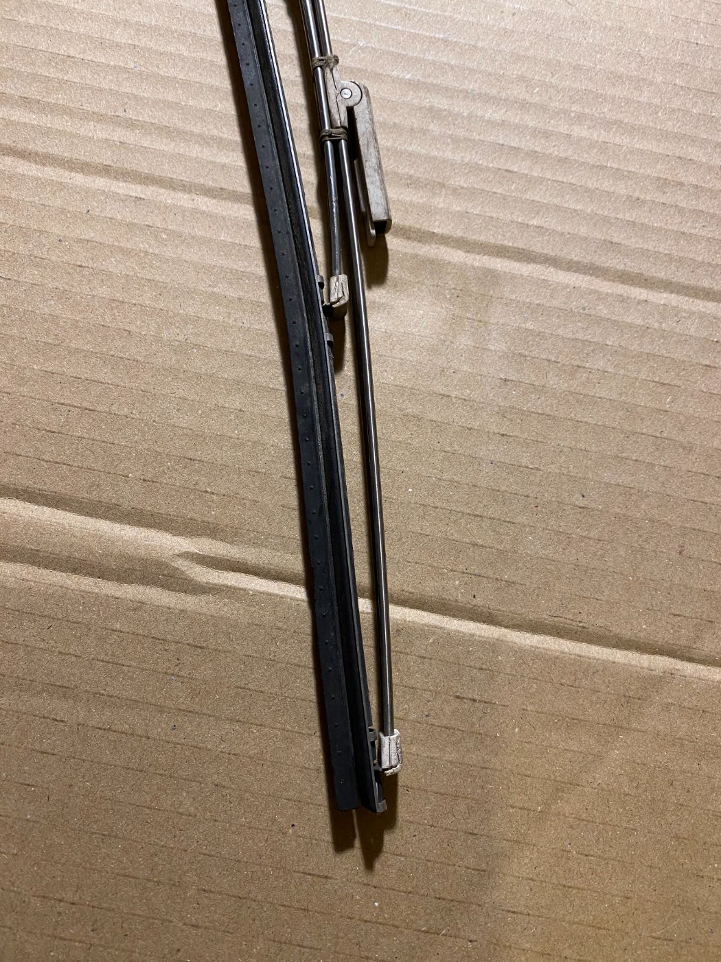

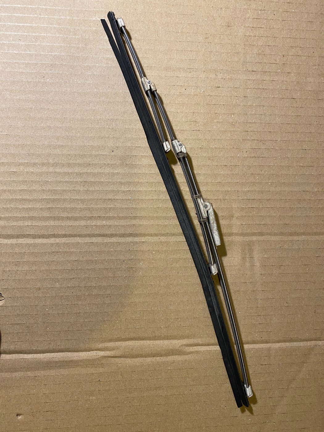

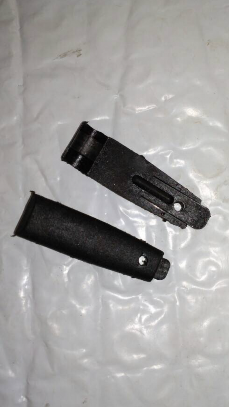

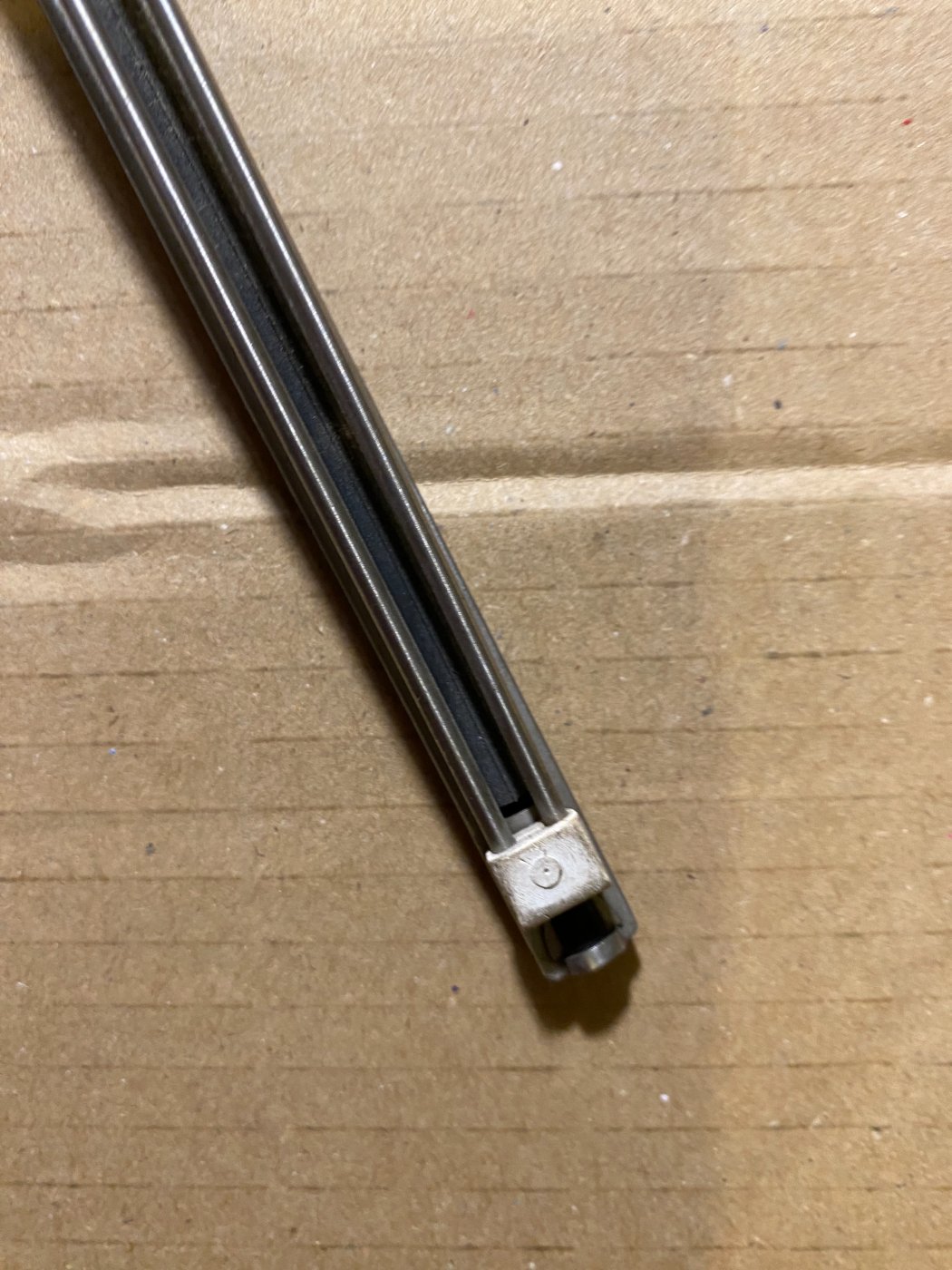

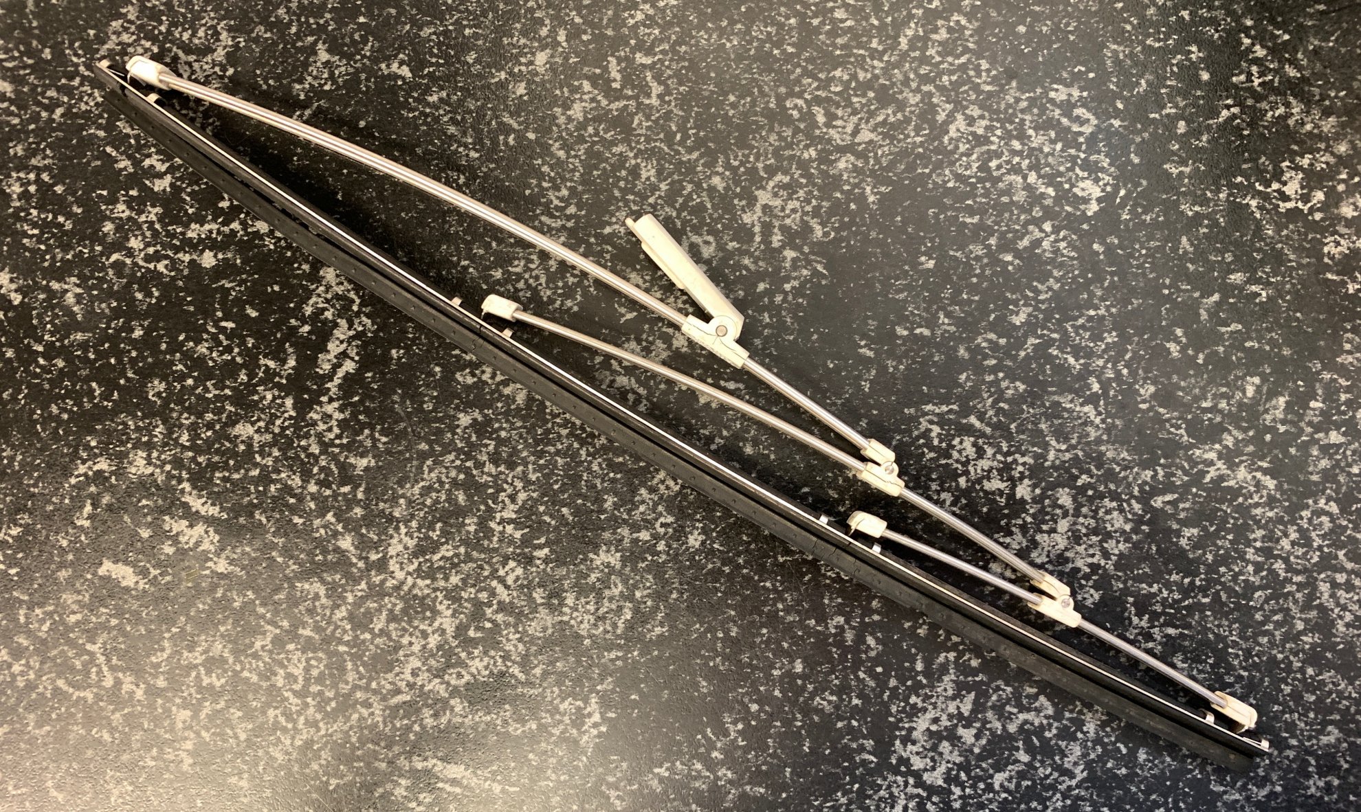

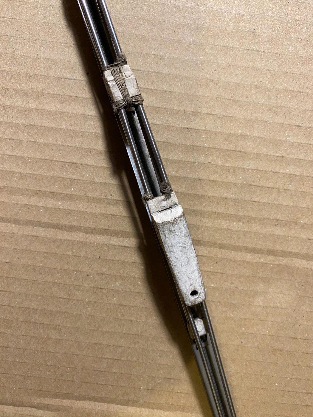

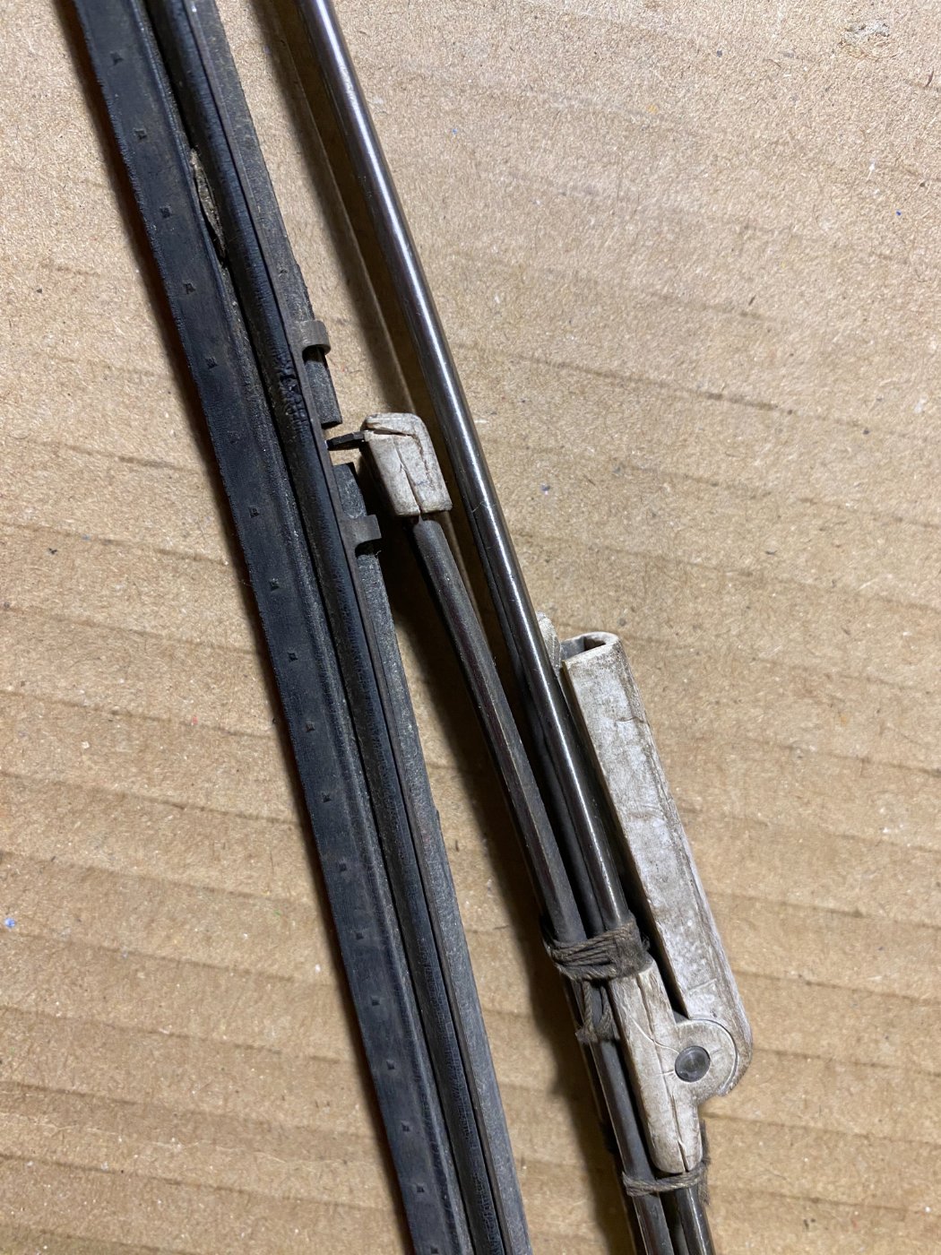

Can anyone help me with the original Trico wiper blade as in the photos.
Are reproductions available ?
Or does anyone have one which I could loan to make one ?
Thanks, Peter

I offered US$3k for a NOS one 2 years ago but the guy wasn’t interested.
My restored original blade is presently sitting on an original concourse street car and the owner wants to buy it for similar money but I need it myself .

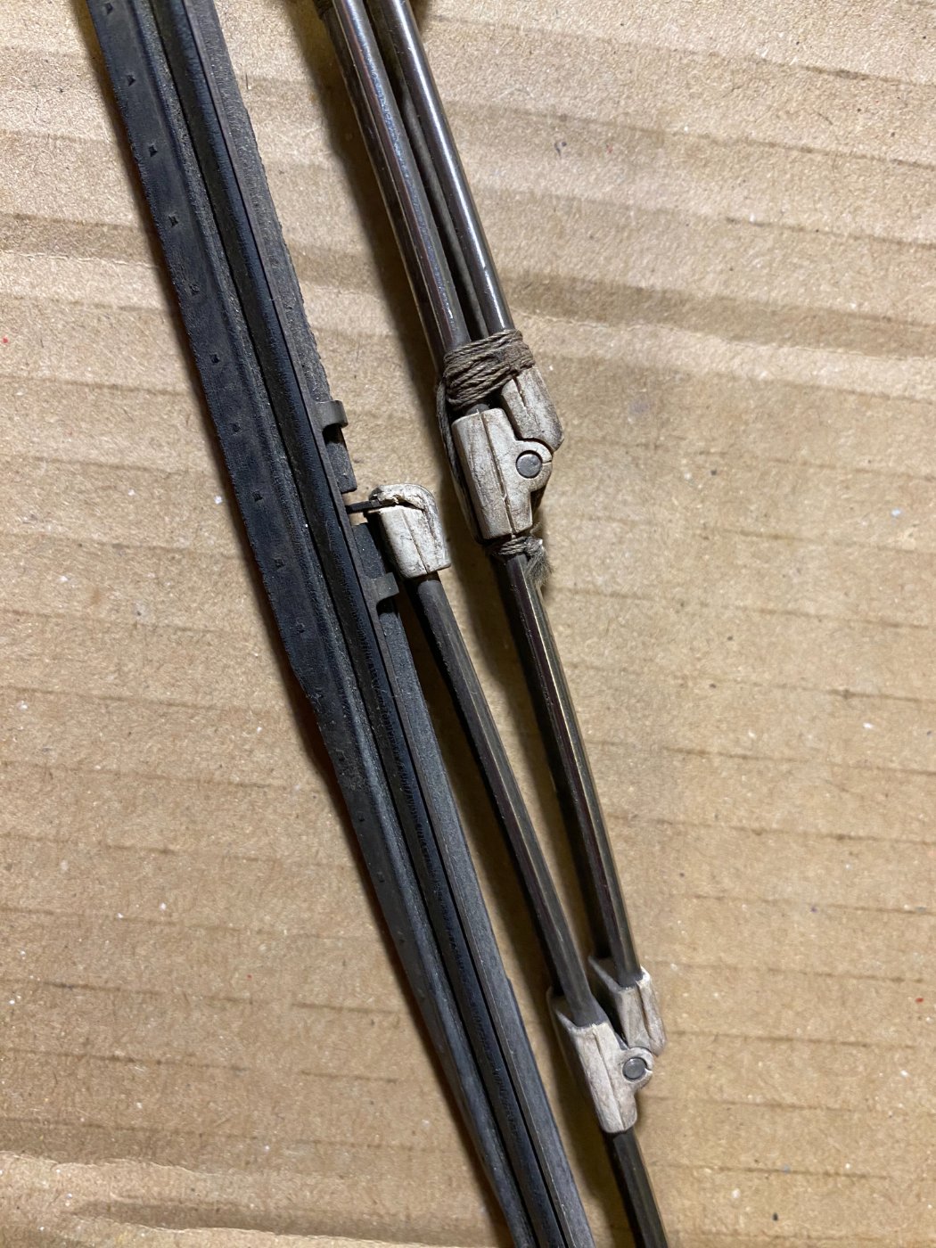

There’s 7 injection moulding tools needed for all the different plastic pieces. No one is crazy enough to remanufacture them correctly yet. The plastic pieces are too thin and fragile to 3D print.
The rubber blades are also special and need remanufacturing with the correct pattern & markings.

We had a meeting this week and we have decided to make a few functional spares of these.
Hi James,
I recall you saying you might make copies and that you would use Aluminium for fittings. I have been giving some thought to making myself, but using white nylon , machining from solid.

I take it that you have loaned an original then ?
Hi James.
No , I have not yet been able to measure an original.
At this stage I am basing my trials on the Speed blade and guesstimating dimensions, the wire size being 3/32" diam.
