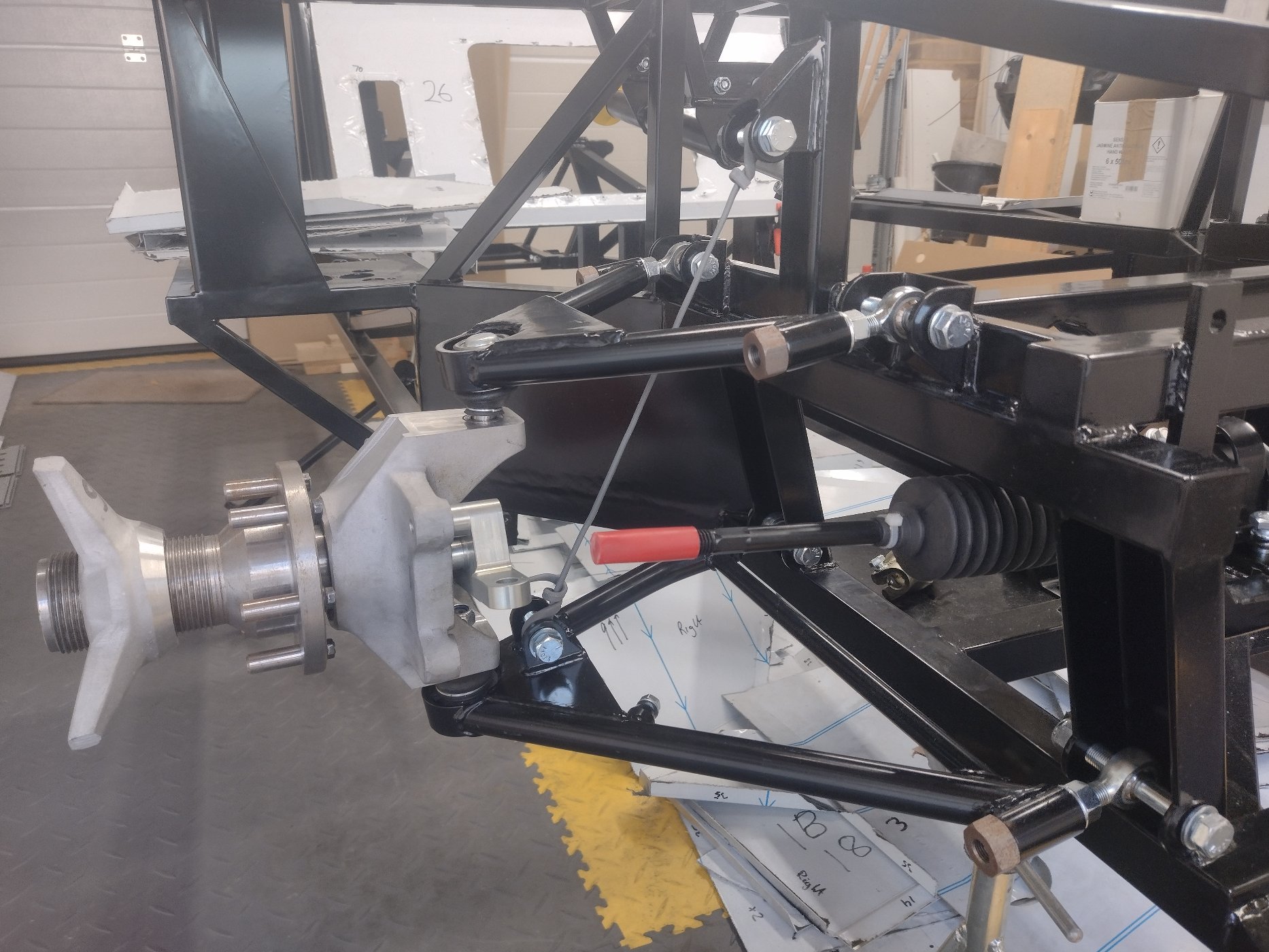

Suspension - wishbones, uprights, steering rack, roll bars front and rear.
The bolts for the suspension did not fit through the mounting holes in the chassis, probably because of the powder coating, so I had to take a bit off. I only had an old, corded power drill with "high" or "low" setting and this was far too aggressive for a large drill bit (1/2 inch), so also bought a cordless drill and some new drill bits. I think I took a little bit more off than just the powder coating, but the bolts are a snug fit with no play.
AK Sportscars originally offered AVO springs/dampers but I believe they went out of business so had to tie a bit of cable to hold the wishbones up.

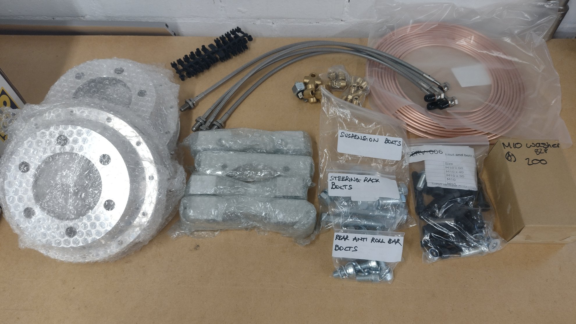

Brakes - Discs, pads, bells, calipers, brake lines, flexible hoses
Hand-brake calipers
Pedal box, reservoirs

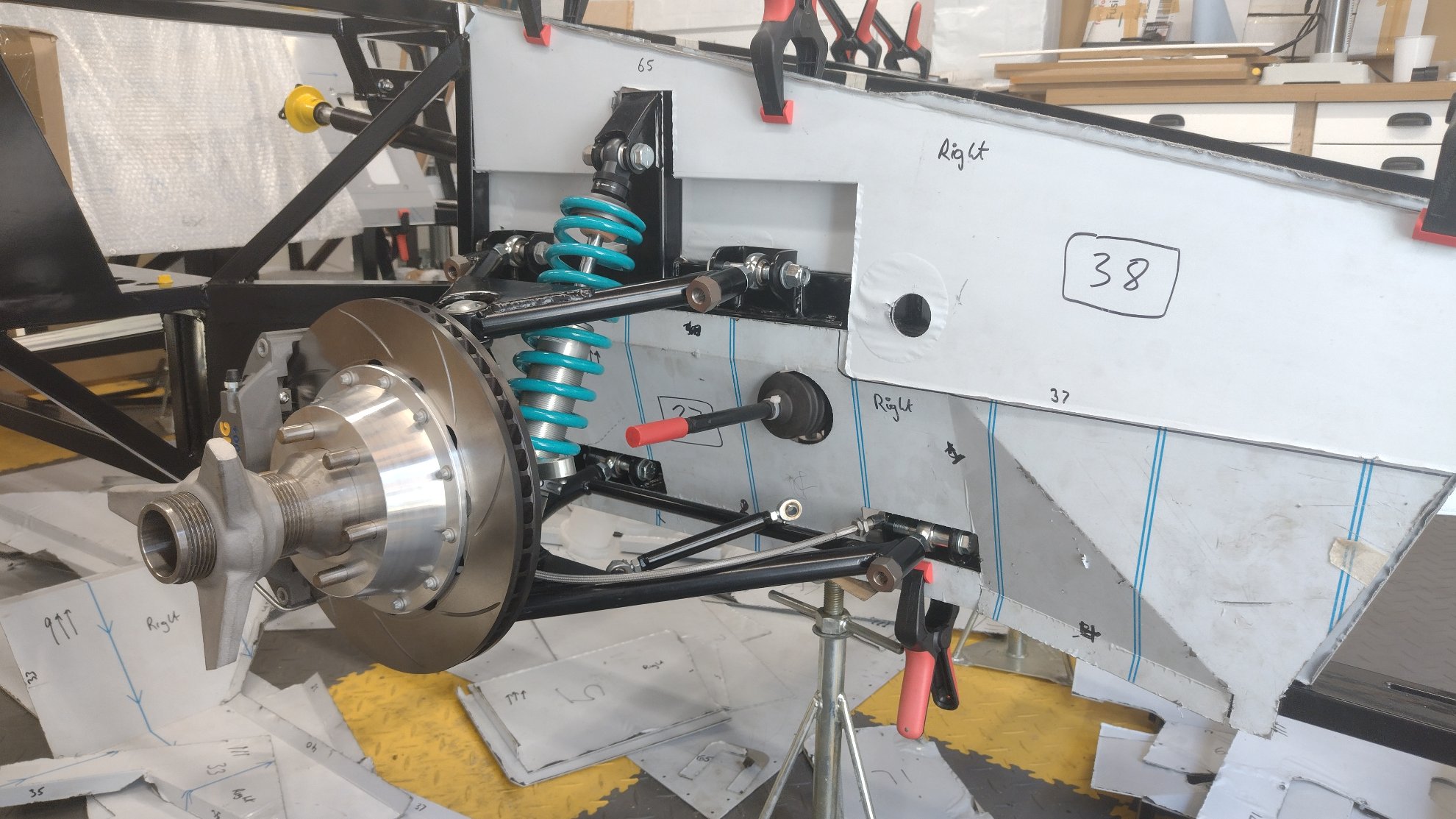

Nitron springs and shocks all round.
I spent some time bolting the discs to the bells using the supplied nut and bolt kit, but needed an E8 socket for the bolt heads. I also loosely fitted the calipers to the uprights - I know this is going to cause trouble in future. I can't see a way of changing brakes pads without removing the caliper, which of course has split washers to prevent the bolts coming undone.
For the springs / shocks, some of the mounting points on the chassis or wishbones needed opening, and one bush needed turning down otherwise I would need to cut the mounting point off and weld in a new, wider one.
Eventually, with the suspension on all round and a few panels mocked up, it is starting to look like the chassis of a car, and not just a bunch of metal tubes - great motivation.

Powder coaters usually offer an option to mask holes to prevent your problem.

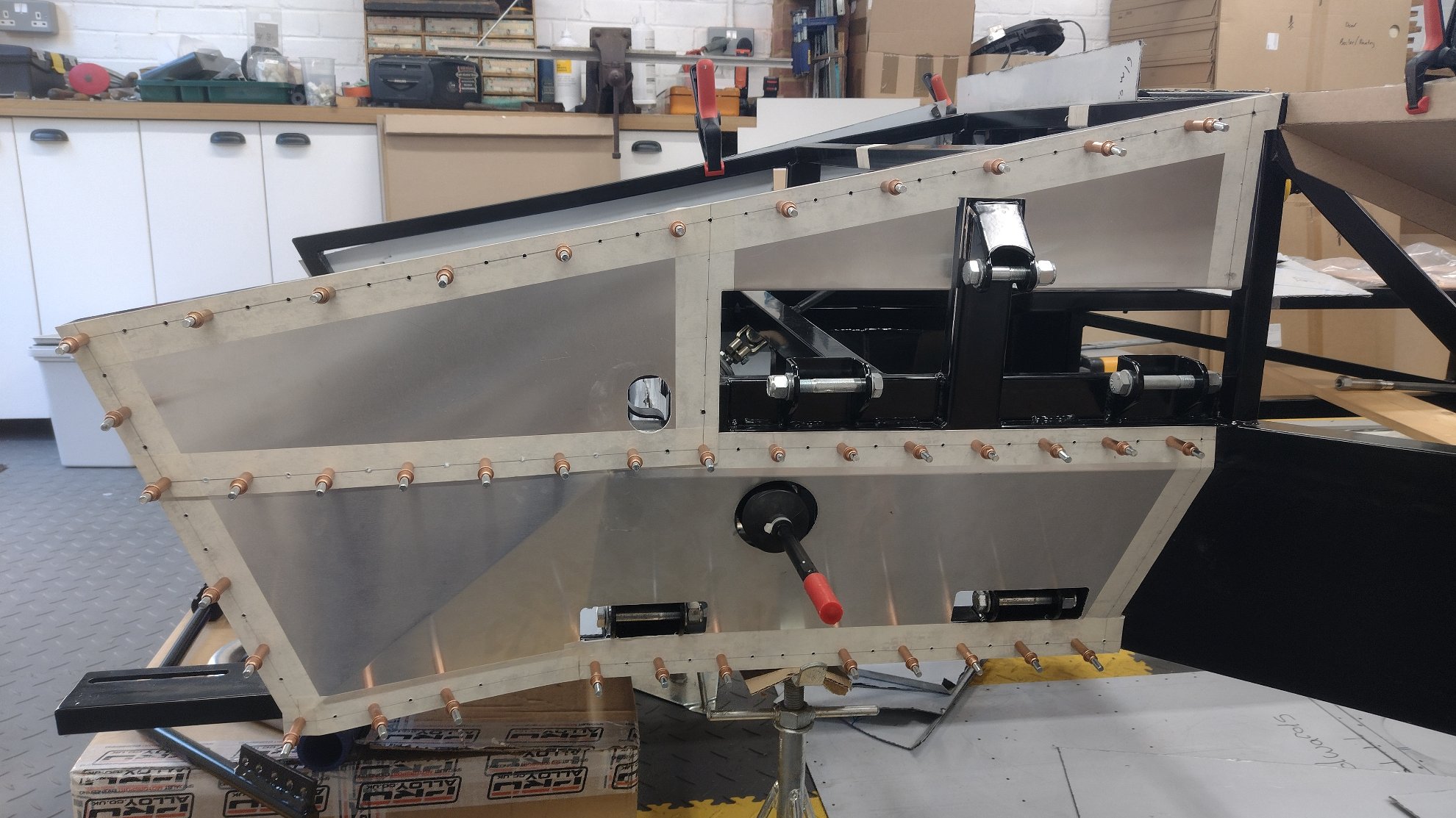

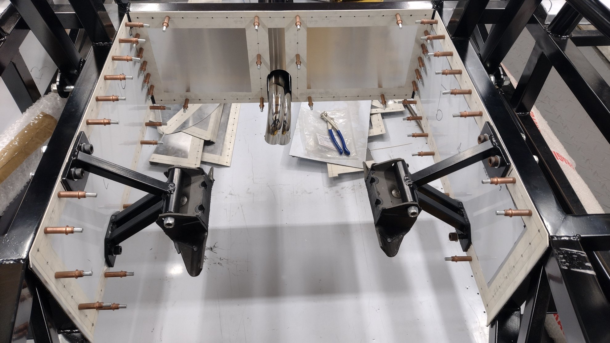

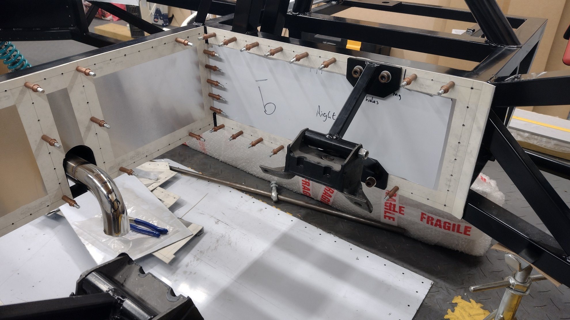

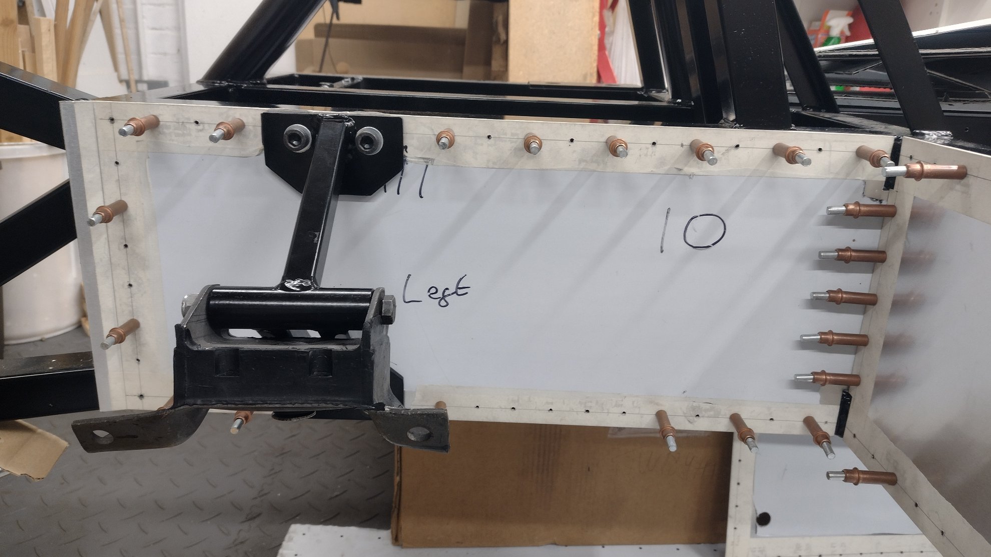

With some time off over the Christmas and New Year, I have made some more progress fitting panels in the engine bay - lower rear bulk head and the side panels.
The side panels needed clearance holes for the engine mounting brackets. I just need to do a bit of de-burring on some holes and then these can can back off so I can reuse the clecos, and will no doubt need drilling for fuel lines, electrics etc. when I come to that stage.

I am surprise by the dimension of the engine brackets, for 302 bloc the seem to leave a lot of space between the engine and the side walls ?
Have you tried a dummy assembly with the 302 block ?
my AK brackets were way way off using the supplied holes in the chassis...
Jerry
Jerry
Agreed.
The holes in my chassis for the engine mounts were also way out. This is because they are positioned for use with a 302 and a UN1. As you are using a Quaife transmission, you may need to move the hole (engine mount) position forward.

I am going to install a Ford 302 small-block (F1SE, 1991) with Quaife gearbox. The engine block is still on the stand and I do not have an engine crane at the moment so cannot dry fit. I measured across the mounting holes in the block and it is approx. 33cm across centres. I then measured across the mounts in the car and came to the same value (all a little bit by eye, but "close enough" that it appears to be right). I have no clue how well the enigne fits fore/aft as I do not have the gearbox or all the gear the will fit on the front of the engine.
Does anyone have nominal measurements for a naked block with reference to chassis rails?

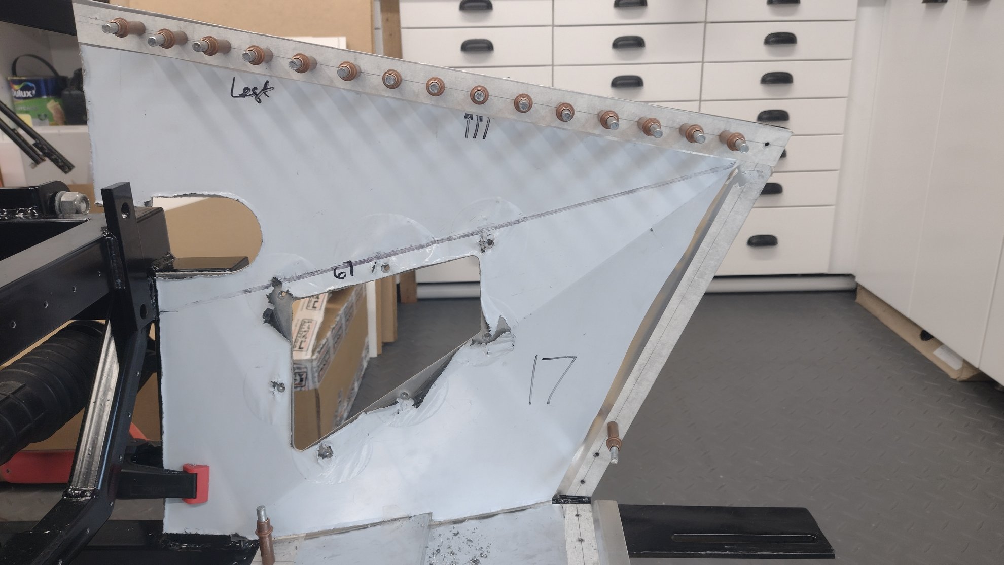

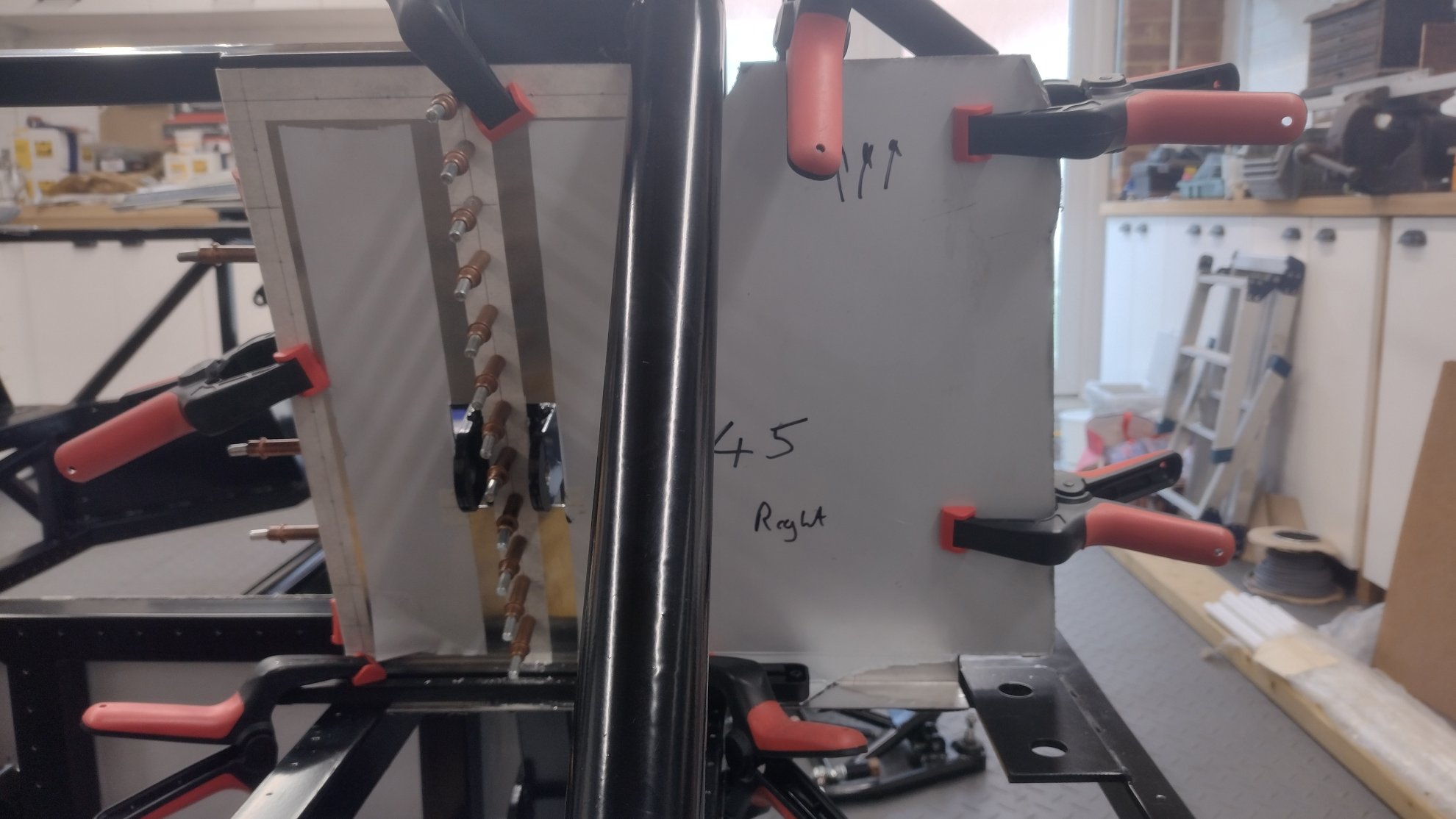

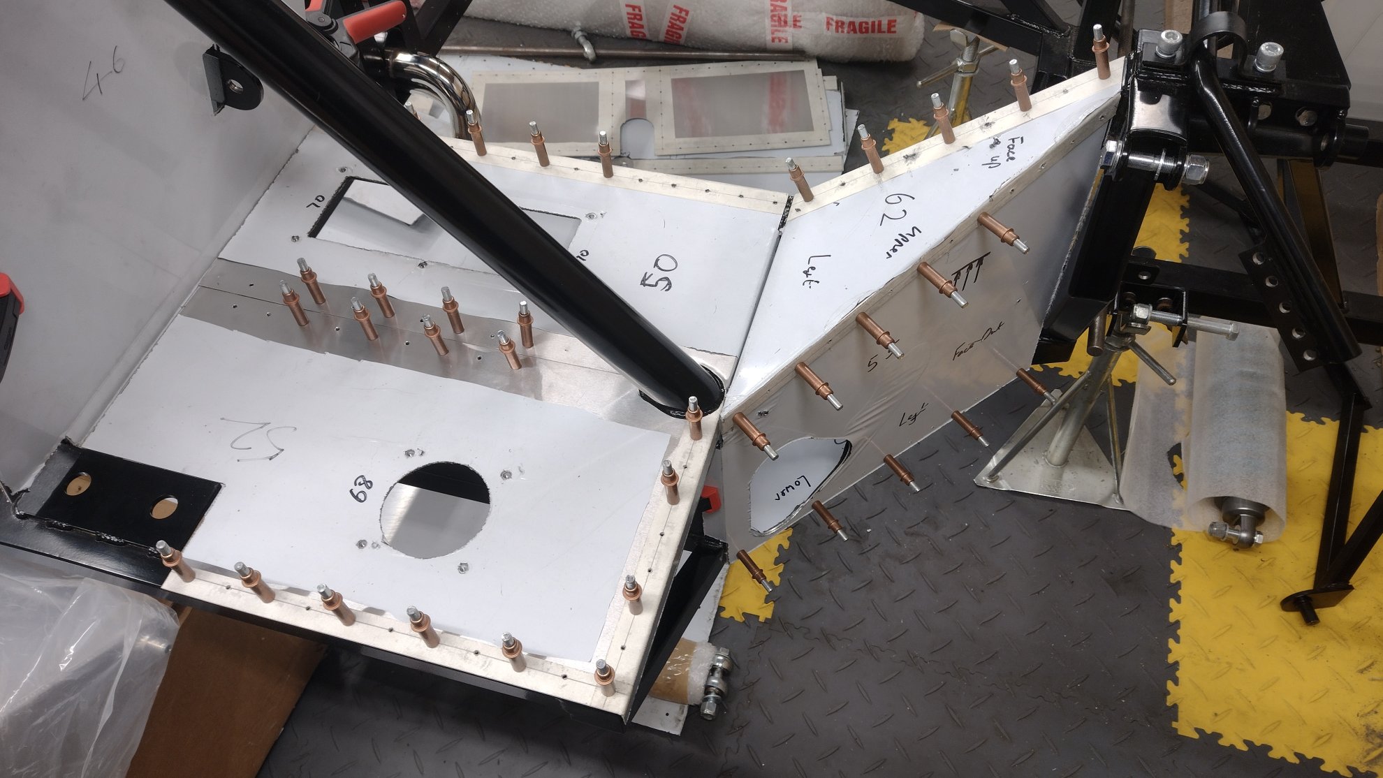

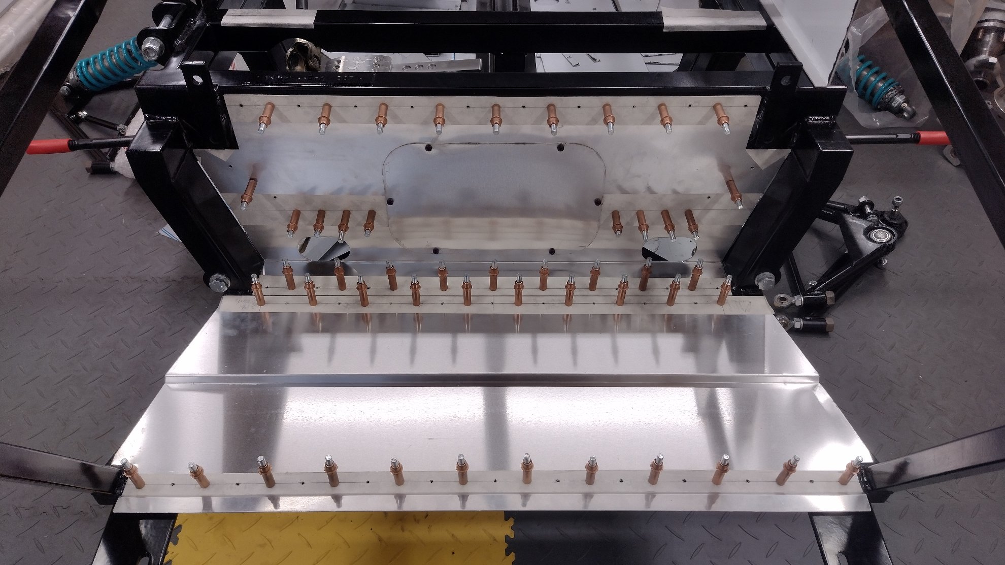

I have been slowly continuing fitting panels to the chassis - roughly one per week(end), so here is 5 weeks work!

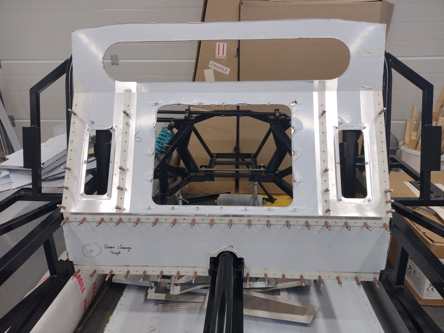

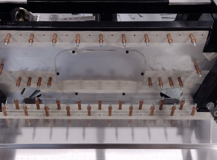

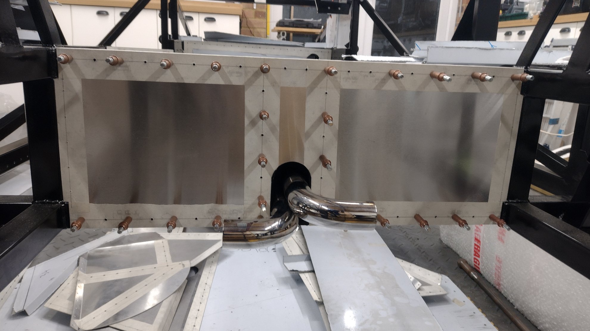

Another milestone piece - upper rear bulkhead panel. I decided to fit the upper panel over the top of the lower panel so there was a softer edge for when I fit carpet across the whole piece.
I started by lining up the lower edge of the bottom panel with the bottom edge of the lower rail and drilling the bottom row of holes. Then I lined up the upper panel and drilled the vertical holes. Finally put the two together and drilled through both panels and into the chassis for the middle row.

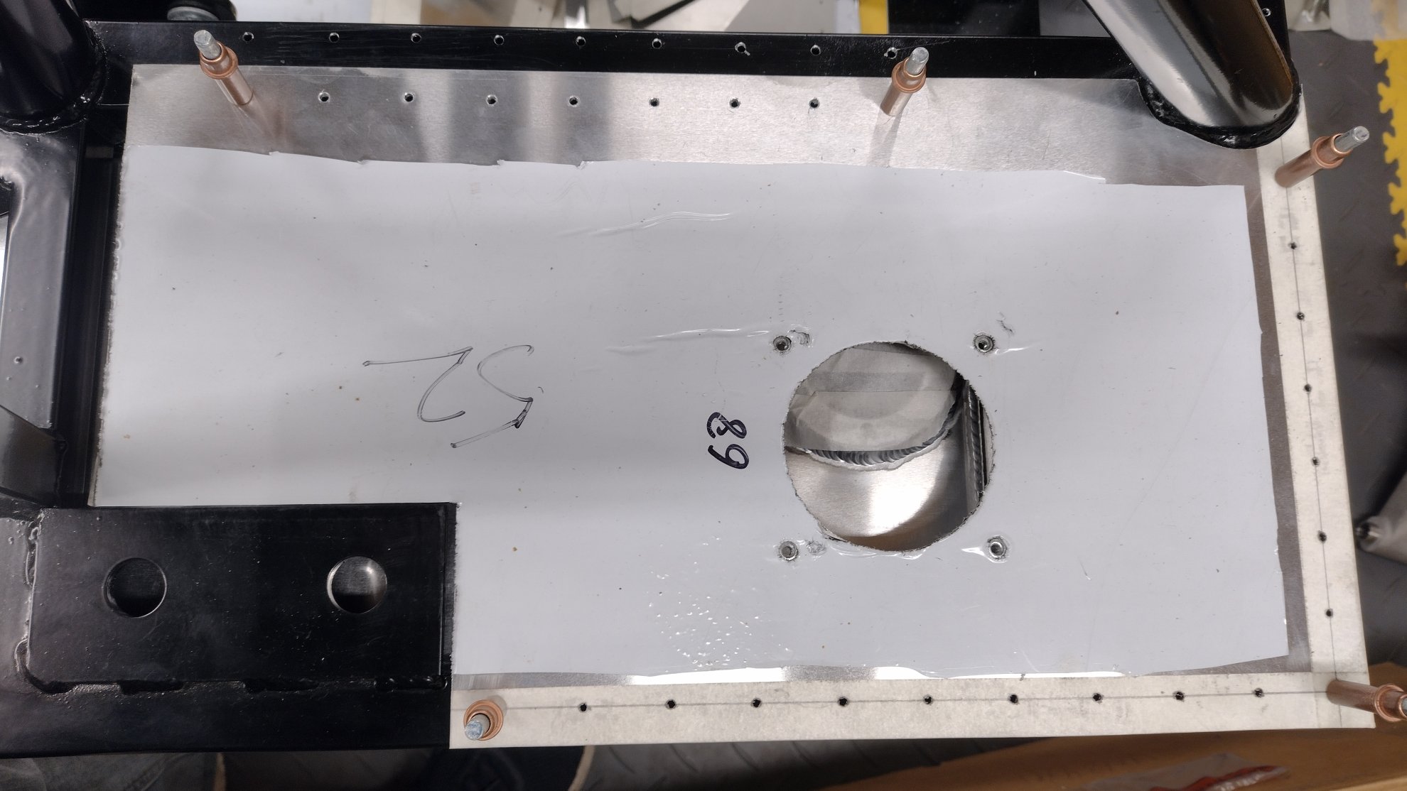

Also drilled the brackets for both fuel tanks, and ordered some 3/8" UNF Nyloc nuts (once I worked out the thread size). The breather pipe is very close to the inner bolt so will have to make some decisions when it all needs tightening up.
Was I naïve to think these would line up? It appears the measurements from the left and right hand edge have been swapped - either for the panel or the fuel tank. I will probably make a larger opening with cover plate anyway. How often will I need to pull the fuel tank float through this hole?

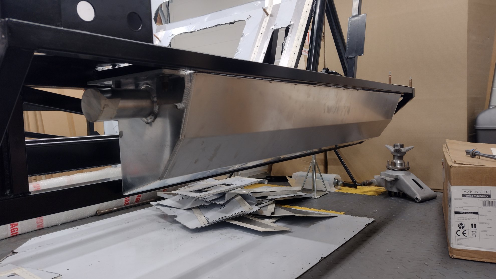

Everyone's favourite panel! There is just enough flex to be able to fit this panel without splitting or elongating any cutouts.

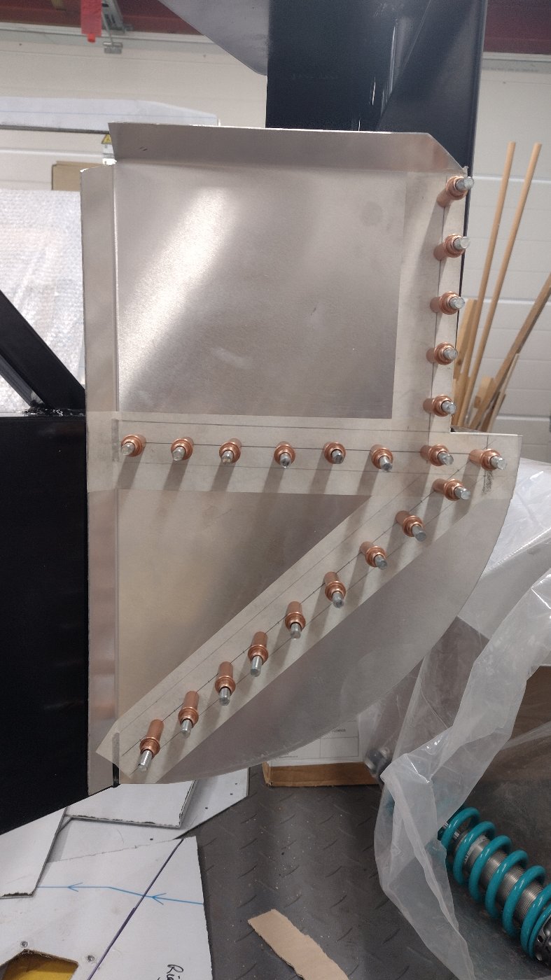

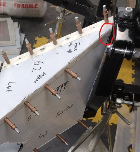

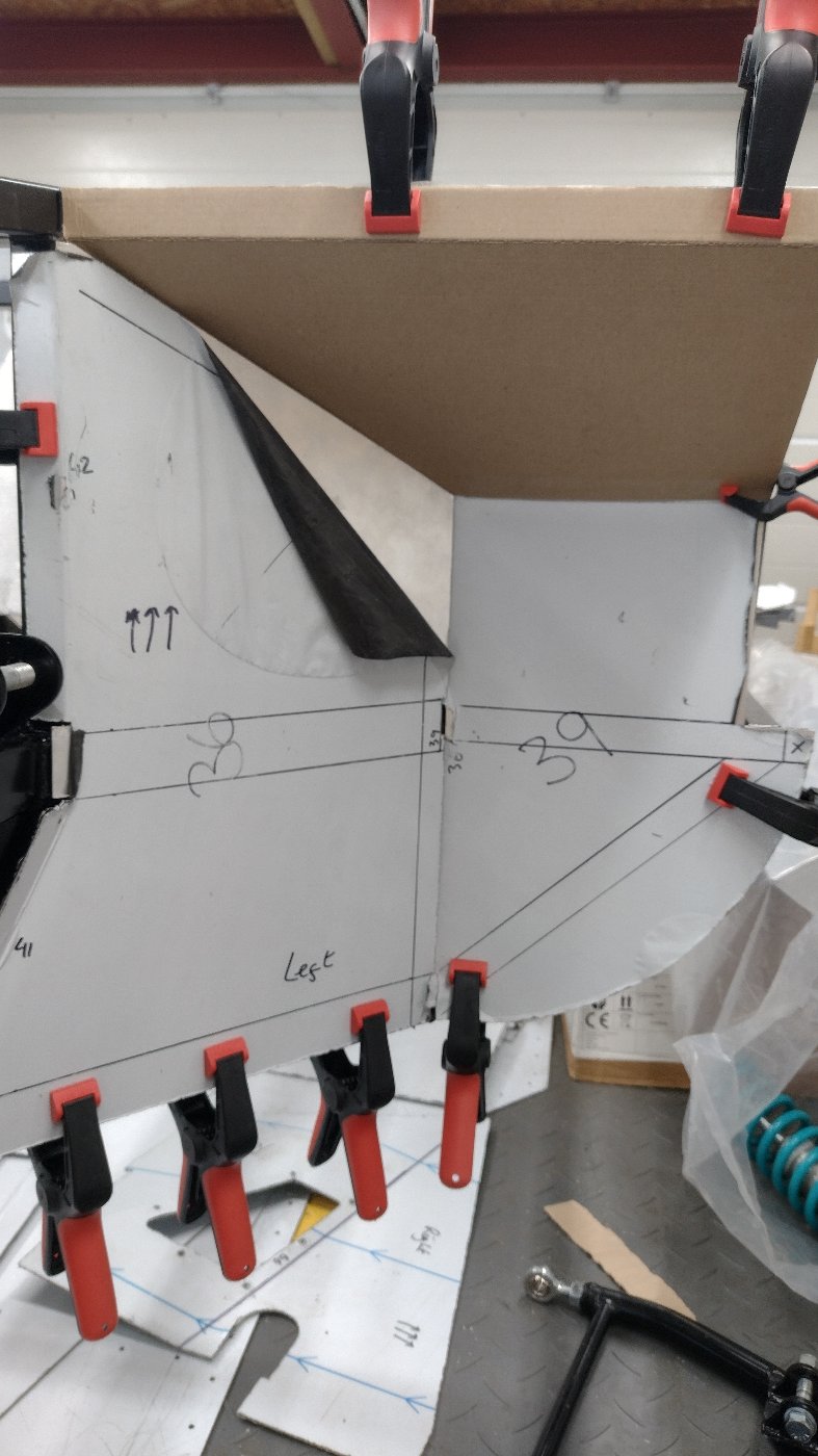

Lastly, working back at the front on these inner panels. Because of the angle inwards as the panel moves rearwards, I have added a fold 1" from the leading edge so the front edge of the panel lies flush with the vertical rail and the rivets can sit flat.

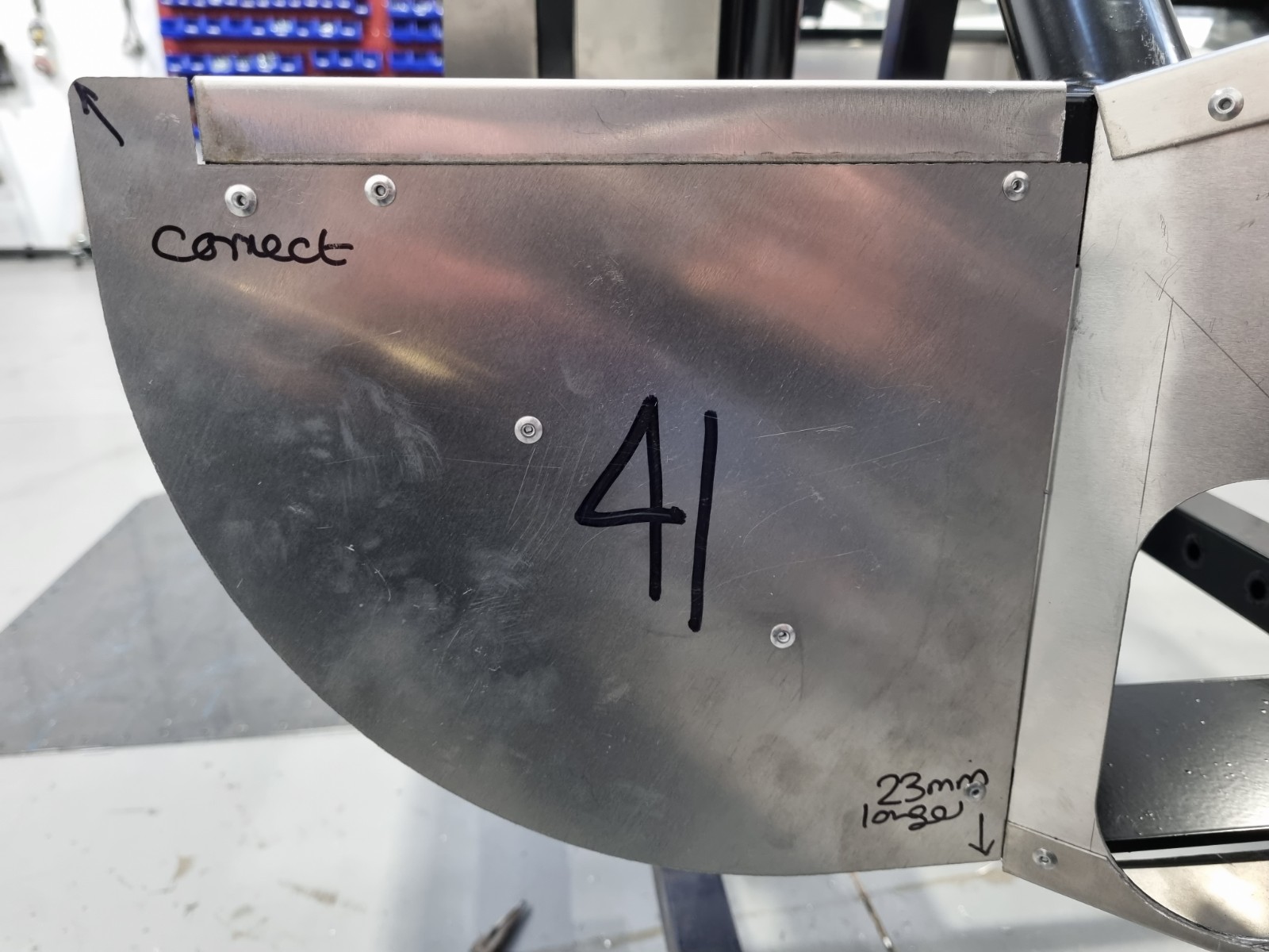

Hi Phil, looking good, it's really interesting to see that your panels seem to be slightly different to mine (even the numbering looks different) for instance your panel 53 folds back into into the chassis whereas mine folds forward to line up with the panel next to it ...
Have you taken into account that this panel is supposed to go 23mm lower than the chassis, looking at the picture from the build manual the bottom of the panels you've put in are supposed to line up with it (or at least that way my assumption)
Also I see you've made the same mistake as me as there is no way to fit a rivet here as I couldn't get the rivet tool in here :( actually unless you're going to rivet this first before attaching to the car?
