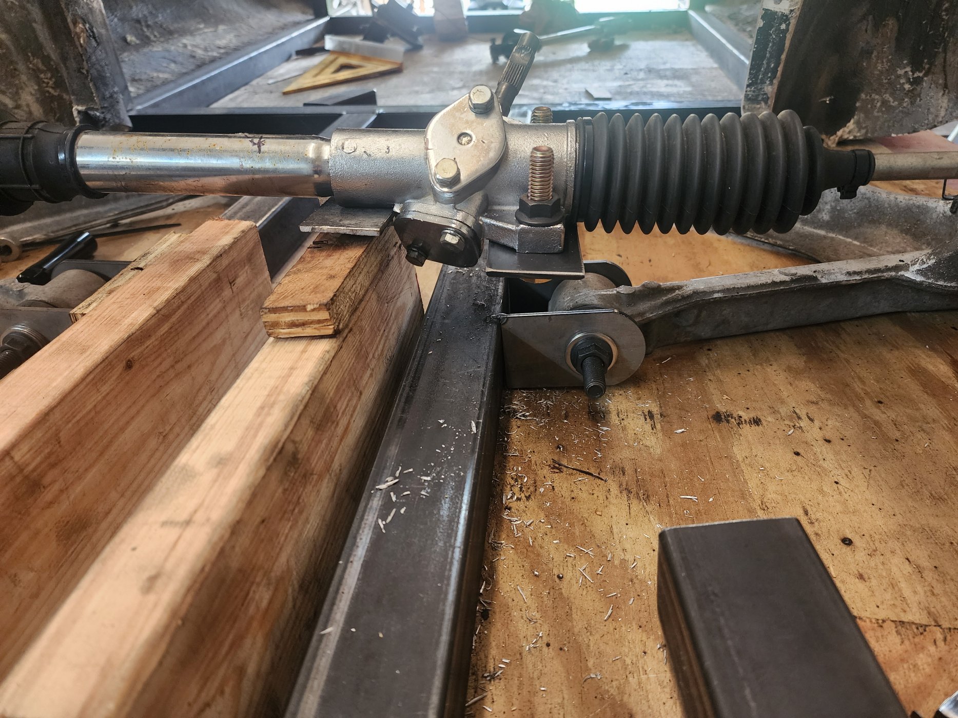

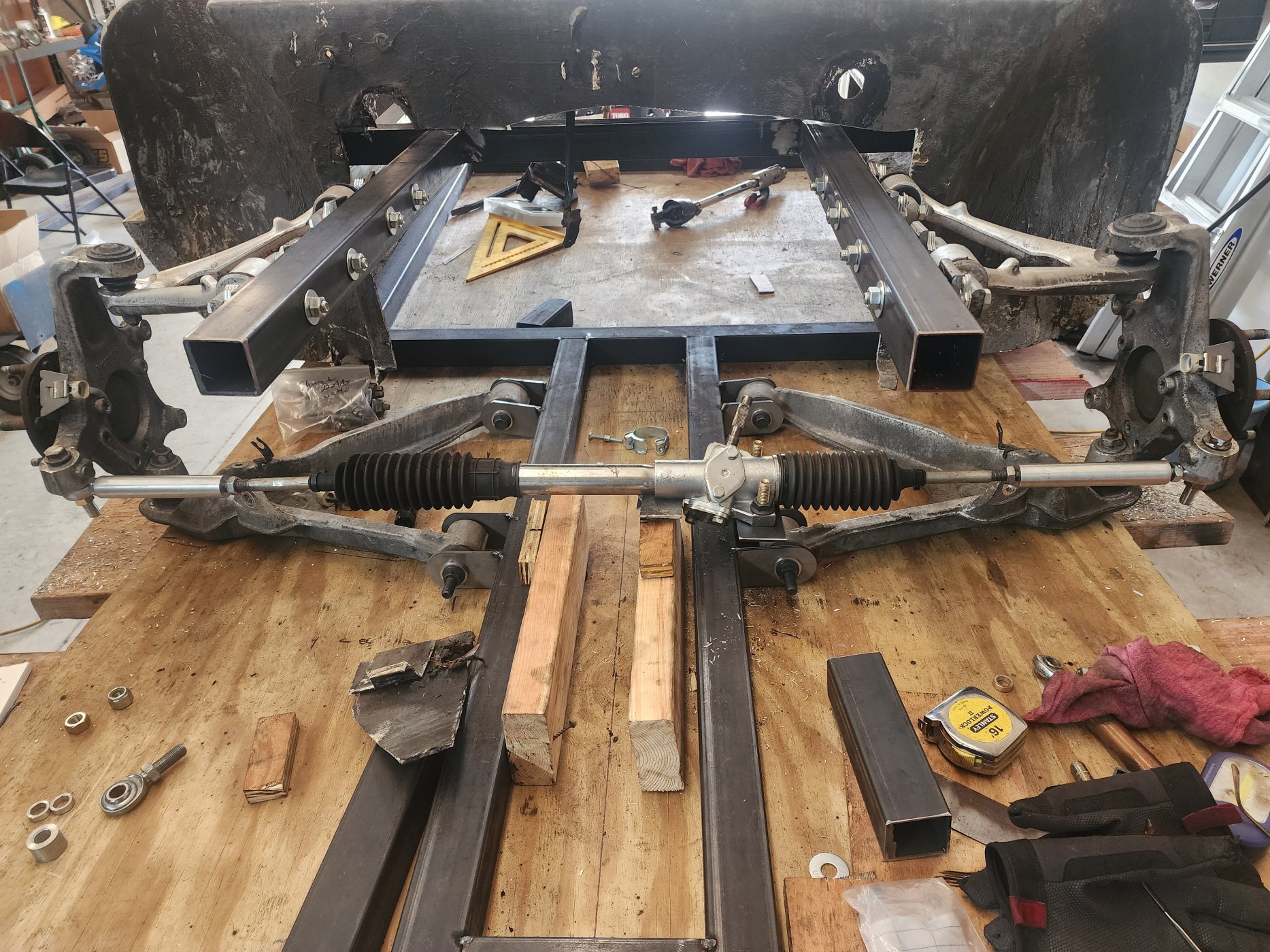

Hi folks can anyone building their own chassis look at these pics and make suggestions for how to proceed with mounts for this rack?
Hi folks can anyone building their own chassis look at these pics and make suggestions for how to proceed with mounts for this rack? View attachment 152854View attachment 152855

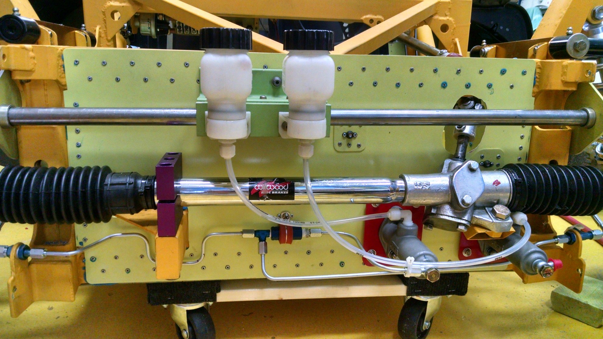

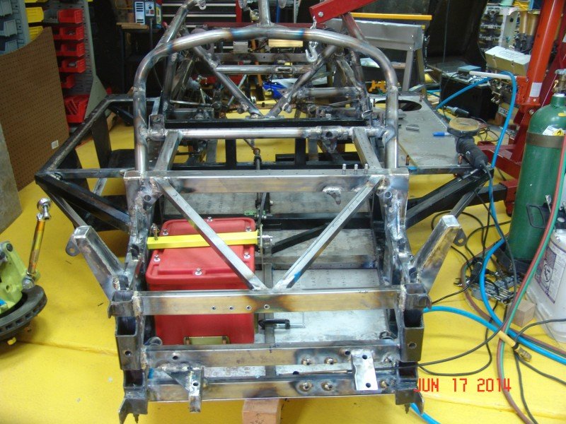

Your steering rack looks similar to mine, but the chassis mount is a bit different on the right side, as my car is not a GT40. here are a couple of pictures of how I mounted the rack, The purple mounting is a split bushing, The rack needs to be mounted solidly, as the forces on it are high.

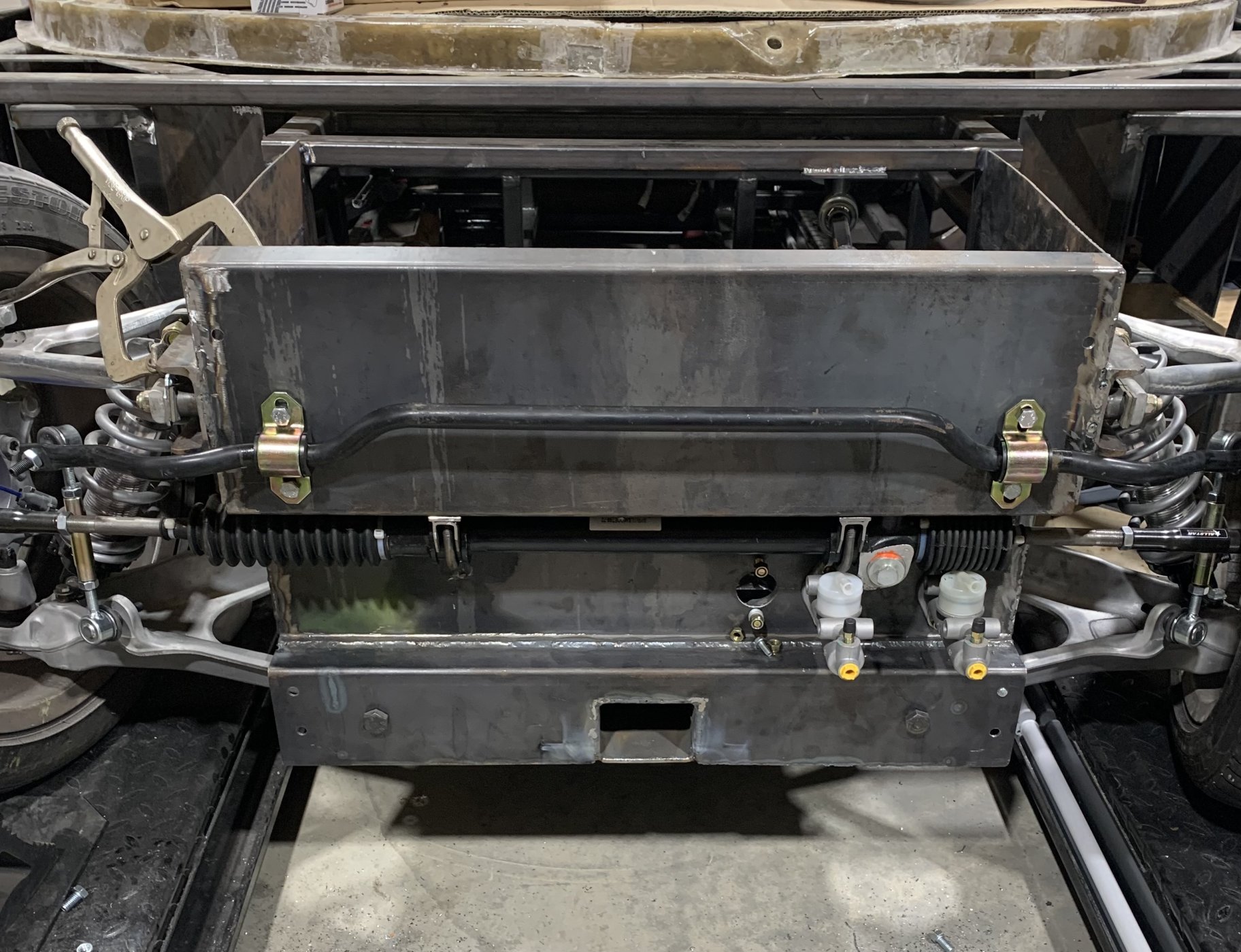

Make a short firewall between your upper suspension supports to mount the rack and other future systems and it will add to chassis strength. BTW, I made my tie rod end links adjustable in height to account for bump steer but can also shim the rack itself.
