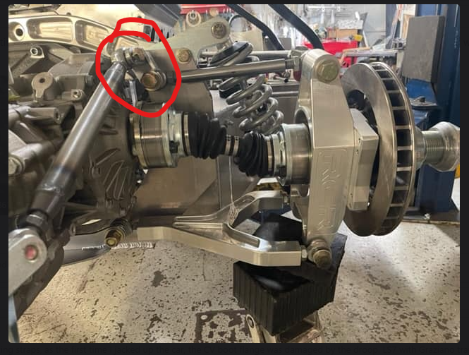

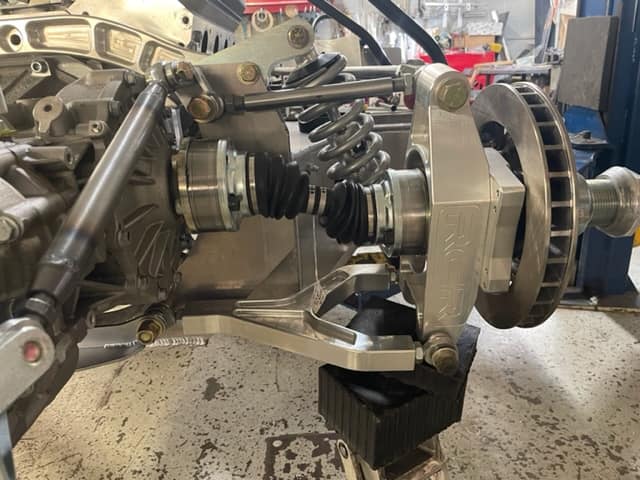

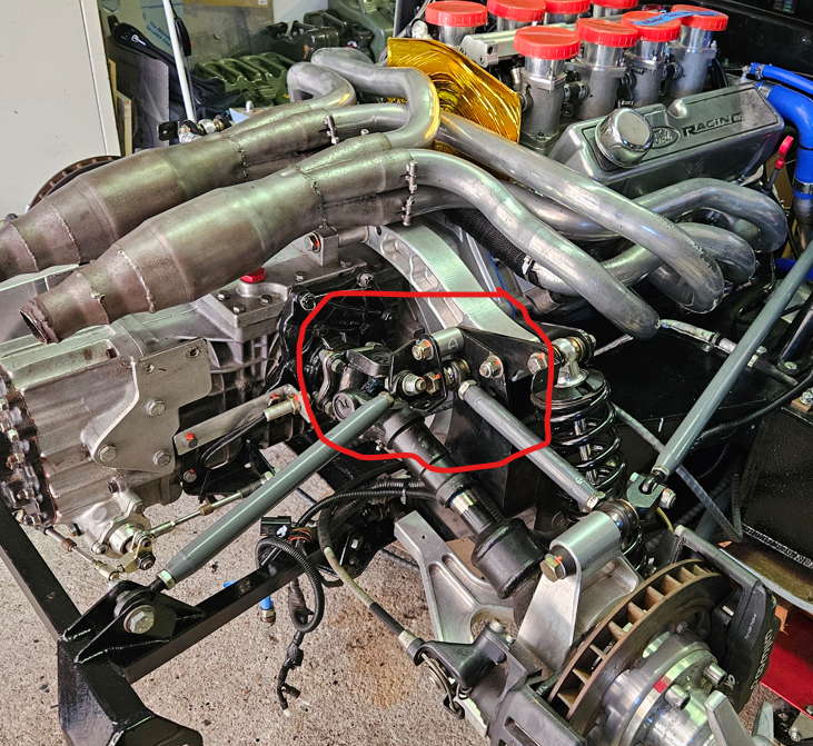

The rear droop on my car is limited by the lower four link rod at the chassis opening. I have not checked to see if the axle will further limit the droop before the rod hits the chassis. In either case, I will fold a thick piece of thick rubber over the opening and bolt in place to limit the travel to just above the axle limited droop.

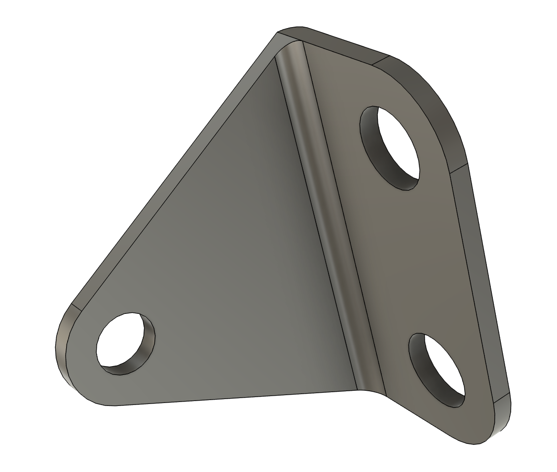

The bracket provided by RCR to fasten the rod end that supports the rear clam is designed for easy manufacture, but is not ideal for providing clearance for the axle shafts. I made brackets from a short length of 2" x 2" x 1/8" steel angle stock much like Jean-Marc's picture. I also made smaller diameter rods and used the smaller rod ends on both ends.
