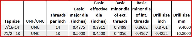

Recently at a car club meeting the discussion arose about drilling and re-tapping the 302 head bolts to 1/2 inch.
I had never headed down that track before so I had a look at the possibilities
It looks feasible .
Maybe you could get better tension (better sealing) as in 351W
Has anyone done this ???
I have attached the sizes for information.
It sounds like a good idea and there is only one TPI difference between them so maybe it would work ???
Appreciate any comments
regards kevin B
Yep, it works, preferably only on the blind hole blocks though ( & you need to drill the holes slightly deeper ), have seen a couple of the later roller cam blocks that have been done, but thats just a waste of time since the main bearing bolt thread boss's in the webs on those have no meat around them. Not much point in saving the head gasket if the cranks gonna end up in the pan.
Also you can drill the 351 blocks to take the 385 series ( 429/460 ) 9/16" hardware if your keen, but for NA stuff thats a bit over the top...
