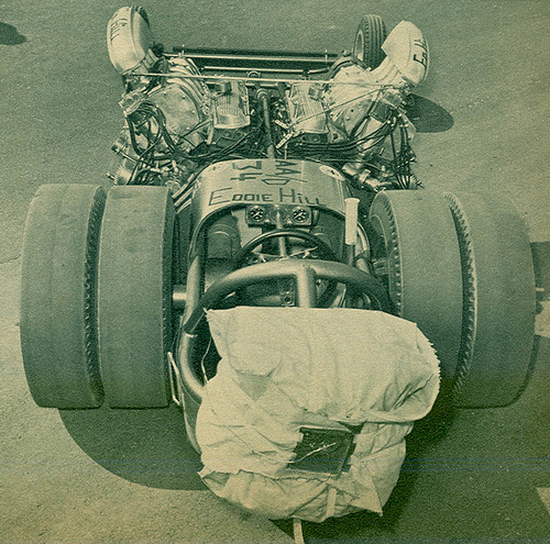

Dean, Thanks for the write-up, it was like being there. I've got a trailer on my xmas wish list, so maybe i can join you. Wasn't Eddie Hill the first to put 2 side by side V8's on a dragster? He brings that Ariel up to eagles canyon and is a pain in the side.
