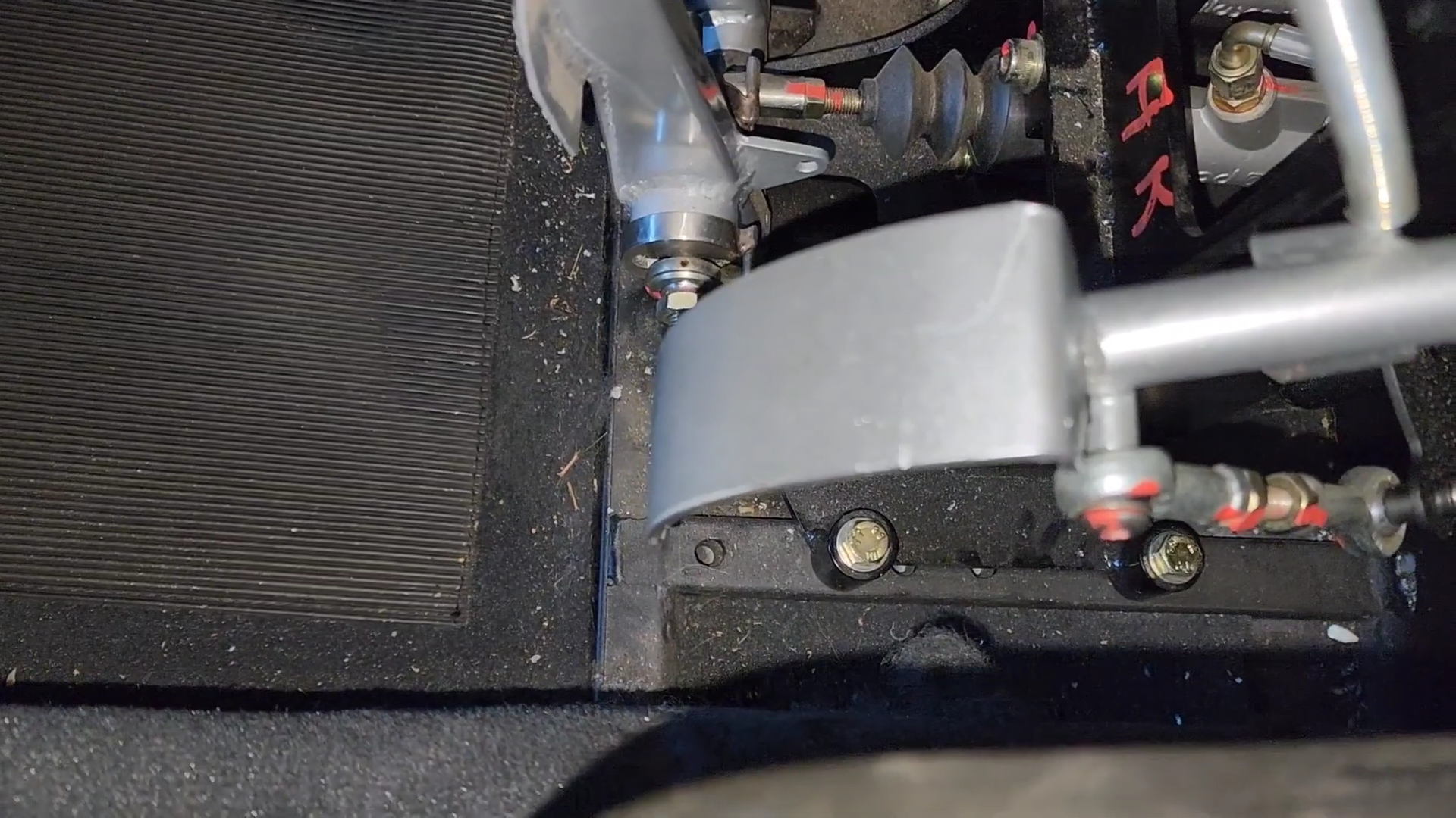

Relocating the SPF pedal assembly
I think I know the procedure for moving the pedal assembly as I have seen a number of posts on the subject, however, I still have one question. There are four bosses on the bottom of the bracket and one at the top. Presently the two bolts at the bottom use the two front bosses. Is there any reason the two rear bosses cannot be used, provided the pedals are now where they I want them? They would be much easier to reach since they are much more accessible and open.

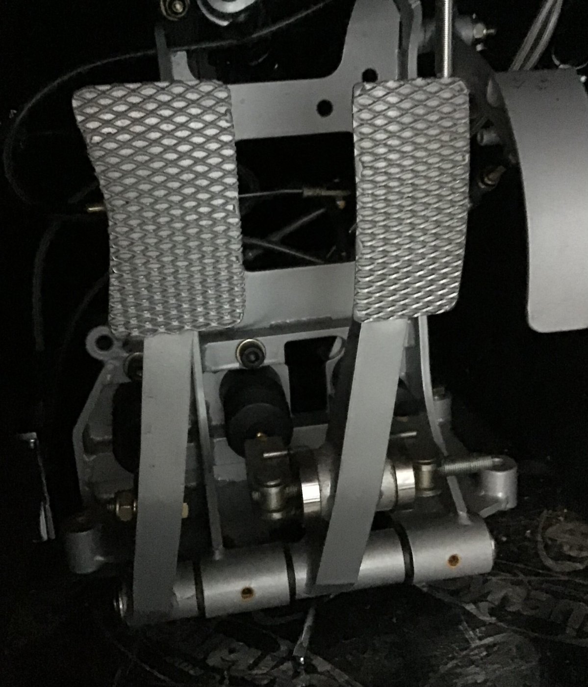

This is the pedal assembly. You can see both rear bolt bosses clearly. The front right bolt boss is visible, still held down by the bolt. It is virtually impossible to get a picture of the front left bolt boss as it is almost totally obscured.
Superformance must have had a reason for the four bolt bosses because the original cars only had two where your two bolts are now, with two at the top.
My thought was that the pedal assembly is something off the shelf, maybe Wilwood since they use their brakes, so that it came with a number of fastening locations for a variety of applications. I don’t see that it should make any difference which two locations are used, just as long as it is secure.
I'm sure Superformance fabricates the pedal box in house, it resembles the original. Maybe when moved all the way forward the two most rear bosses are used and the top bolt location lengthened to allow more adjustability over original cars
