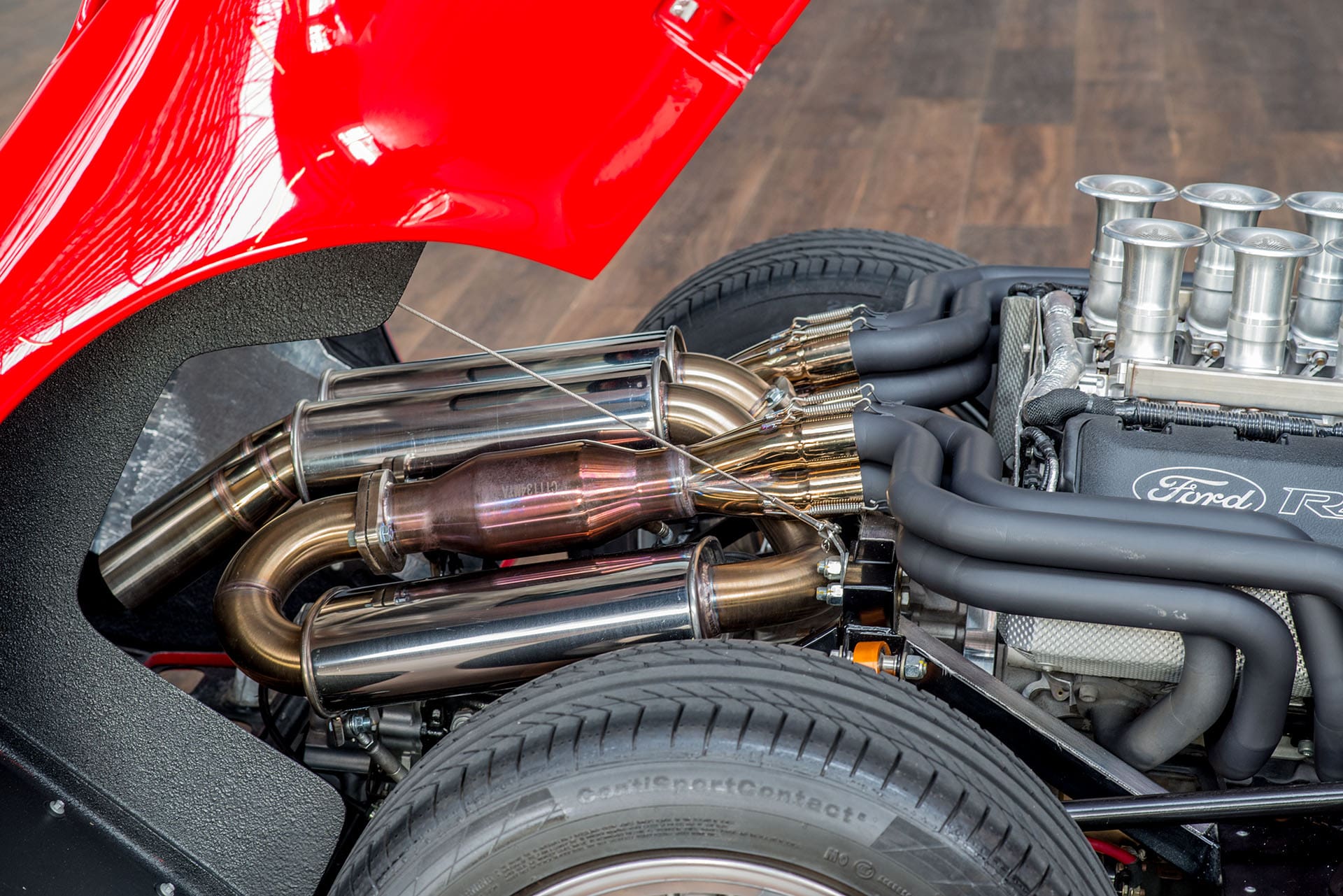

So, I have been searching for a solution, I still have to have Catts, this restricts the space left for an effective silencer. I found the picture below on the net of a GT40 that on the face of it could solve my problem, but a few questions. First is heat management, how much more heat will this type emit. The picture shows four silencers; do I need all four, would two suffice. If anybody has got this type of set up, or have any knowledge I would be grateful for any feedback.

Yes, heat is a problem when you have to run CATs. I have one setup which uses a total of 2 2" Magnaflow 599560910 CATs in line with 2 mufflers (and dB killers - not too loud but hot due to the loop exhaust fumes have to take - like a heater coil :)). The other uses 2 HJS CATs enclosed in a muffler (somewhat cooler and louder :)). Both will pass CAT emission tests no problem. Look for photographs in my log https://www.gt40s.com/threads/walters-rcr40-build.57015/page-2. - you see both versions.
I recommend using HJS (race) CATs - they are about the best you can get. In the past a Magnaflow CAT has failed on my car (after little use). Make sure you ceramic-coat your exhaust system. Most of the heat comes from the CATs (they need it to work) - high quality units should take it. It is more a question if their surrounding does. From a heat management standpoint you want the hot exhaust out of the engine bay as swiftly as possible (by convection rather than diffusion!).
