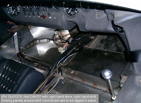

We're almost done and it's been quite a challenge. There's a heck of a lot of stainless steel in CAVs' monocoque to get through!
The shift rod connects to the ZF box with one less u-joint and at lower angles of angularity than the center shift design plus you get to use your right arm:)
More pics coming with gearbox end, stay tuned...
