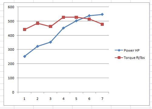

Your dyno results plotted in Excel.

Thanks a lot for these replies. I understand better what is going on. Manowar, these are very nice engines you put together, I remember reading an article - I think maybe in Kitcar magazine. I see the slight dip you have in torque around 5k rpm, it is really minor.
I have posted the dyno sheet, and put it in Excel as well. P Thompson, sorry you ended up typing it in, I had this spreadsheet already but had not figured out how I could attach documents!
