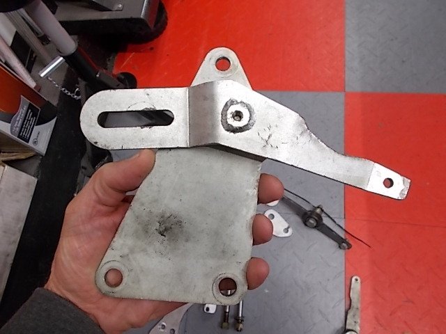

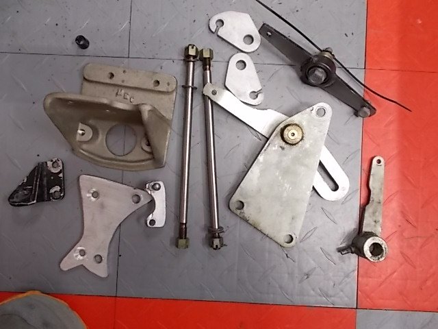

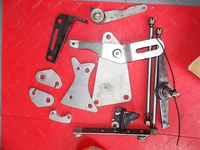

Ok im starting to get some ideas here--there was a box full of parts im seeing as maybe this Olthoff kit--enclosed is a picture of these parts? I bought this car with the trans removed--the previous owner died so i trying to figure this out

Your photos are SPF supplied pieces, not Olthoff. Refer to 2014 link in above post for Olthoff kit. Unfortunately Olthoff's website is still not fully operational, but you can call them for price and availablity.
