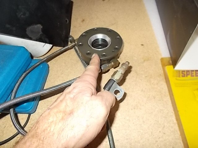

Re the 2 lines into the throw out bearing…… fluid in one and the other used to bells out the air.

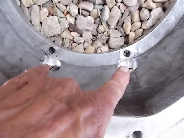

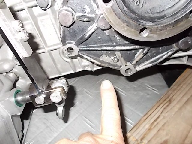

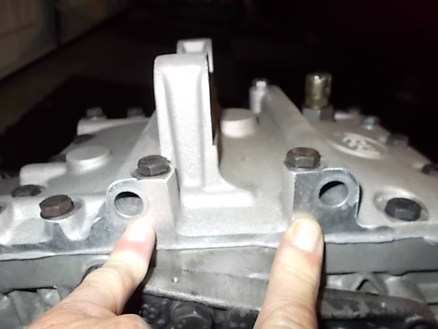

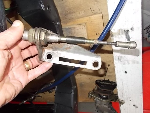

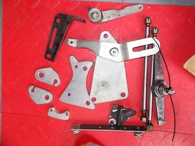

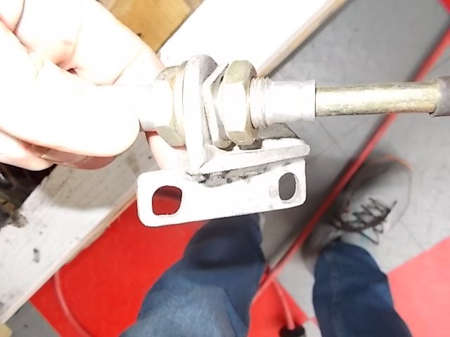

Attached are pictures of the bellhousing which looks like someone ground out 2 holes to get to the bell housing to block bolts. #2 i spread out all the parts that were in a box and i have no idea where the heck they go-they all look customer made. #3 do i run the two hydraulic lines to the Throw out bearing in the side shaft holes that were used for a manual acuated throw out bearing linkage? i took a shot of those twon holes--the lines have to go thru there or the two holes some drilled out. #4 i take it its much easier to install engine with trans all at once? Thanks for you help guys and hopefully somebody knows WTH those parts in the box went too. My trans guys says they dont go in the trans.

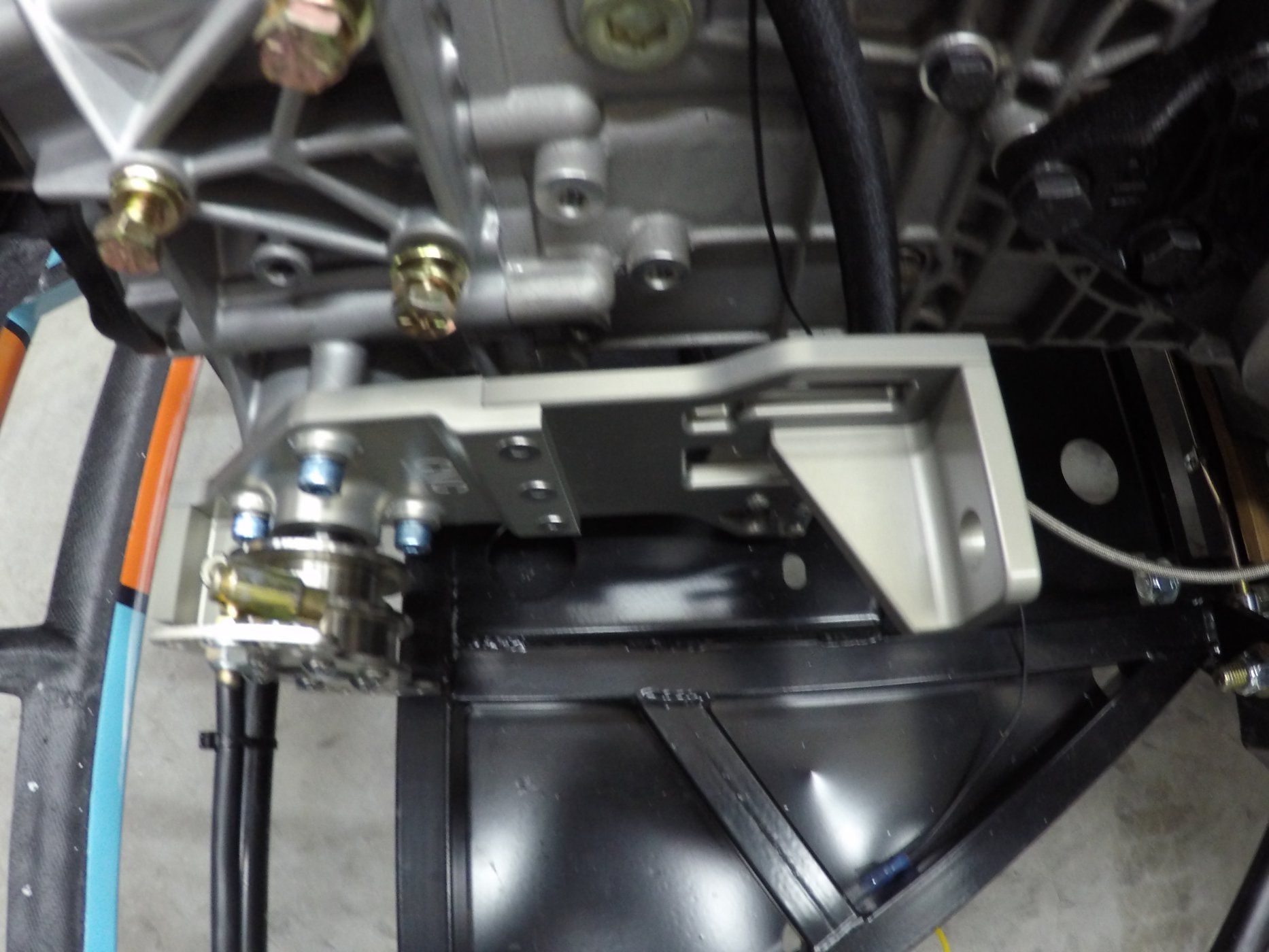

Mark, I have a Windsor/RBT as well. I like the clutch setup you are using. I used an internal slave as well but if I was to do it again I would use an external slave. I was sold a Kennedy , 4 inches thick and had to mill it down , not very happy with the fit. be very carful with input shaft length and housing alignment/runout.
I think the holes , ( a pic would help ) are for unbolting the inside bolts without removing the bell and exhaust system.

Mark, those two holes are a common mod that allows you to remove the two internal bolts (nuts if studs are installed), so that the transaxle can be removed without having to remove the engine also. Easier IMO to remove/install engine and transaxle separately, but YMMV.
I did this mod on my car and installed studs in those two locations, which are helpful to guide the transaxle into place.
I would rethink the internal throw out bearing especially as it looks like a McLeod one. I had 2 of those leak and finally got fed up and went with an external slave. The McLeod bearing kept leaking at the swivel fittings. It is easier to install the engine first, then the bellhousing, and finally the trans.

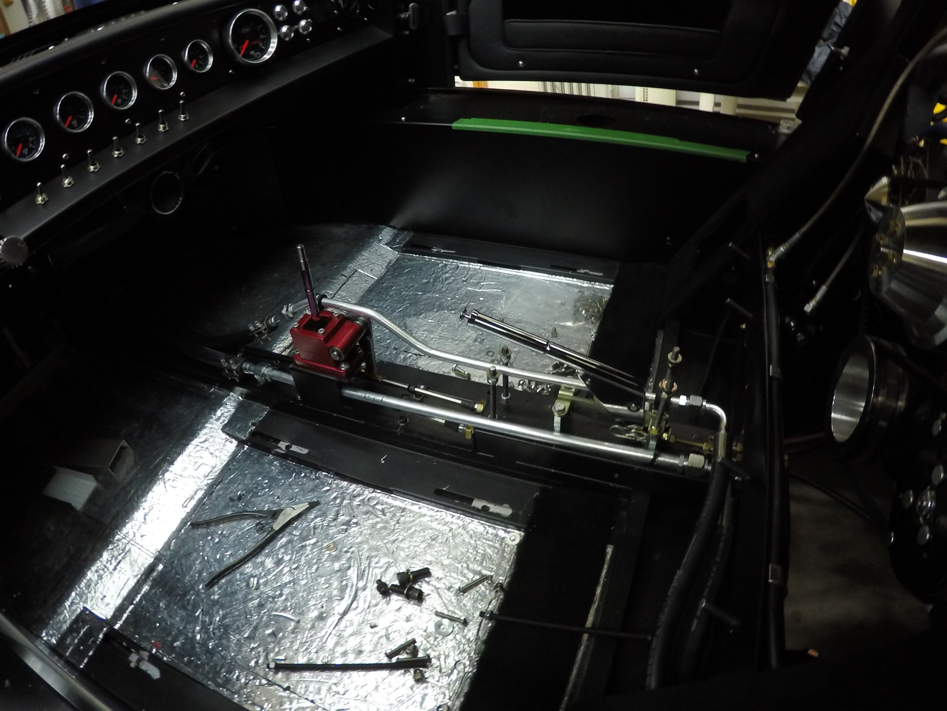

Some of those parts are the shift linkage on the right side of the trans. It might be worth buying Blas Costagli's workshop manual for installation illustrations. Also Olthoff makes a better shift linkage than the standard parts.

As for your shifter Mark, have a look at cncperformanceparts.com

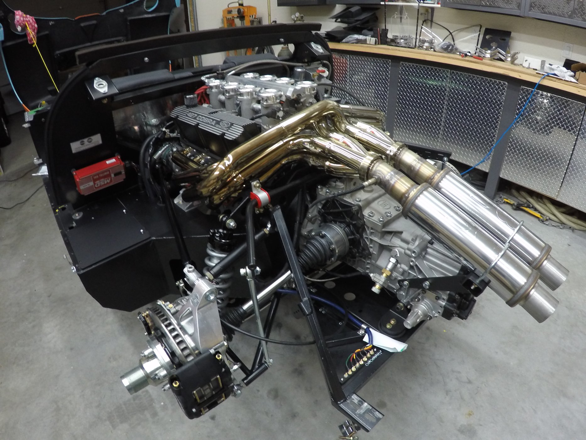

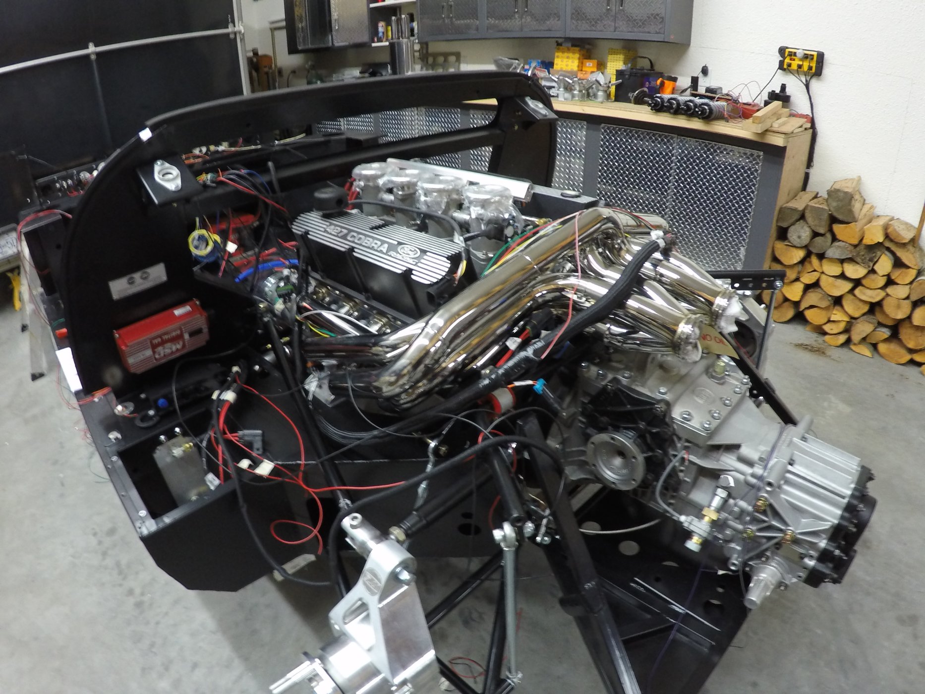

Wow what a nice looking set up you got there. How much did the 8 stack cost you? Very clean
