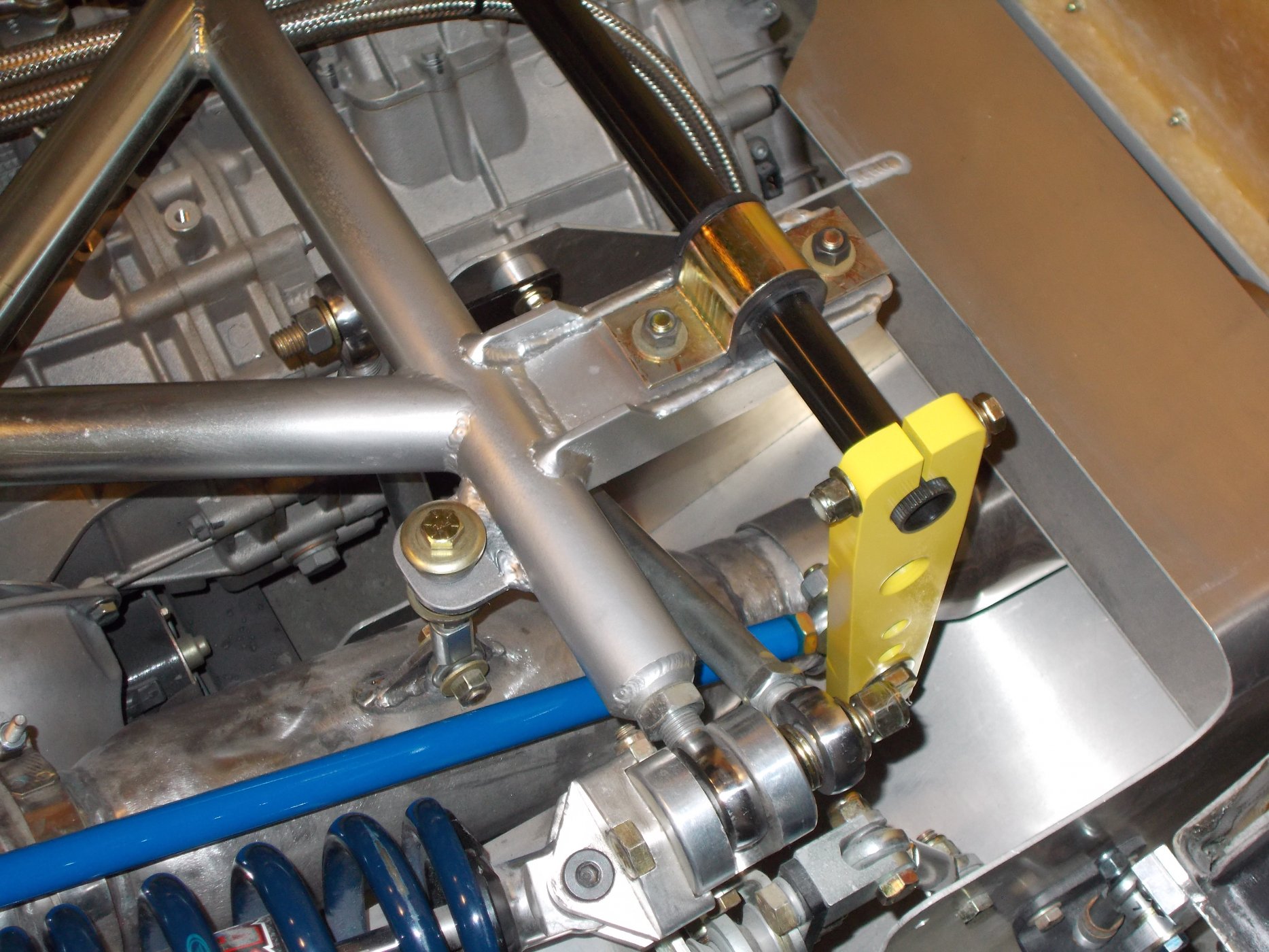

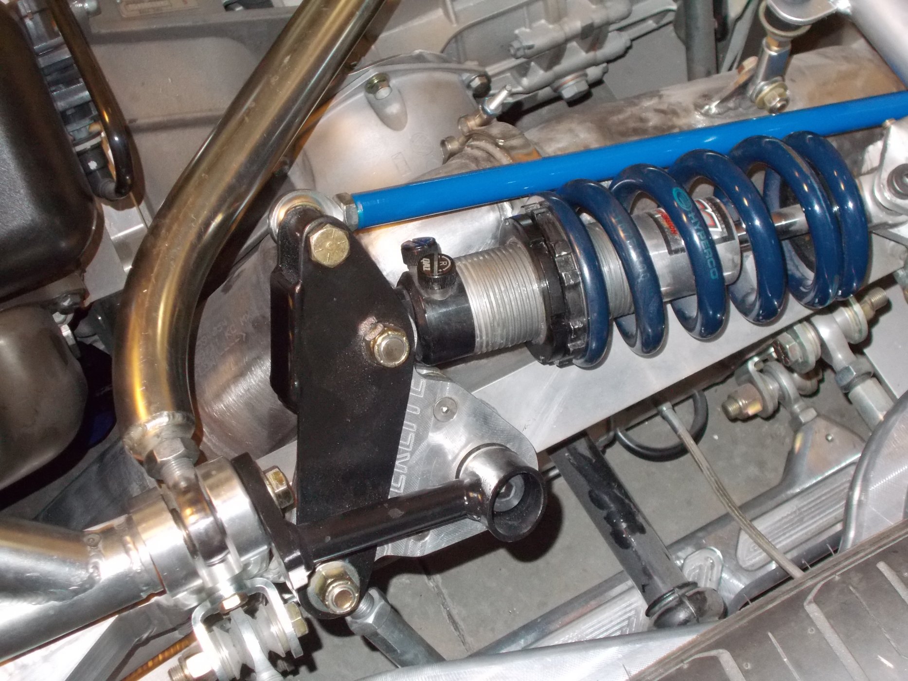

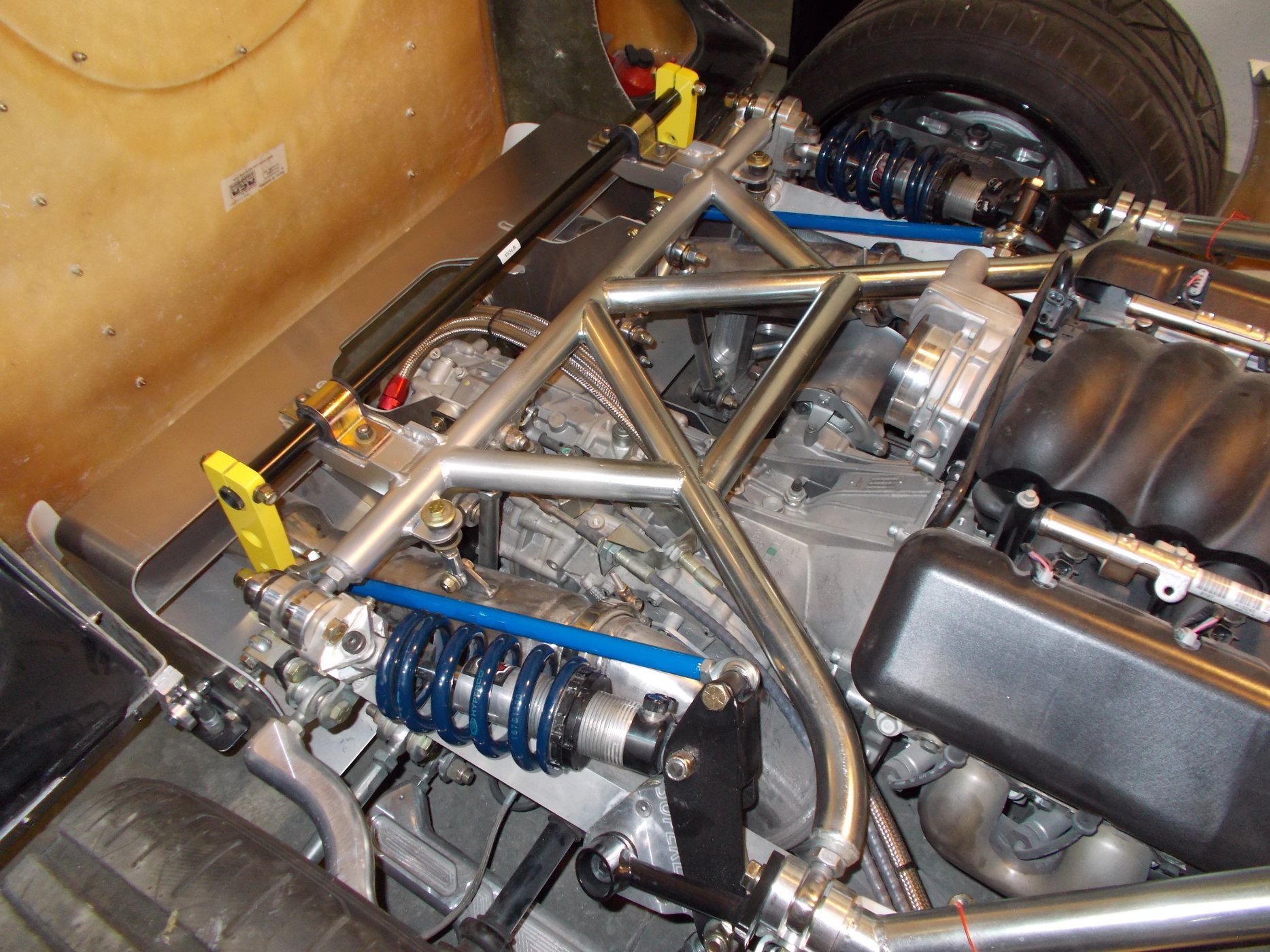

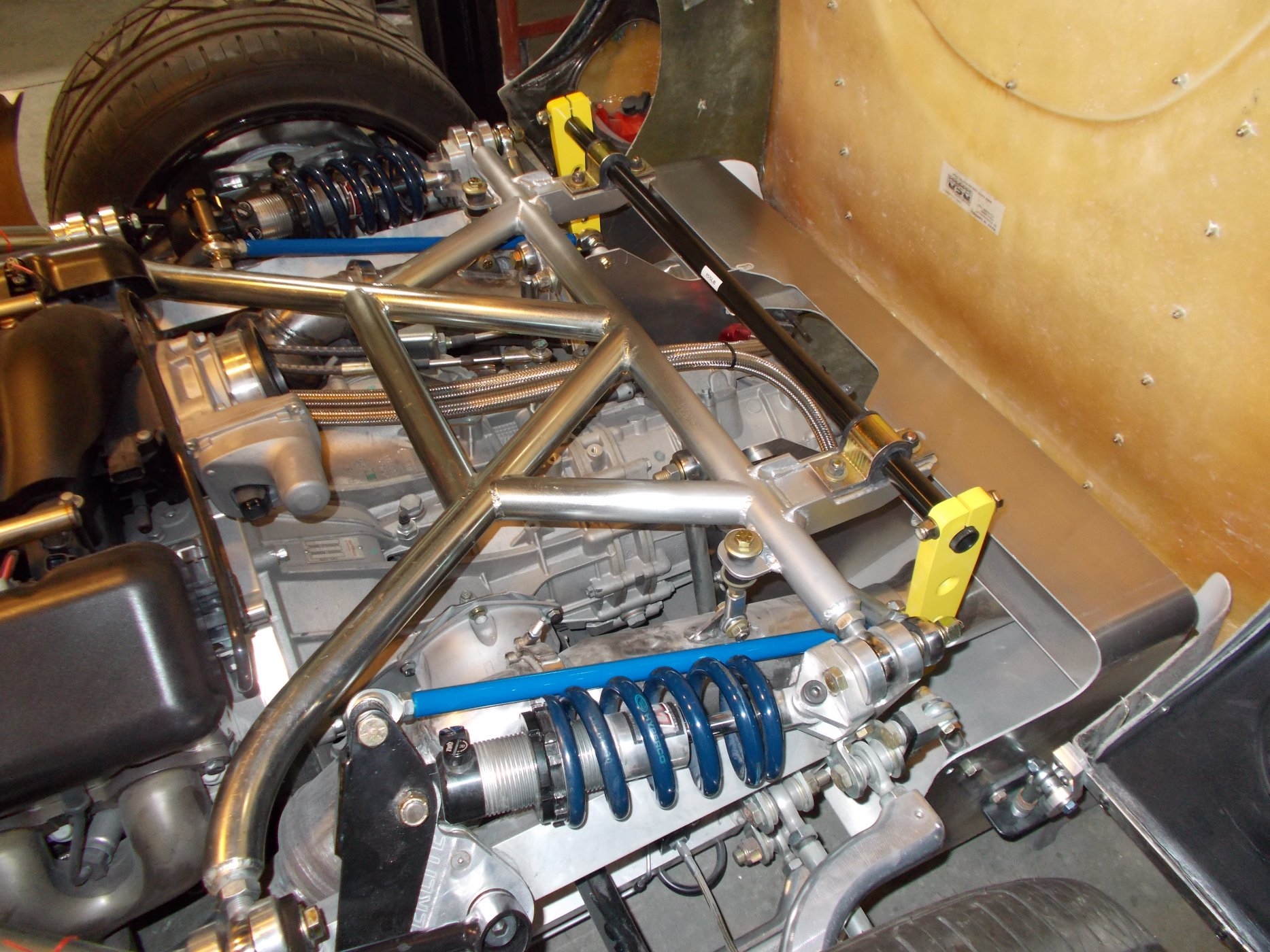

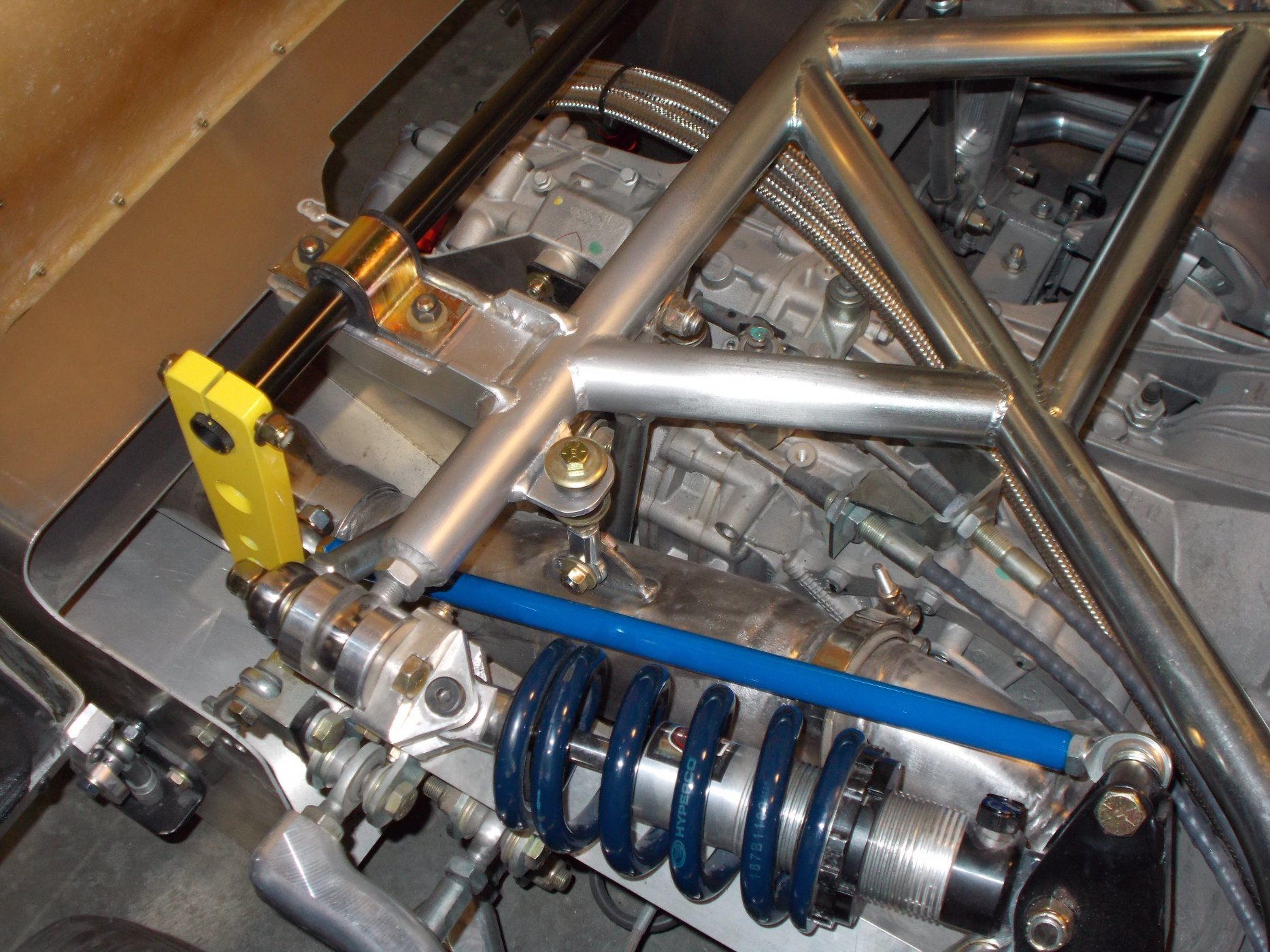

It took a little bit but here is what I came up with for the rear sway bar. I started with the lightest bar 155lb and should have great adjustability I have used this set up before and have had great success with it. I am running the grazziano so with additional bracing things are tight but it all works through it range of motion. The only possible issue, which I will find out during testing is the need to go a lighter bar and if necessary that may be a challenge
