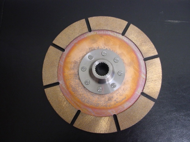

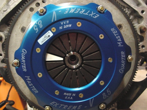

The attached photo's are of an 8 1/2" single disc clutch assembly good for about 375-400lb-ft. Friction material is bronze/ceramic.
Andy

The disk like the QM pictured I'm guessing would not be at all good for street driving (with some track). I had a triple 7.25" pack like those from tilton and gave them a call before setting it up. The said that it would operate like a light switch, then asked me if I had a winch for my race car to get it into the trailer :), they are not at all tollerent of slipping he mentioned. He convinced me to move to one of the 'Dual' cerametalic's which is a bit better and has bonded material (Much thicker hence only a 2 disk pack) then a sprayed on metalic friction material. He said that heat from slipping is a problem causes warping of inner plates, as well as rapid wear of which their is not much material.
Sandy
Sandy,
I am of course concerned about street manners. QM's tech staff opined that this particular setup (though it will employ a spring center hub on the disc, not the solid center pictured) will be streetable; a bit touchy but completely tolerable. We'll see. Most high performance and race clutches are sans the Marcel spring. It is my belief that the Marcel is what aids greatly in driveability on the street. The only multi-disc experience I have is with race cars. From that, I know the clutch is more or less on/off in terms of engagement. It would be nice to have the engagement modulation along with the ease of pedal effort in a multi-disc.
