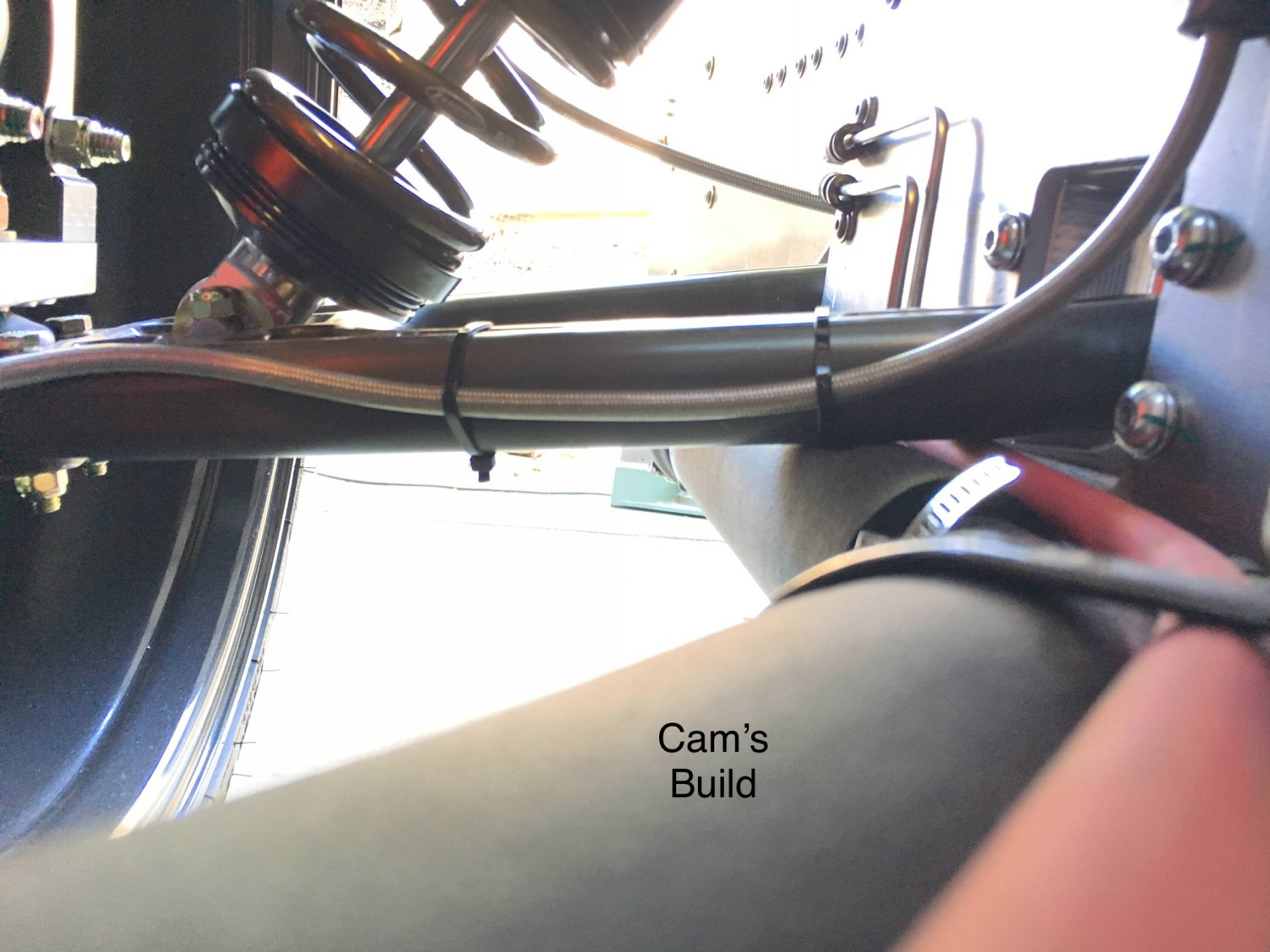

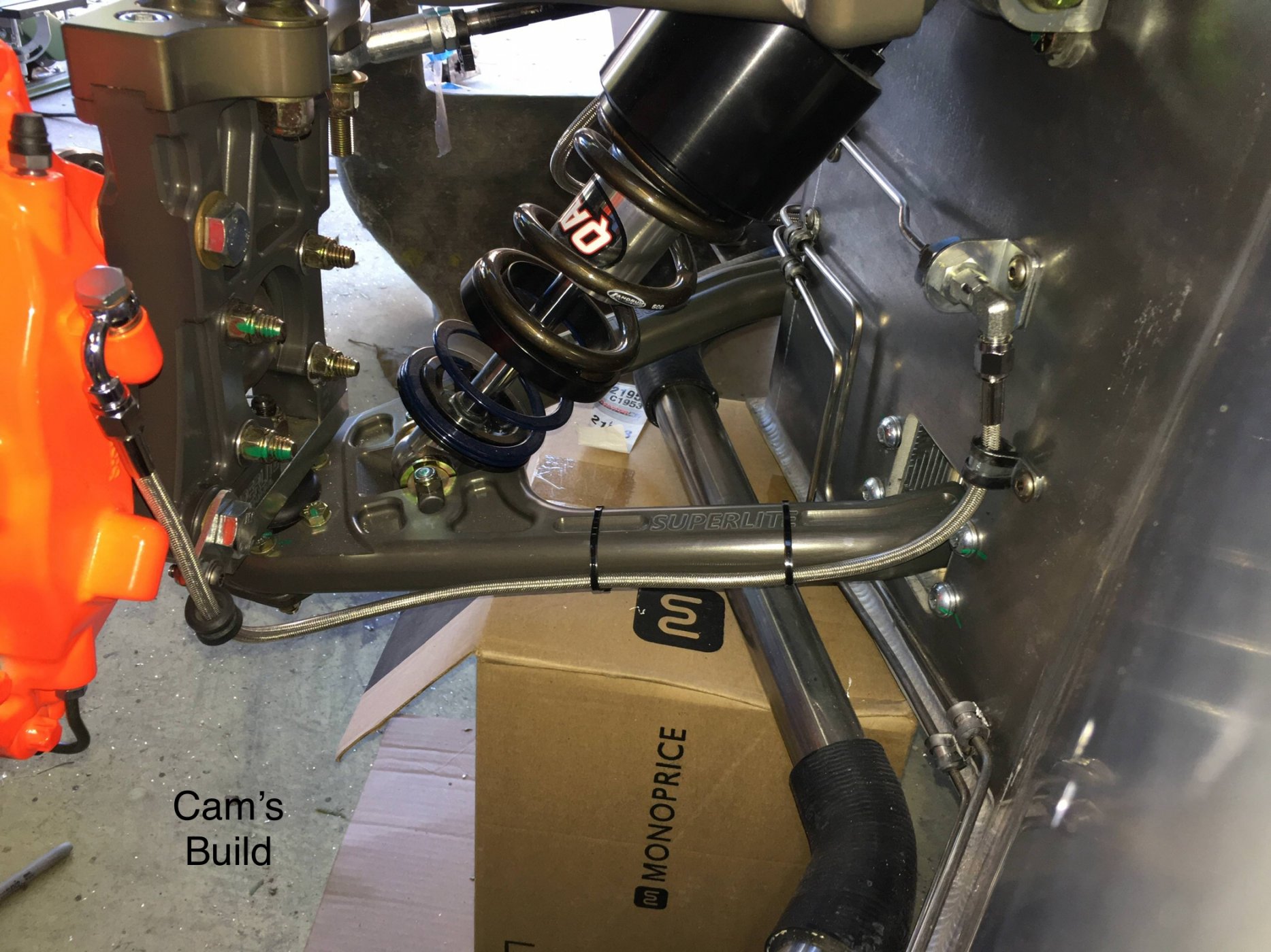

To Terry’s point here are some pics of using helper springs with your existing springs and shocks. They fully collapse when car is at ride height and only expand when the suspension goes to full droop to keep the springs seated on their perches.
Here are two pics from Cam T’s SLC build…25 lb helper springs…
At full droop…
at ride heigh…the helper spring is fully compresse…

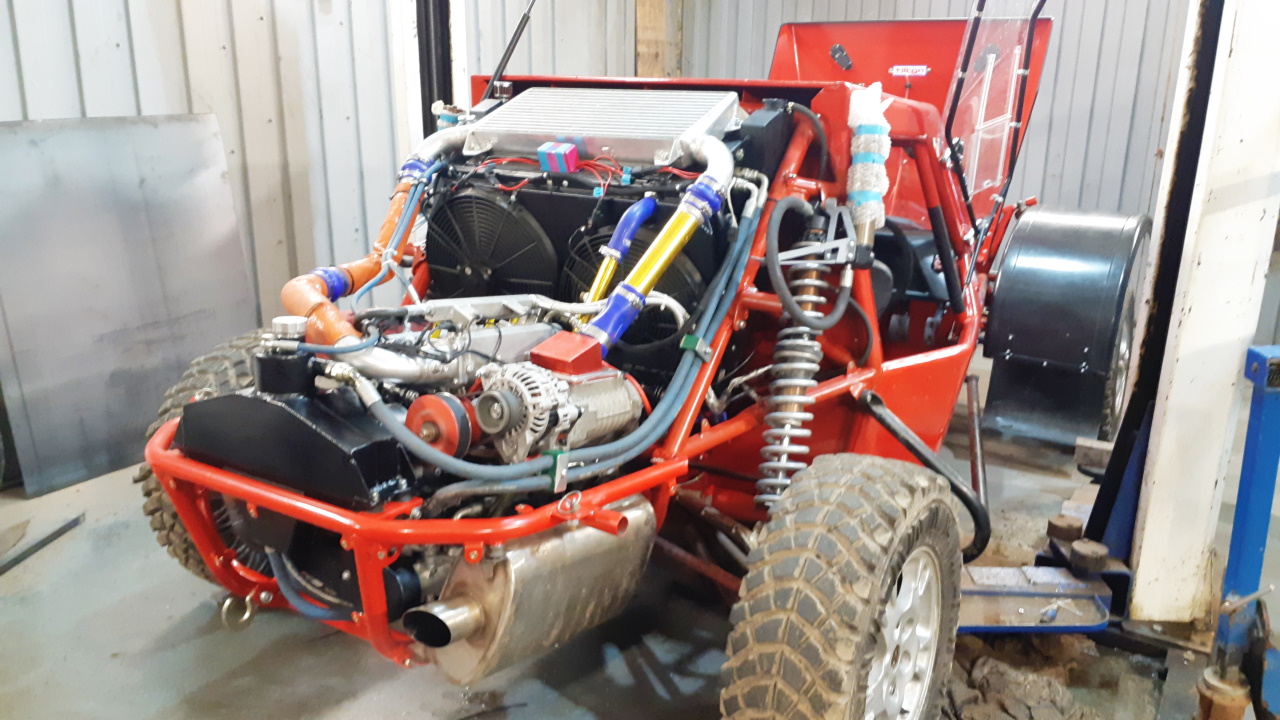

This is SOP for rally and off road racers. In my mind it's the proper way to do it for all the reasons being documented.
As everyone else said, use a tender spring, this is a standard thing for us rally guys - don't be tempted to run it, your suspension goes to completely unloaded more than you'd imagine even on the road.
