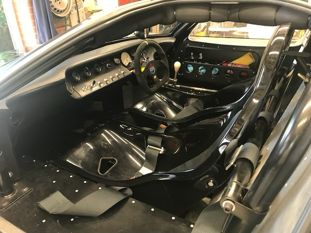

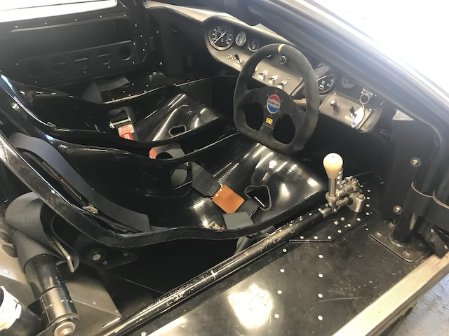

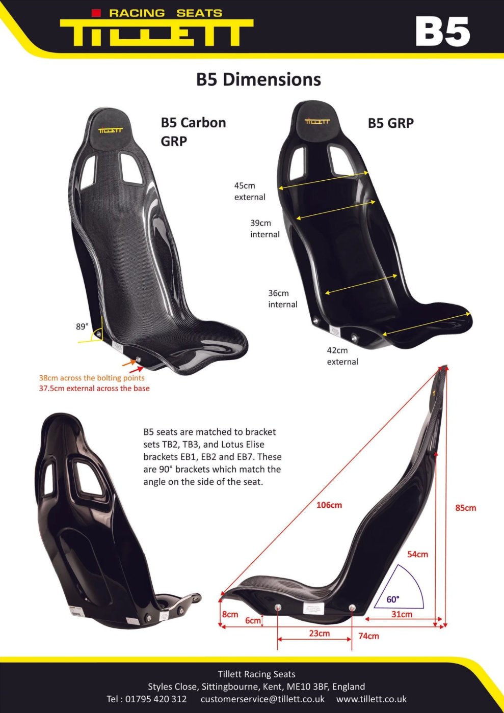

I know that I've seen some Tillett seats in some GT40 builds, but what model fits the best? The Tillett B4 is the best I can find so far, but I'm open to other suggestions. My car is a +4" Active Power GT40, so I've got xtra room.
Thanks, Ben

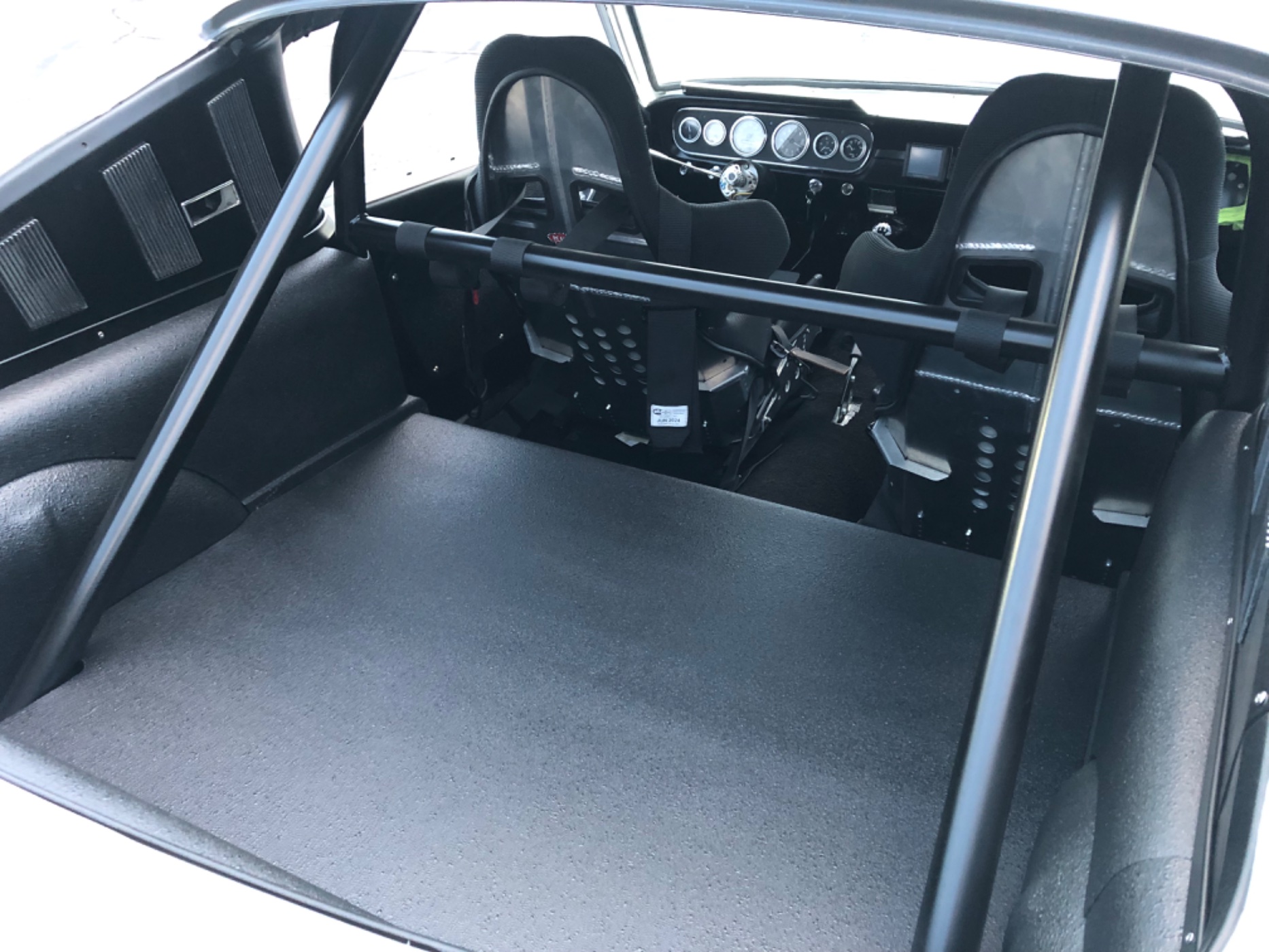

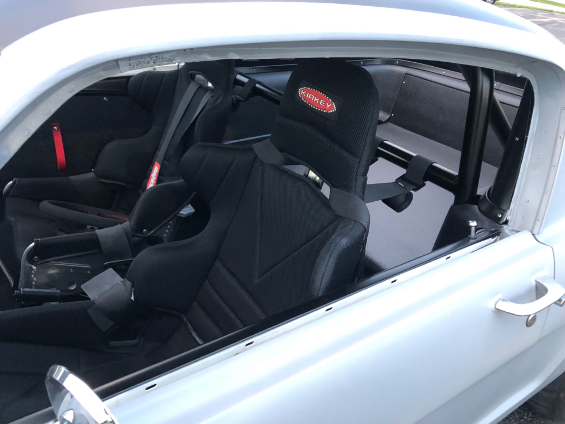

I have Kirkey's in my '66 project and thinking about going that direction with my AP GT40. I'll modify the aluminum structure if needed and probably get them recovered with Alcantara.
