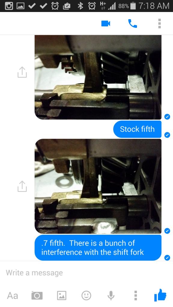

Just in the process of buttoning up my transmission and with great anticipation I finally got my tall fifth gear installed I had purchased from Tornado Sports Cars. Got it slid on and installed the shift fork, but it is about 1/4" out. Turns out the gear on the input shaft is larger diameter and colliding with the shift fork. To say the least i am a little frustrated. Anyone have any experience with this or is there something different with my transaxle.
Transaxle is out of a delorean, a UN1 369 iirc.
Thanks,
Josh
