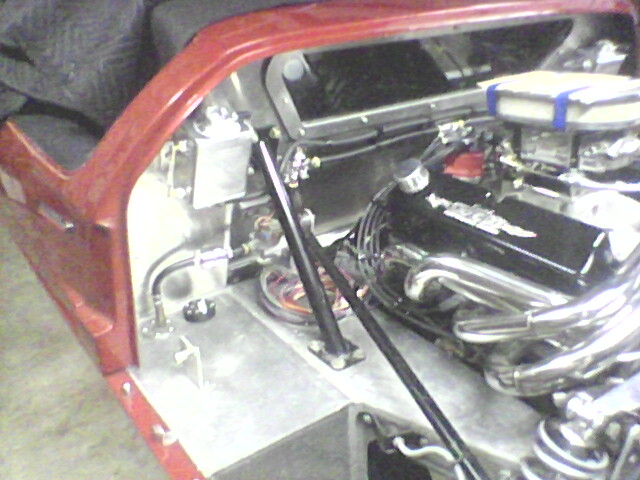

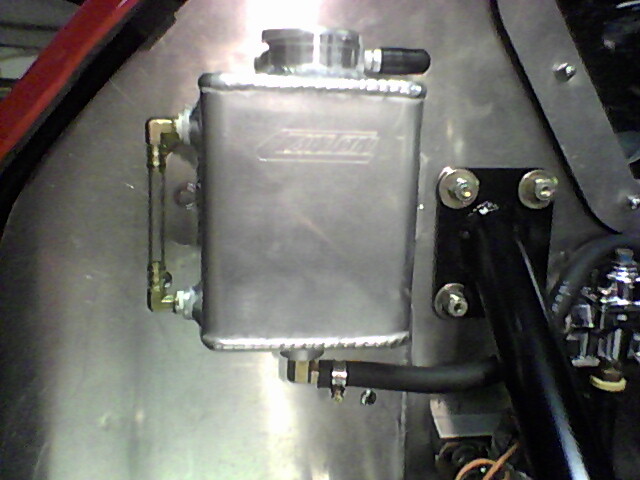

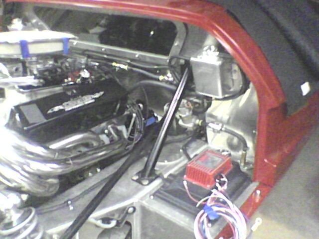

These are normally part of the coolant system. One of the two tanks is almost always a surge, or expansion tank and has a pressure relief cap, usually 12-16 lbs/in2 This allows the engine coolant fluid to expand as it heats. If the volume when hot exceeds the capacity of the tank, the cap opens as the rated pressure is reached and dumps, or transfers, fluid to the other tank which is a catch, or overflow tank. This tank has a non-pressurized cap or some sort of vent to outside air. When the engine cools down, the coolant contracts and the "excess" fluid that was dumped into the catch tank is sucked back into the surge tank and system. The "in" port to the catch tank is at the bottom of the tank so it is covered by fluid, allowing suction to pull the fluid back. The surge or expansion tank has it's overflow port positioned outside , or after, the pressure cap so it feeds to the catch tank only when it is full and the pressure has exceeded the cap rating. Check the photos. Right side (viewed from rear facing forward) is the expansion tank, left side is the overflow.
  • GT40, left side overall view; furniture blankets protect areas not being worked on.jpg
