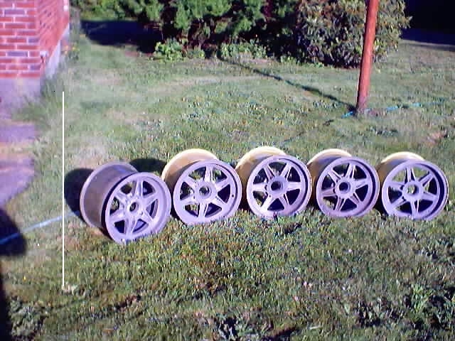

I have some old Halibrand pin drive, 15x10
And on my bathroom scale, witch is not the best.
They come in at 11 to 12 lb's each.
That might even be on the heavy side ?
The scale changes each time I weigh them.
As I said, not the best scale !
But something else to compare to.
Cheer's !

Curtis, that is quite light for a wheel of that size and I don't think anyone would be able to save anything using a bolt on over those!

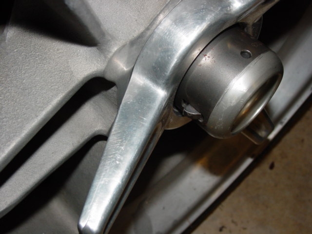

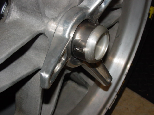

Where can I find some information on the auto locks?
Richard Timte
MBelcher,
The auto locks are little triangular spring loaded catches. When the socket is slid on it engages the locks and the nut can come off. Here are a couple of pictures.
