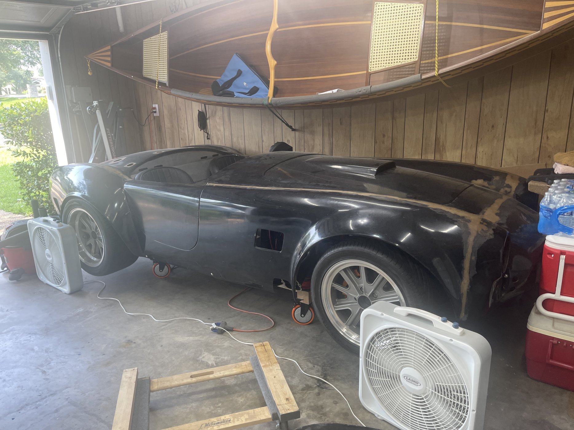

I’m in the US in Georgia; I should have mentioned that before! About buying it built; back in 2006 or something like that I saw a replica for sale on eBay; and back then prices were way way lower…to bad I was a broke student then. I kinda want to build my own; it makes it more satisfying to me. I need something to have as goal other than the daily grind of life.

I have experienced buying a partially completed kit car (FFR Mk3 Roadster). I would never do that again unless I knew the builder or they had a really well documented build log. Same for buying a completed car. Personally, the build process is why I bought an RCR kit in the first place. The one down side is the delivery wait time, but that just gives you plenty of time to review build logs (which you absolutely need to do) and to develop skills like welding.

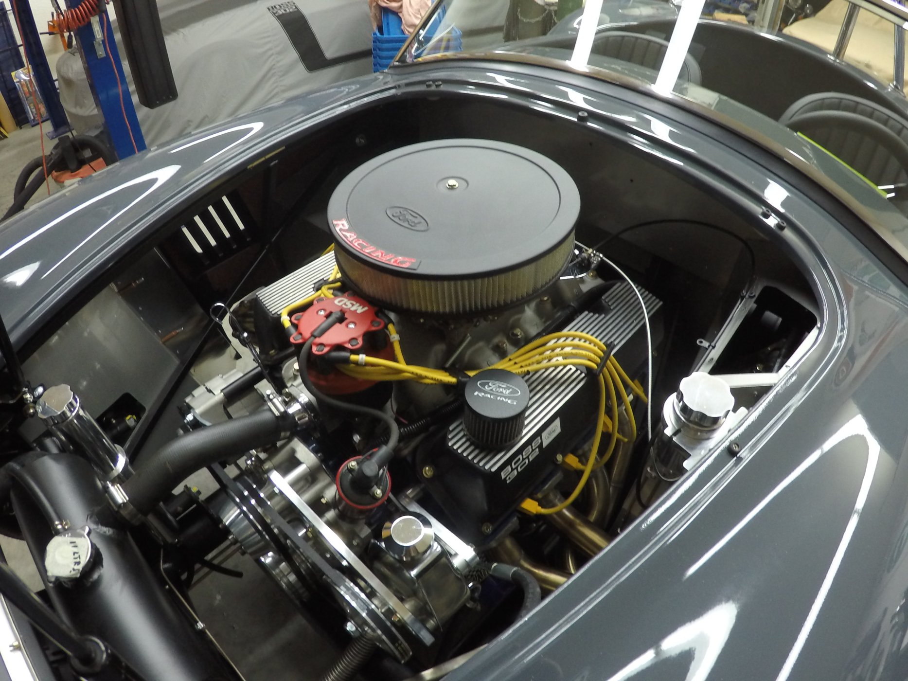

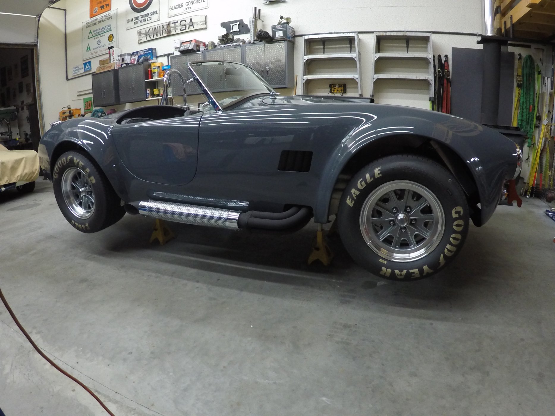

Randy, I also just finished a MK3 from Factory 5..All things considered not a bad deal, other than there bad arrogant attitude and junk parts from China that I had to replace or build my own.
Bill,
It looks great. Mine is sidelined while I work on the RCR40. I only bought it because I was going stir crazy waiting for delivery. I thought I could finish it in a few months, but I couldn’t resist fixing issues making it better :) So now it waits until the RCR40 is done. I am going to try to spend a few days a month on it so I don’t lose track of what needs to be done.
