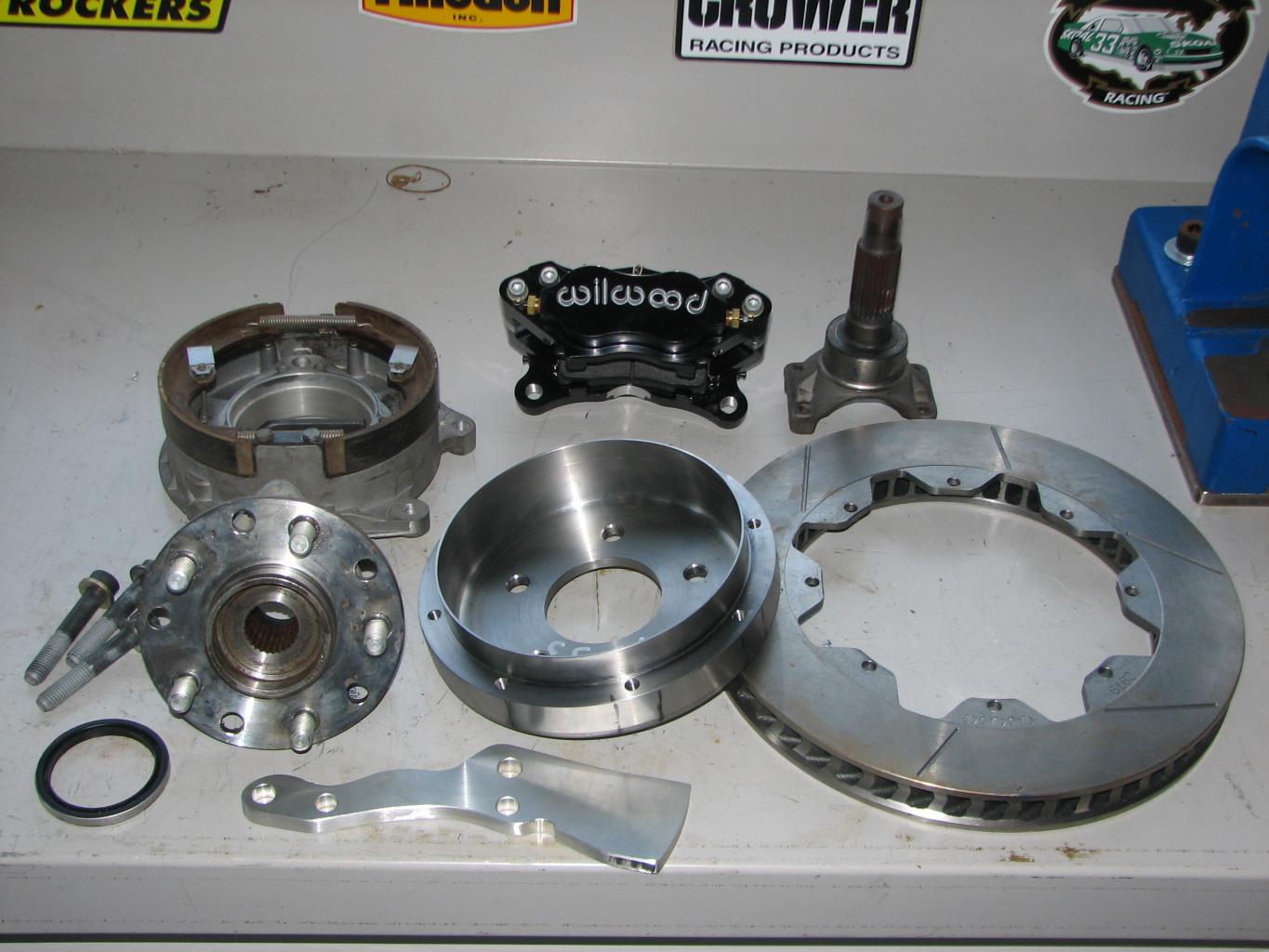

I've used mid 80;s corvette which incorperates the hand brake. I've gone to wilwood brakes but you can use all corvette brakes and then its quite simple to use the complete unit. I used all the front end from the same wreck as well These units bolt straight into the uprights I used, so the type of upright is where you need to start

Great looking setup for brakes.
What metal did you use for the Hat / Brake drum ???
thinking of doing something similar on mine but using BA Falcon backing plate.

Hi Kevin
Sorry it took so long to reply. I used 1040 medium tensile for the hat, mainly because thats what I had lying around.I'm not sure how it will work out a bit of a guess really. I didn't want to go any higher in tensile strenght because I once made a flywheel from 4140 H/t and I ended up with hard spots and then cracking. Most flywheels have worked fine in 1040.

I agree with you on 1040
I was playing with 6061 aluminium ones with a steel insert (K1045) to do the same job. (similar thinking to alloy flywheel)
I heated the aluminium up to 220 degress (wife's Oven on Max) and froze the steel insert to get a 10 thous interference - not sure how good it will be but I can pin it if I need to.
On reflection my weight saving was minimal compared with yours
Cheers KevinB
Kevin
Good idea with the insert I'm sure that will work fine but how do the wife's cup cakes tast, not metalicy I hope. I've since milled out a substancual amount between the bolt holes and had them balanced. Not sure if the internal finish is to smooth for the handbrake to hold the weight of the car. especially after watching the guy at the testing station give my truck a WOF he used power rollers in the floor to over run the handbrake.:shifty: A little harsh I thought given its just a hand or park brake and not really ment to stop a rolling vehicle. Might have to get out the knurling tool:embarassed:
