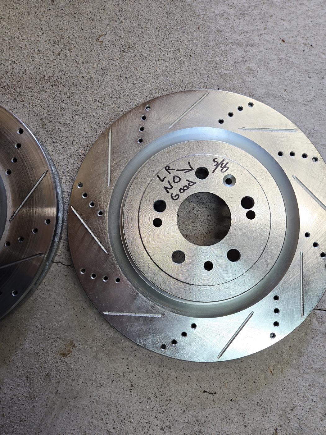

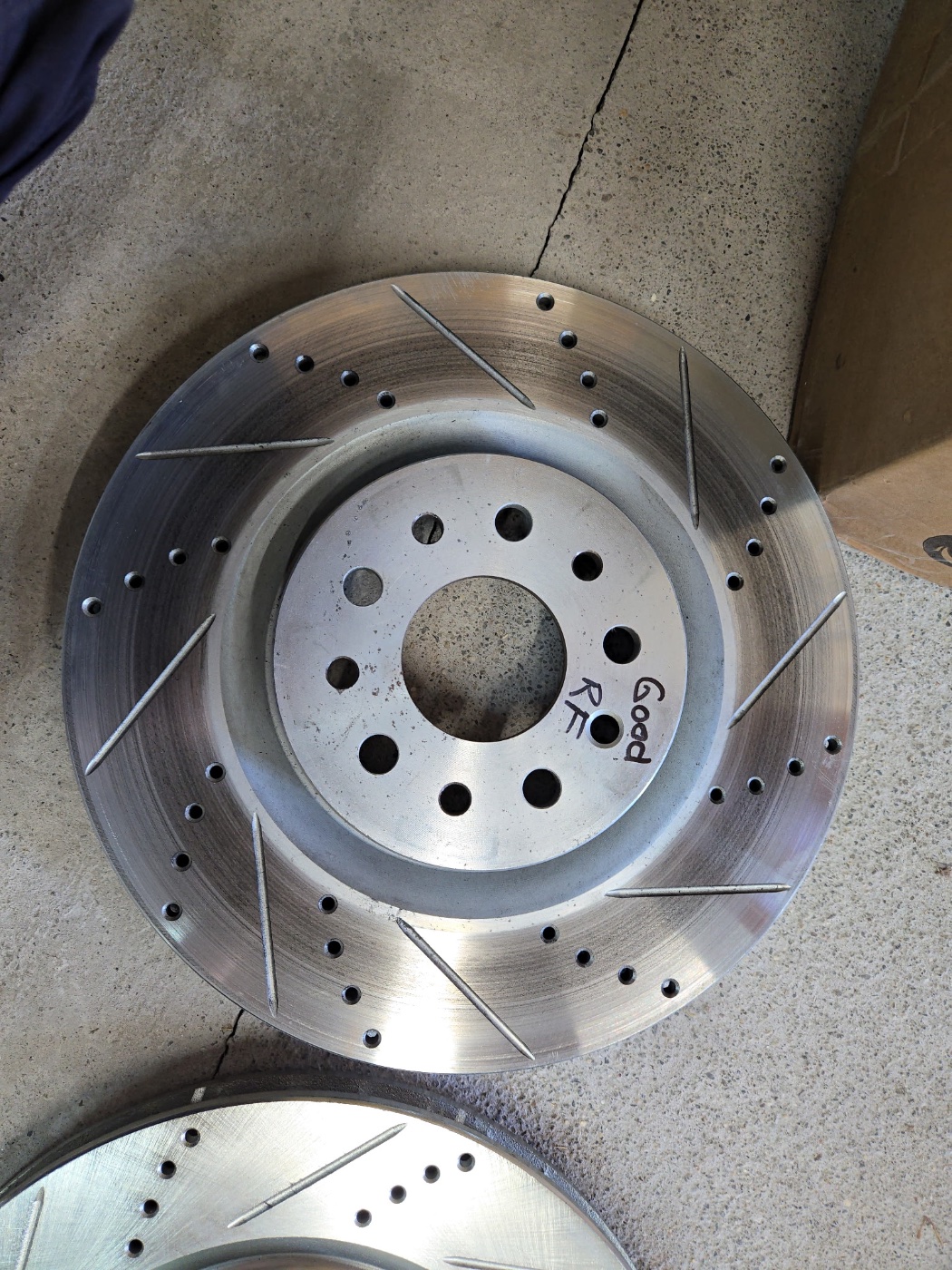

The RCR solution is to take a stock Camaro SS rotor, enlarge the center hole to match what will fit our hubs, then drill an additional set of 5 holes on the rotor to match our smaller studs. In my case, and apparently a few others, the second set of drilled holes were either the larger 16mm size and not the needed 14mm set - or - some of the new holes weren't clocked correctly, creating weak points.
I plan on owning my car for a LONG time, and didn't want to rely on my memory for dimensions for future rotors. Nor did I want to have to deal with a machine shop to do the work. Similarly I didnt want to rely on RCR for getting rotors, and then wondering if they were done correctly (which 6 of my 8 rotors, including 1 set of replacements, have NOT been correct.)

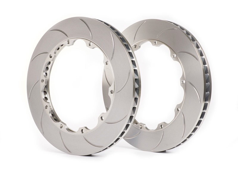

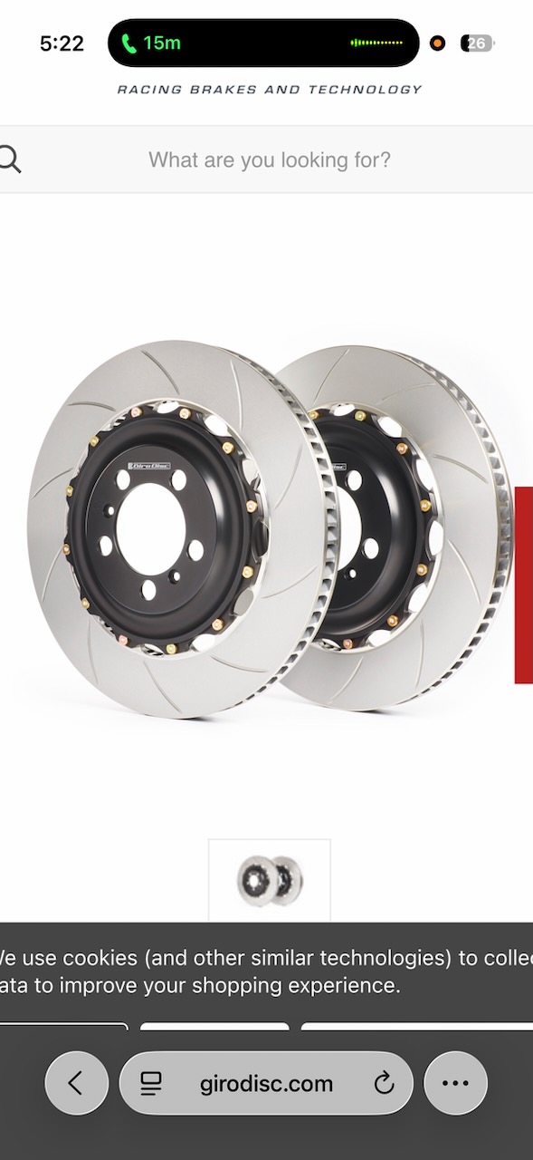

So, we have arrived at my ultimate solution... I contacted GiroDisc, an American company who make premium two piece floating rotors for everything from Ferrari to Chevy's. I originally asked them about drilling out one of their off the shelf Camaro rotors for me, so in the future when I needed new rotors I could simply swap the outer disk with an off the shelf Camaro SS rotor. They were willing to accommodate me, but they also said if I could get 4 other people together for a group buy, they could custom make the inner portion (called the hat) so that there didnt need to be 10 lug holes, only 5. Within a few hours and a few phone calls, I got the minimum 5 sets to put things in motion. Girodisk tells me that it'll cost $1300 per axle for the custom hats and off the shelf SS rotors, a direct bolt on for any GTR or SLC owner utilizing the Camaro SS brakes and corvette hubs (which is most.). This requires no modification, just remove old rotors and install new.
They last twice as long as standard rotors. Run cooler. Weigh almost 6 lbs less per rotor. Look better behind the wheels.... and most importantly, they streamline future replacement which are much cheaper.
