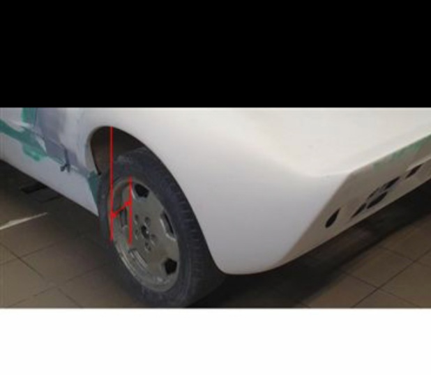

I just want to order rims for my gt. I will be ordering in image.
can someone measure me the dimension from the photo?
I do not know how to choose the rims et.
I don't want the wheel to stick out of the body
Mike Pass
I do not know which car you have for body and suspension so impossible to say. Most GT40 replicas use 8 inch front and 10 inch wide rear wheels. 15 inch diameter with 215/60 x 15 front tyres and 275/55 x 15 rear tyres. To get the ET you need use this link which explains how to measure and calculate the ET you need.
