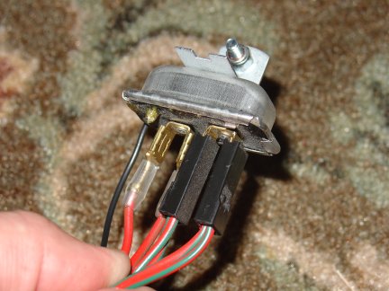

Robert, in laying out the wiring, everything seems to make sense, although wiring is like a mess of spiders to me. One question, (for now) in the pictures, there is what looks like a relay that is attached to the speedo. Since I've relocated my speedo to the side, I want to know if this can be attached to tech. I'm attaching the picture to make sure I am identifying this thing correctly.

Robert Logan
Pat,
The item in your photograph is a "voltage stabiliser" and is part of the Smiths instruments. The Smiths require a stabile voltage and not the varing voltage supplied by every alternator. This item supplies exactly the correct voltage and that same voltage at ALL times. The important thing is that the mounting lug MUST be earthed. We usually mount the stabiliser on the back of the speedo and put a black wired earth to it.
Hope this helps,
Best wishes,
Robert
Robert Logan
Pat,
Slight mistake, the earth wire is already attached (black wire) just mount her on the back of the nearest instrument.
Robert
