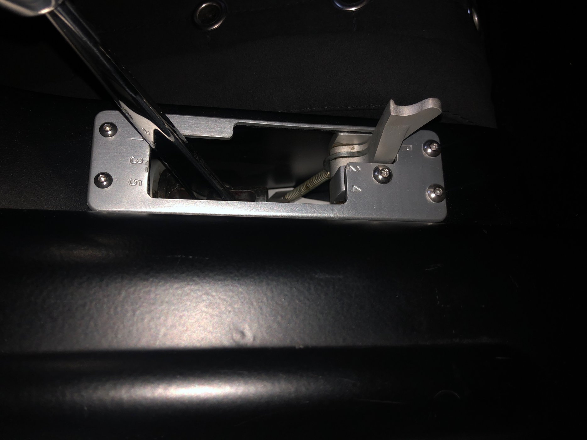

The wider part of the shifter box opening is towards the rear of the car. I'm 99% sure I have the cables in the correct orientation. Maybe I am looking at the box wrong, but if you look, you will see that the lockout orientation for reverse is down towards the driver. I have to push the shifter down (reverse lockout) and back to engage reverse. If I reverse the cables, it will not be oriented to the shifter box. Also, the cables supplied with the shifter box already had the ends on them and matched the orientation of the shifter box. That is why I am a bit perplexed.
After taking another look at the picture of your shifter box and lock out it is set up for reverse to be over and toward the dash. The cutout and block on the side is back for first gear then in neutral the push down on the shifter to get under the metal lip, move farther to the left and forward for reverse. Takes some fidling to get them to work right.
