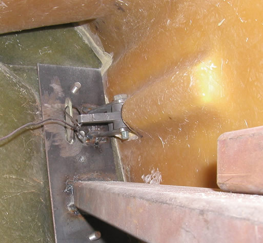

If I recall Vaughn added the tubes so he could weld a side intrusion bar from the hinge post to the striker plate, inside the door pocket..another nice touch....

Randy-- Yes, those are the standard hinges that Fran builds. Which are more than strong enough to hold the doors in place. All I did was beef them up a little bit so that I could do some things to the interior of the door. I did the same thing to a cobra that I built a few years ago. I will try to post some pictures of the interior of the door, but Fans description is right on. But, as they say a picture is worth a thousand words. That's why I'm so thankful for all you guys that post. Man has it saved me time!

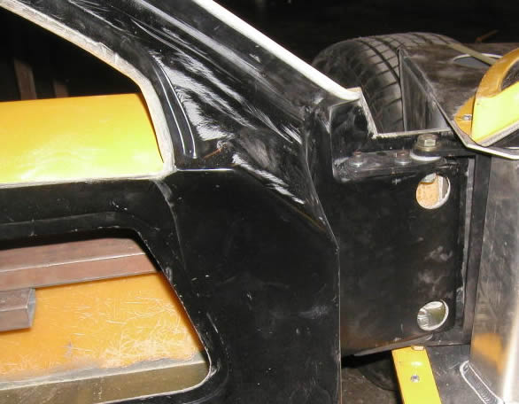

Your work is absolutely great, and I'm enjoying following your build. Incidentally, the built-in side protection steel in our Australian DRB's seems to really stiffen up the door by running from hinge to door catch, and giving both of those ends some solid steel (inside the door) to connect to.

Thanks for the words of encouragement. As far as my build is concerned I have to credit Fran for that. His RCR 40 is a fantastic piece of workmanship so to do anything less than the best would be criminal. Yes, I am an amputee on my left side so adding a little protection in the doors gives me a little bit more security. And you're right about stiffening up the doors it does help. Because of being an amputee I lean on the doors more than the average guy. By the way I have no problems with you asking questions about how I'm able to maneuver with a manual transmission. It is a problem with the floor mounted foot pedal assemblybut, what I'm planning to do is build up a pad on the clutch pedal which will allow me to shift it without any problems. I think it'll be a really simple fix. As far as the hanging pedal assembly it's not a problem because you don't need the ankle flexibility in order to shift. To drive these cars with anything other than a manual transmission would be sinful. Yes, you're right I have always been a driving enthusiast and I've had a lot of fast cars, but I've always wanted a GT 40 and after investigating and shopping the RCR was the best choice for me.

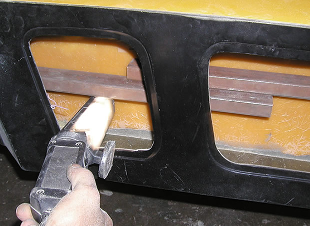

These are the pictures that I wanted to post concerning inside stabilizer plates and crossmembers. The crossmembers will be bolted together once everything is in place and there are also corresponding bolts on either end of the stabilizing plates. I have only one picture as of yet, but these were taken before I decided to put a rod through the door hinge. I will post another picture later showing the plate that corresponds with the door other hinge. I hope this makes sense.
Vaughn

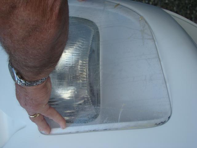

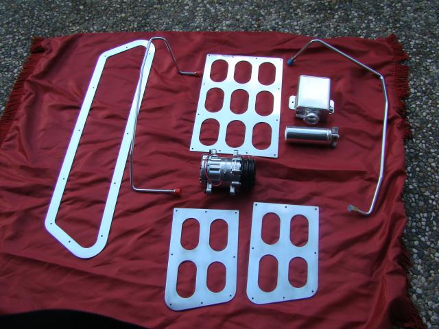

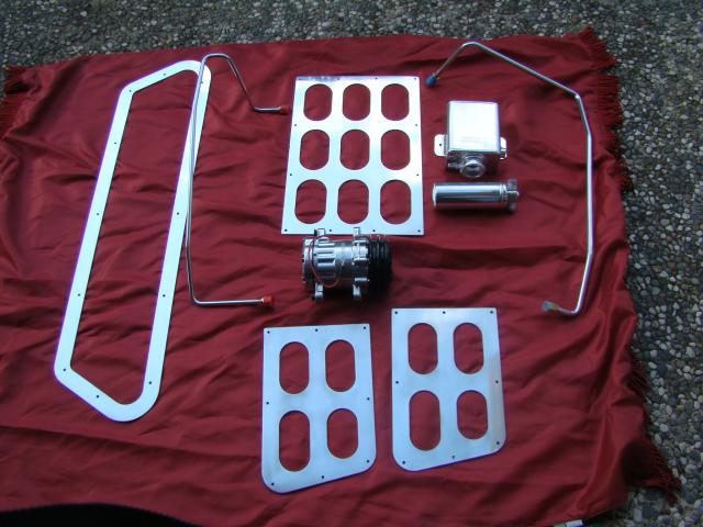

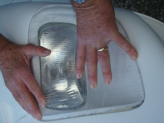

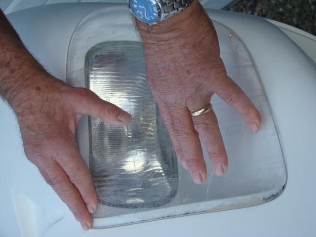

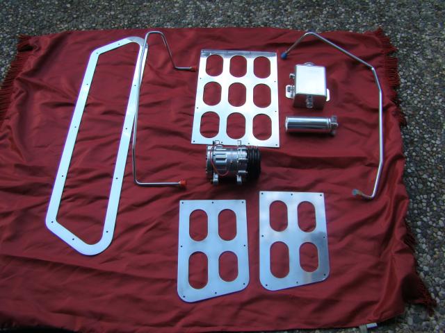

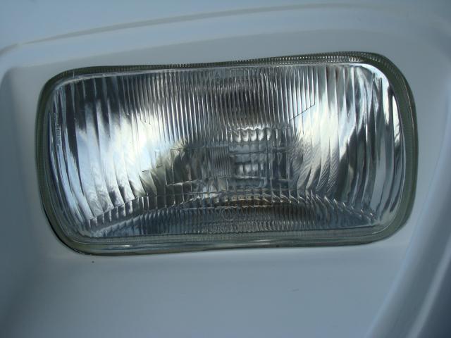

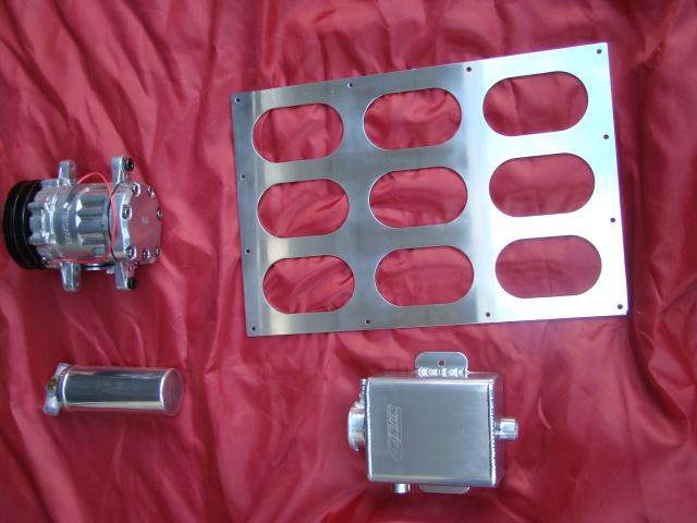

Well, I'm back again. Had some health problems that slowed me up in my build, but I'm finally back in the saddle again. I have been doing a lot of polishing as of late and thought I'd post a few pictures. I even polished the air-conditioning pump. Also spent a lot of time sitting the glass on the front end. I deepened the bezel's to allow the glass to flow with the body. It was a lot of work but I really think it paid off. I've gotten a few other things done as well but I will not say much about that until I can post some pictures. This car has been a real pleasure to work on and Fran has been a lot of help. I'm not exactly setting any speed records getting it done, but I will get it finished before I'm too old to drive it.
Vaughn
