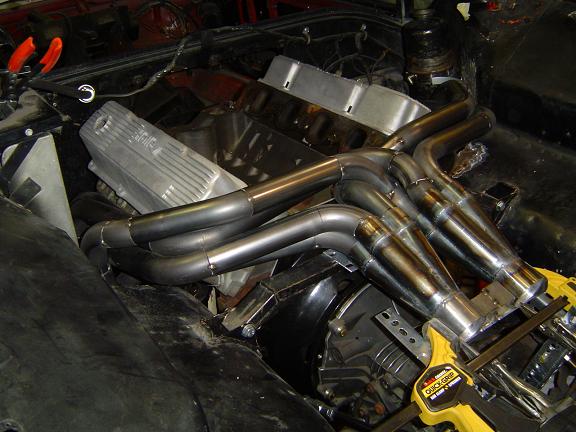

Well it’s been awhile, but have finally finished cutting and tacking the pipes for my system. Changed the pipes around to get a circular firing order and tried to get them the same length as much as possible.
Also used Jims post to make my own merged collectors, but think I’ll buy them next time :)

Good job Clayton, it's a lot of work isn't it ! You might have seen the 5.4 exhaust on the open day posts, quite a packaging effort to get similar lengths and cross over. The time consuming bit next is tig-ing up all the joins and linishing them all off, count on an hour per join for a really good finish.
Well done again, PB
Nice work!
I particularly like the attention you paid to tucking in the front pipes on both sides to get them as short as possible. I would imagine that you plan on ceramic coating them when complete. If not, I would probably consider wrapping the front pipes to keep some of the exhaust heat off the valve covers / gaskets..
Again - very nice work!
Thanks Paul
My hat goes off to everyone that makes up these headers. Working on your 1 hr per joint, I’ve got another 57hrs to go.:uneasy: The mandrel bends I got were crap and had to cut off the tail that was clamped in the bender. This means a lot more welding.
Thanks Randy
Yeah, they will be ceramic coated inside and out. So wasn’t too concerned about the closeness. Also tried to keep a decent gap between the pipes, apart from the top crossover one of course. The longest pipes were 2 & 6, so by keeping 1 & 5 close to the head it allowed 2 & 6 a shorter route.

Wow, very nice Clayton. Beautiful work. I'm always so impressed by how much more hands-on and practical most folks are down under. Here in the States, most of us would be hmm'ing and haw'ing and fidgeting over what exhaust shop to go to, getting recommendations, etc. In Aus and NZ you guys just go get some bent pipe and start mocking it up - et viola, with some care and skill you have a beautiful bundle of snakes. Simply amazing.
Very nice work Clayton, well done. As someone who has been making headers for several years now I can appreciate just how much work goes into it. I am fascinated by the small stubs you have made coming from the flanges, how did you form them? because they are much nicer than the usual hammered ends. I have been to work on two original cars this week ( making bespoke silencers ) and I can say that the headers on both those cars are c---- (rubbish ) compared to yours. Well done, Frank

Yeah that and giving the plug leads clearance was high on my list. The photos make it look impossible, but the plugs are real easy to get out. These photos show a little bit more of the plugs !!

I’m sure I caught the illness from my old man, he’s a fitter and turner and has always made everything himself.

Spent days making different dies and in the end it turned out to be quite a simple piece.
A short pipe slides onto the jig and is pressed on two sides, than rotated 90 deg and pressed again (with clamps on the first side). The collar is for getting them off after pressing. The other tool is for getting a tighter radius to fit the flanges.
After welding them from the head side, the flanges were machined flat.
Hope this makes sense.

Clayton, awsome job on the pipes!
Could you tell me how many J or U bends you used?
How much straight pipe?
What did your primary length end up to be ?
