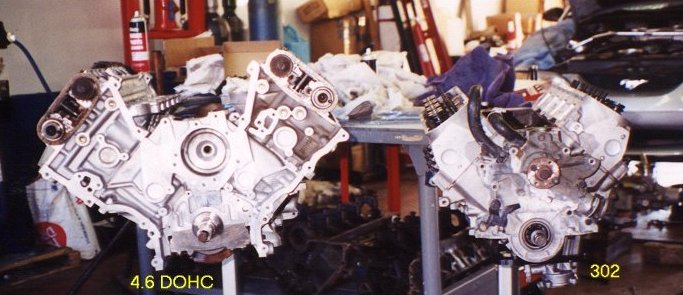

Good luck shoving a 5.4L, especially 4-valve, into a GT. It is wider than a 427 Cammer. Attached is the picture showing the difference between the 5.0L and 4.6L 4-valve. The 5.4L is even wider and taller.
Adam

With that wide angle the exhaust system would have to make some tortuous power robbing bends. I don't even think we'd need Adam to model it but I'd love to see the pictures anyway.
My plan, as it stands now, is to utilize the mod 4.6 4v and you're right re: the '00 Cobra R...good luck. The intake manifold and cylinder heads are impossible to find factory replacements. Even if you could get that motor it would be a nightmare if something were to go wrong.
Just need to install the heads on opposite banks so that the exhaust exits the center of the engine and the air is fed in the sides where the side scoops are /ubbthreads/images/graemlins/smile.gif

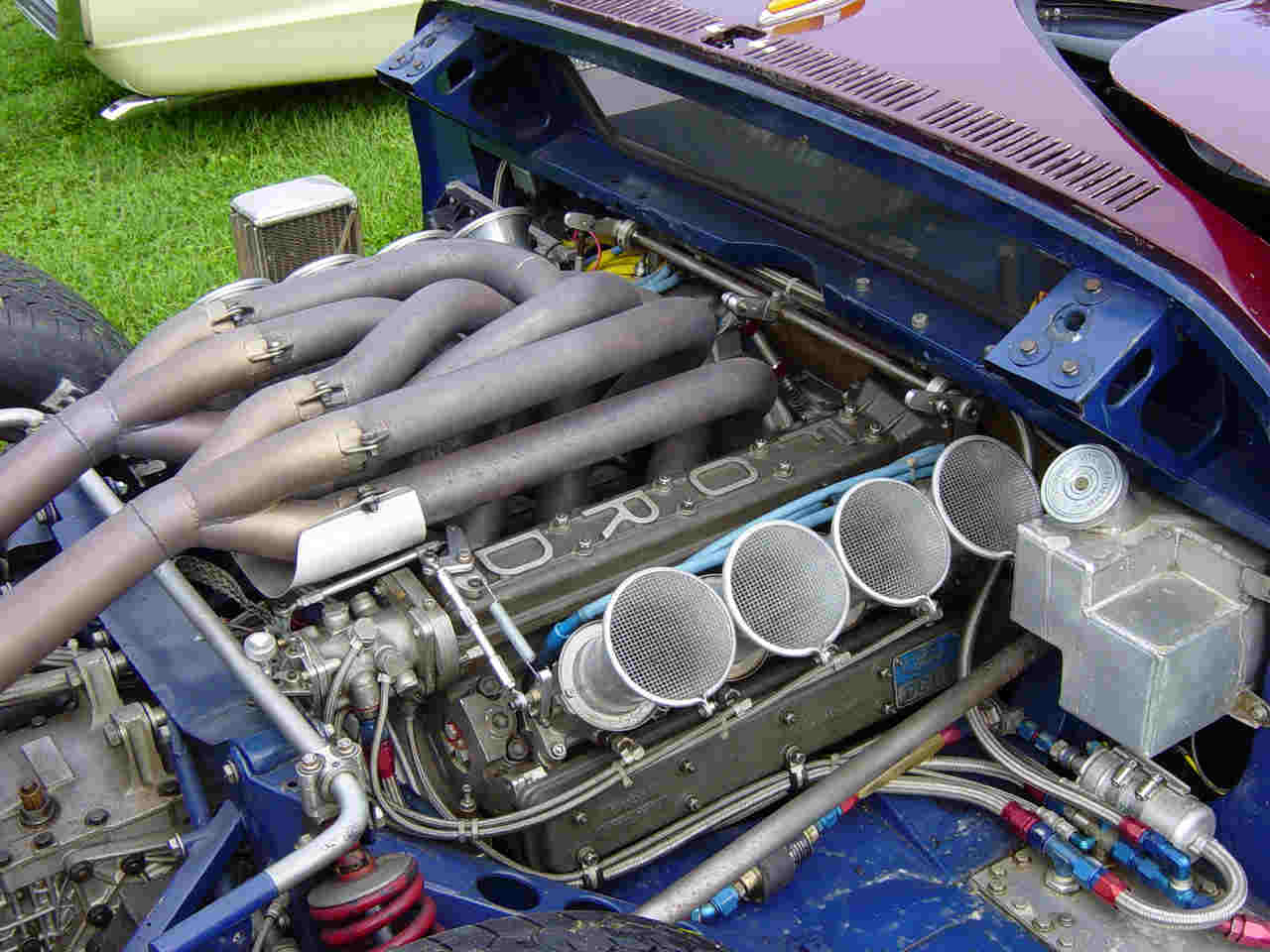

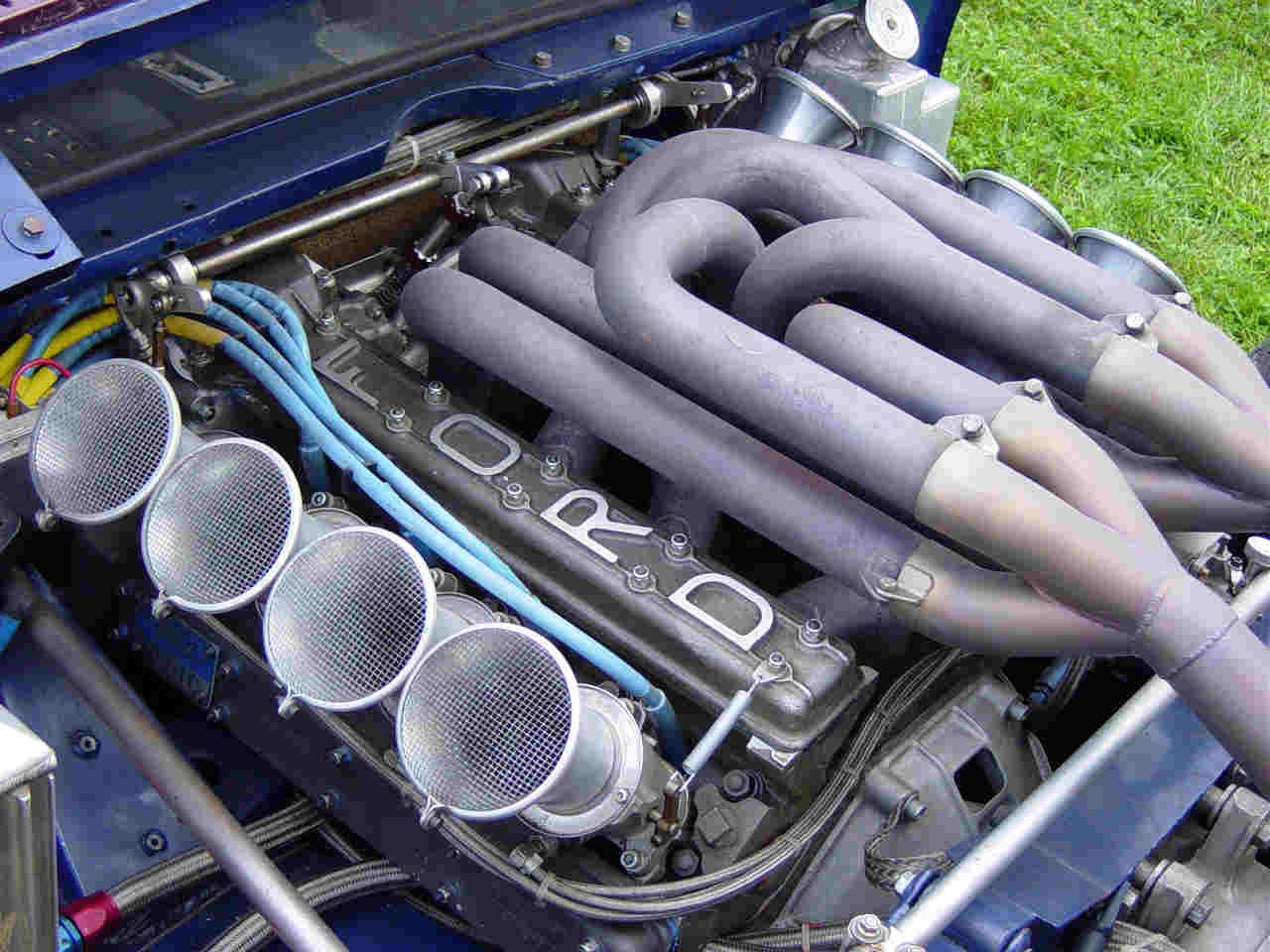

Hi Guys
thought these photos from Jim Rosenthal may inspire you?
Don't know if Jim is going this route with his new Monocoque or not?
Chris

Rick Muck- Mark IV
GT40s Sponsor
[ QUOTE ]
Gary,
I have seen pictures of a Grand Prix car with the headers in the valley on top of the engine. Regards,
Lynn
[/ QUOTE ]
This worked on the 255 DOHC Indy engine because the intakes were sandwiched between the cams. If you could flip the heads on a 4.6 or 5.4 you would still have the issue of the intakes being outboard. I think it would be difficult to flop the heads as the cam drives are angled to the crank center and would be mis-aligned if flipped.
BTW, I remember seeing a USAC sprint car with a Ford DOHC installed where the problem was they couldn't have the exhaust up top in a front engined car. They flopped the heads which put the exhaust low on the sides and VIOLA!! It is possible on the 255 as the cam drive is via gears and the heads are "mirror image" units. And Bill Wonders GT 103 with the 255 is a neat setup and was the original intention of the GT program. The fact that they had a hard time making the engines go 500 miles much less 24 hours was a reality check for Ford.
I have access to an original 255 DOHC manual, a friend wrote to Ford in the 60's asking for pictures of the engine and they sent him the complete owners shop manual! /ubbthreads/images/graemlins/ooo.gif
Rick /ubbthreads/images/graemlins/smile.gif

Jim Rosenthal
I should give a photo credit for the pictures of Bill's car, as I didn't actually take them. They were shot at the Radnor Hunt Concours in PA last fall, by my friend Ken Merritt (Ken's dad is Dick Merritt of Ferrari note, and author of several Ferrari books). They were at Radnor with the Bizzarrini 5300 Strada which went to PB last summer. Ken shot a number of photos, and was kind enough to give them to me. Bill's car doesn't get out all that often, it was nice of him to bring it so that folks could appreciate it.
