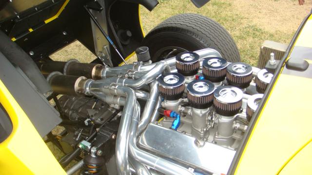

one issue we could not fix was the very stiff throttle pedal. impossible to heel and toe. ive done a search here and looked a some fixes, but those dont seem to work. we dont have any kinks in our cable.
any suggestions?

ok, regarding the throttle pedal.....
after inspecting the cable, etc, my conclusion is that it takes that much more effort to open the 8 throttle bodies in the fuel injection unit itself.
even when worked by hand it takes the same pressure as i exert on the pedal.
true, you get used to a stiffer pedal, but it makes heel and toe shifting about impossible. that takes away a lot of fun for me.
anyway, i didnt see a spring mechanism on the fuel injection unit so i called al from thor motorsports. i purchased the FI from him and his after sale service has been excellent.
he said he believed each throttle body has a spring on it but wasnt sure exactly how or where. he promised to get back to me.
anyone else have fuel injection experience stiff throttle pedal and it wasnt the cable?
ill post back when i have something more to add.
