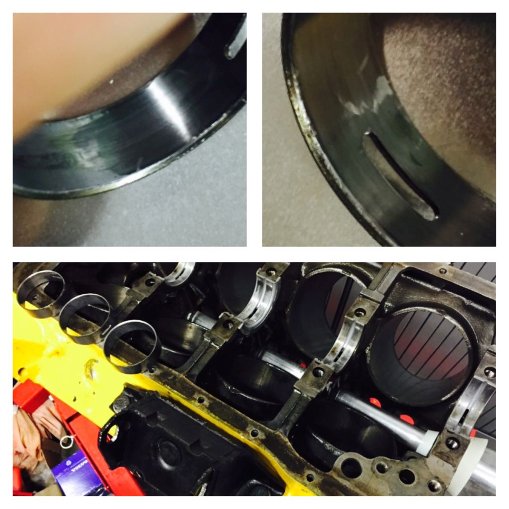

The caps are indeed numbered and in the correct position.
In the past, i built 4 to 5 stroker blocks and they all turned freely with the caps torqued to spec. I know measuring the used bearings is not ideal but despite the bigger clearance, 4 out of 5 caps prevent the crank to turn freely. Tonight I will measure all the other diameters. Let see if that gives more insight. This engine ran only 20 miles after the last rebuild according to the previous builder and seller. The original advert and pictures are on this forum, showing a nice and shining engine. I have a micrometer and guage to measure the diameters. I have heard the engine running on my visit.
I remember the huge wobbling of both waterpump and crankshaft. Also the rear pivot bearing to support the gearbox shaft shows ovality.
The harmonic damper was bad for sure since i noticed the outer ring was not in line anymore with the inner portion.
Perhaps better to buy first the new bearings and restart the measurements.
The rear seal is split rubber seal which is greased and is not the route cause. Number 5 cap is the only cap which let the crank turn freely.
Going by what you are saying I think the block may have the wrong caps with it. Its not unheard of for caps to get mixed up in engine shops, I would put the caps on the block , torque them down with no bearings or crank in and measure the housing diameters.
Bob
Mike Pass

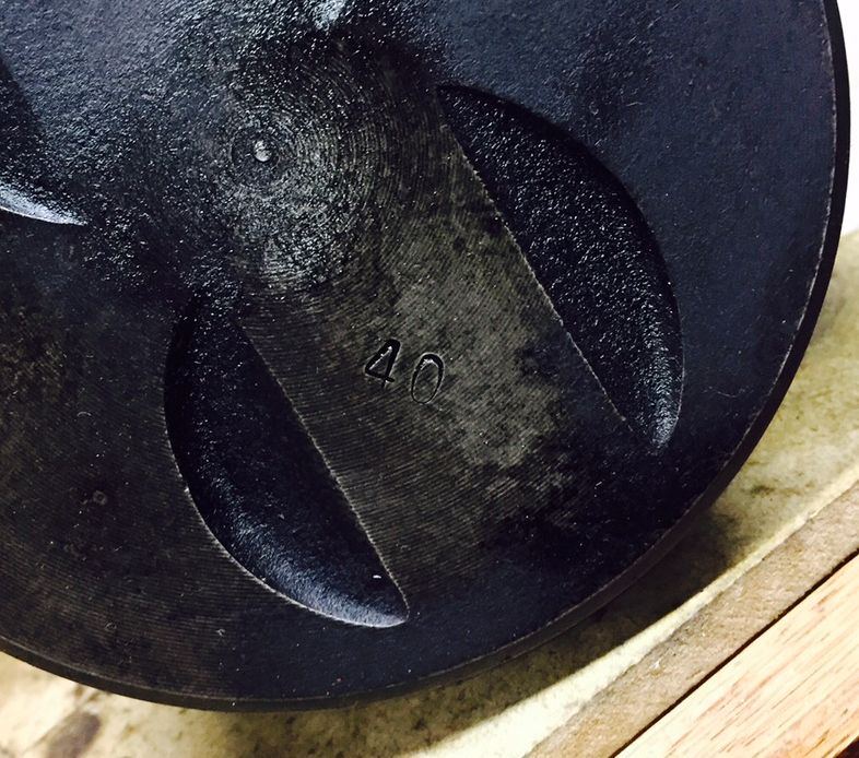

The pistons are Silvolite 1177 which have a 0.030 overbore but I found a manually stamped on top of the psiton the number "40"....could it be the catalogue is wrong ?.
The sideskirts of the piston measure 4.035
nd the left side of the engine looks to have bit bigger bores compared to the right side...
The discrepancy in the bores is down to the machinist . When you set up the cutter on the boring bar and start boring each bore will rub a bit off the cutter. If the guy doing the job cares about what he is doing he will reset the cutter after two or three bores and bring all the bores to size with the hone when he is finished . In reality some of these shops dont care and will run the boring machine down all of them without correction, a quick hone and thats it hence the variation. A lot of piston scuffing you see on stripped down engines is where they have been run on a tight bore :thumbsdown: In some cases they start at the front of the block and work their way back so the rear bores are the ones that end up tight which is the exact opposite of what you need with a V8, good machine shops will give the two back cylinders which generally run a bit hotter half a thou more clearance .Most of them just hope the customer does not own a bore mic. I bought my own Van Norman boring machine and a Delapena Hone because I was sick to death of arguing with machine shops over shoddy work.

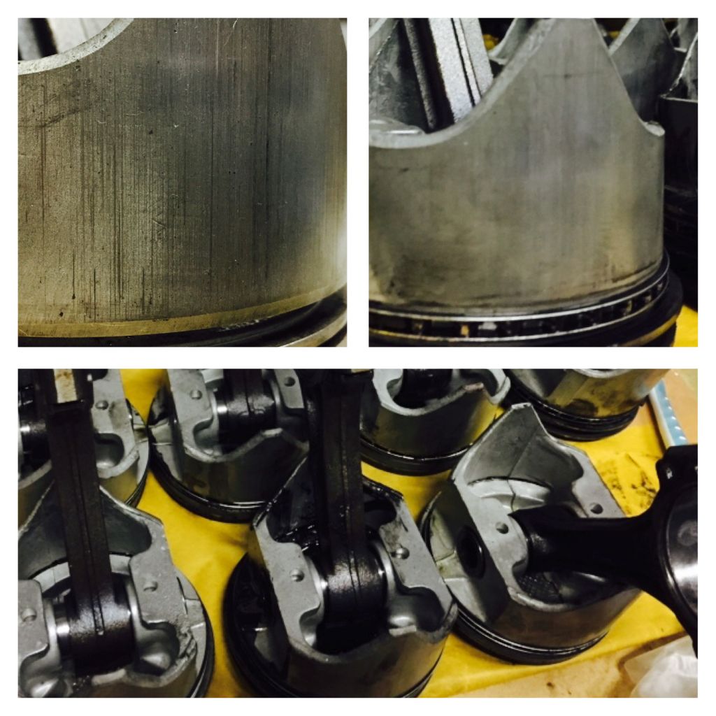

Checked the sideskirts of the pistons. They show clearly vertical marks. see picture.

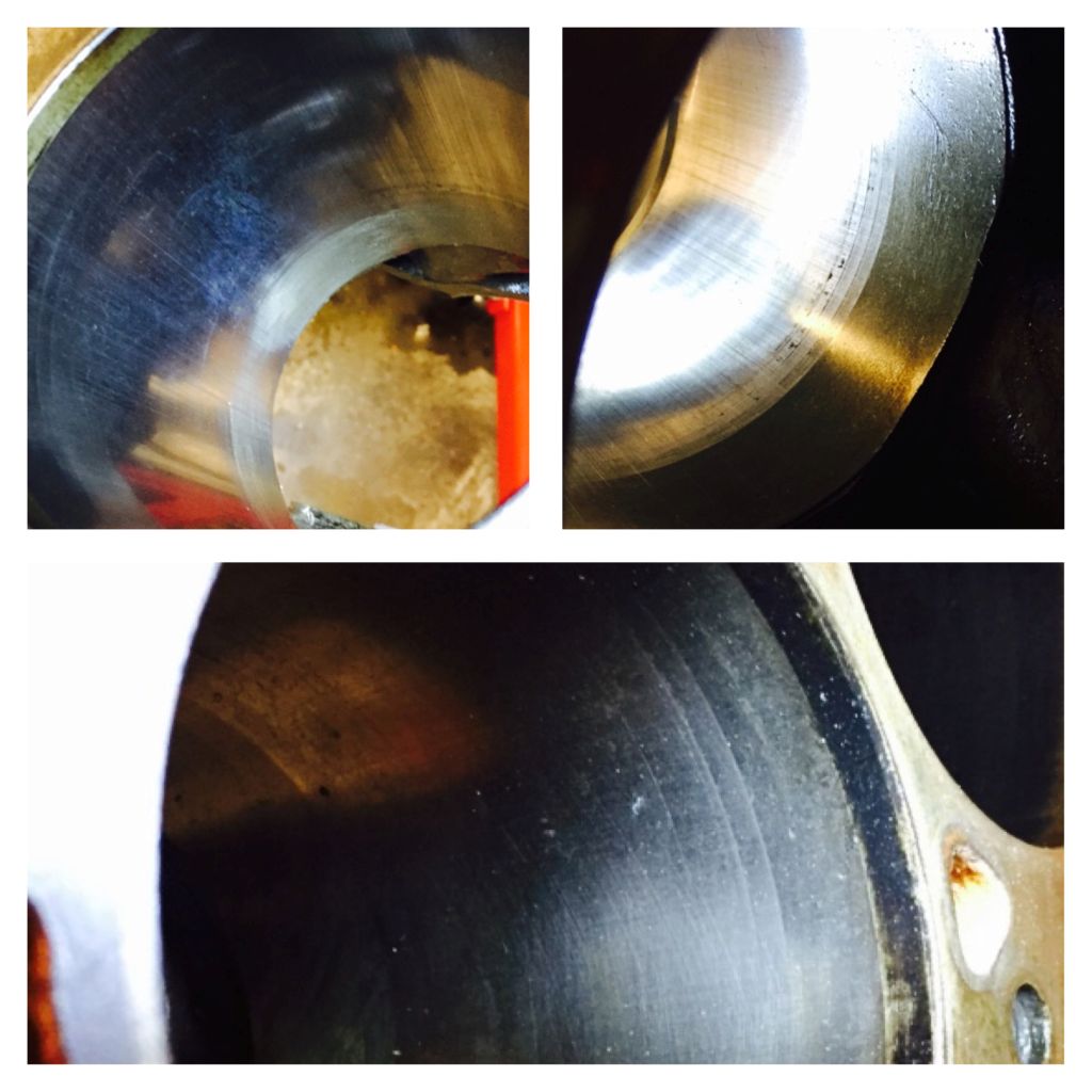

Checked the piston walls. The honing pattern is mostly gone and lots of vertical marks..not deep but visible. Hope the honing will remove them.

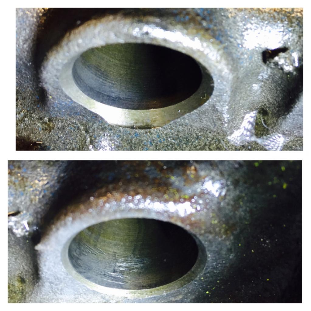

Visually inspected also the bores for the lifters.
Most of them have wear spots and one had marks. This one was the one where the lifter was eating the lobe. Now I have to find out if the bores are still within spec. My book let me down on this so I will also check internet sources to see what is allowed. Your input is offcourse more as welcome.
I used one lifter and compared the bores and some are nice tight and some show some slight wobble. Needs to be checked since when this is over specs, it is still game over.
attached also a picture of the piston mark telling it belongs to gt40 :laugh:

It looks like a lot of the metal powder from the scuffed cam has gone through the engine. The bores should be salvageable. Is any steel powder embedded in the pistons? Try the finger nail test to see how bad the bores feel. If the lifter bores are too worn they can be sleeved. This is often done on race engines with bronze sleeves which are grooved to get good oiling and the correct clearance.
The boring and honing job seems to have been very poor as they should be spot on exact. The grinding metal paste will have done a good job of wiping out the honing pattern! You should be able to get a useful motor sorted until you do the stroker.
