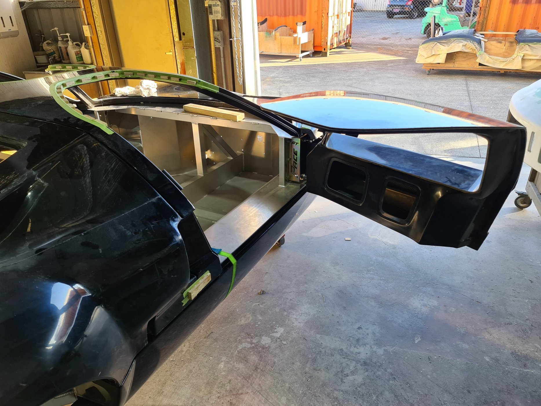

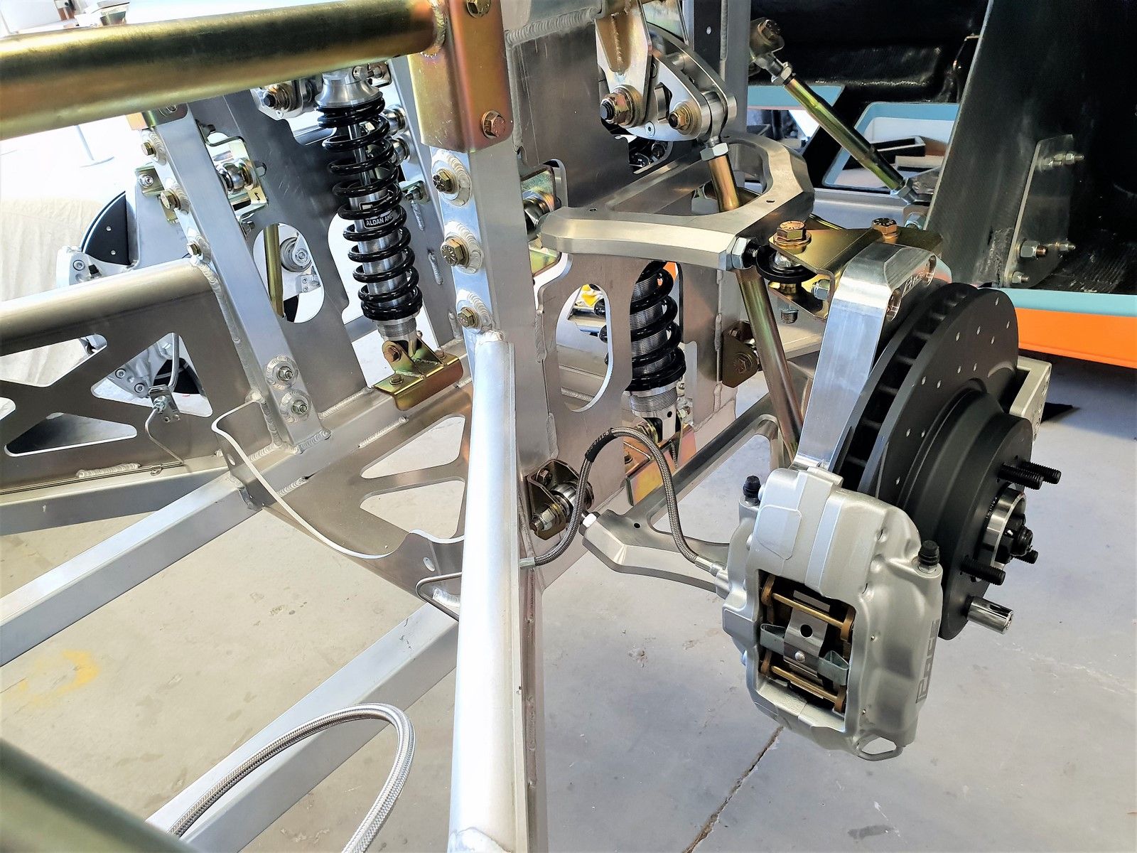

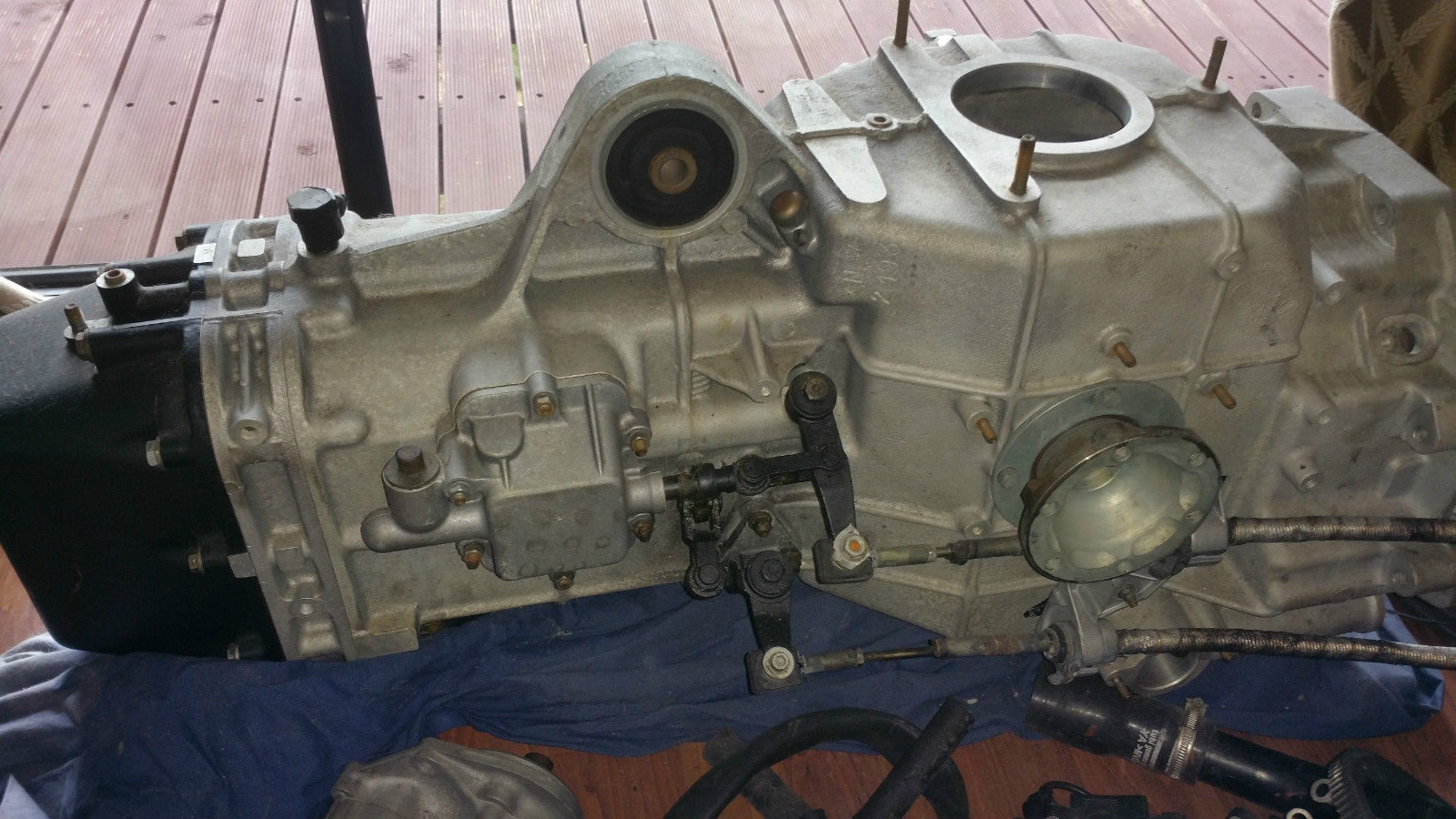

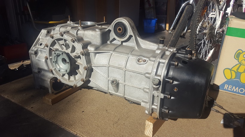

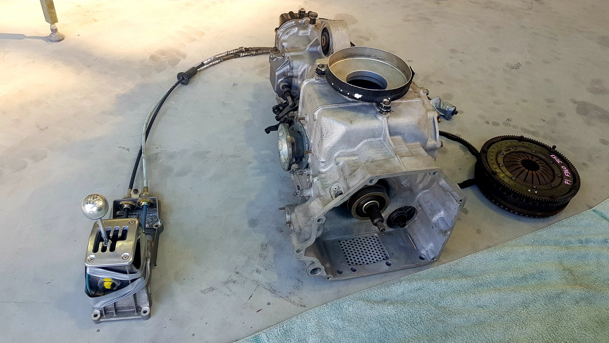

Plenty of gearbox options, including Graziano boxes designed for other cars. I had a Ferrari 360 standard 6spd gearbox just laying around which is made by Graziano, another avenue to explore...
Hi Joe. Yes, Mine is the Ferrari powered one.
Hi Troy,
Have you got any more info on that gearbox? Do you still have it? (laying around)
No, don't have it any more. They're not too hard to find, although most have the hydraulic F1 shift system attached.

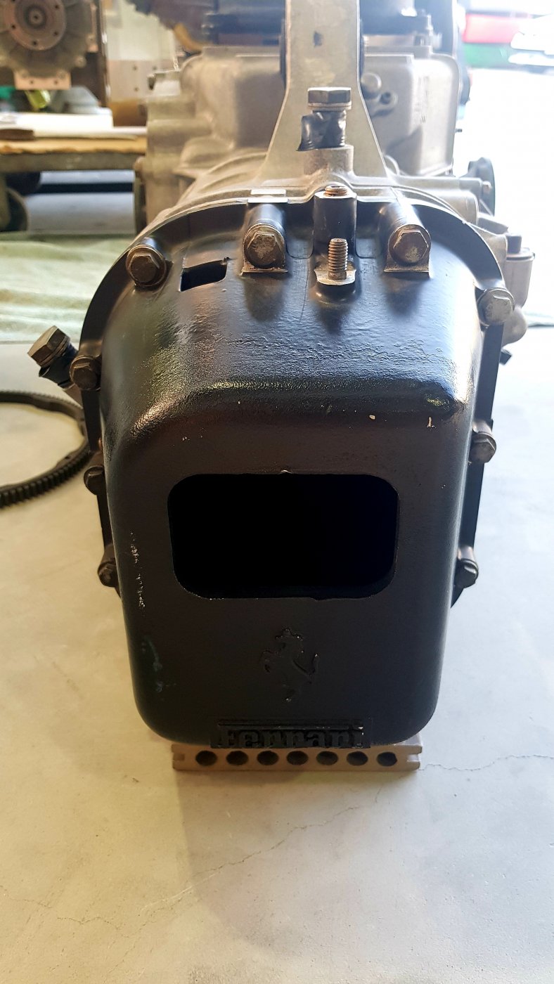

The gated 6spd mechanism swaps easily, as they are the same gearbox. The big black crash structure on the rear of the box can be machined off, to shorten it by around 100mm+
Great box, and strong too.
