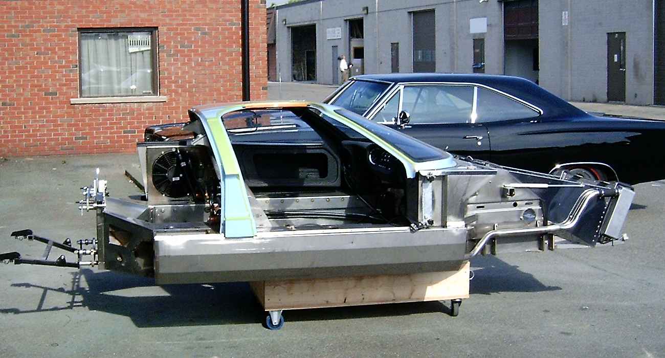

Hi Jim,
My 2c worth: Test fit all the panels on the hinges and latches provided. Pay extra attention to the spyder as it determines all other panel fits. If the spyder is wrong the doors won't fit and the rest won't matter.
If your confident none of the paneling will change the postion of the spyder or any hinge/latch points then you can go ahead and do this before paneling. I'd be tempted to bond the windshield in place as it probably contributes to the shape and structure of the spyder.
Once your satisfied the spyder is in it's final position you can gap the mating surfaces of the doors and front/rear body sections. Be sure to run all panels through their full range of motion making sure no contact or even close arcs of travel occur. The leading edge of the door to the front clip for example.
At this point get the body shaped and primed with all panels fit, latched and with weather seals in place where they affect fits (like doors).
Then, take the panels off the chassis (except the spyder) and store in a safe place. We don't want any suicides over scratched or chipped paint because you tried to build a car around painted panels:).
OK, if your determined to see colour, paint the spyder, even then protect the edges with a few layers of masking tape. You might as well remove all clocks from the garage now! Cheers

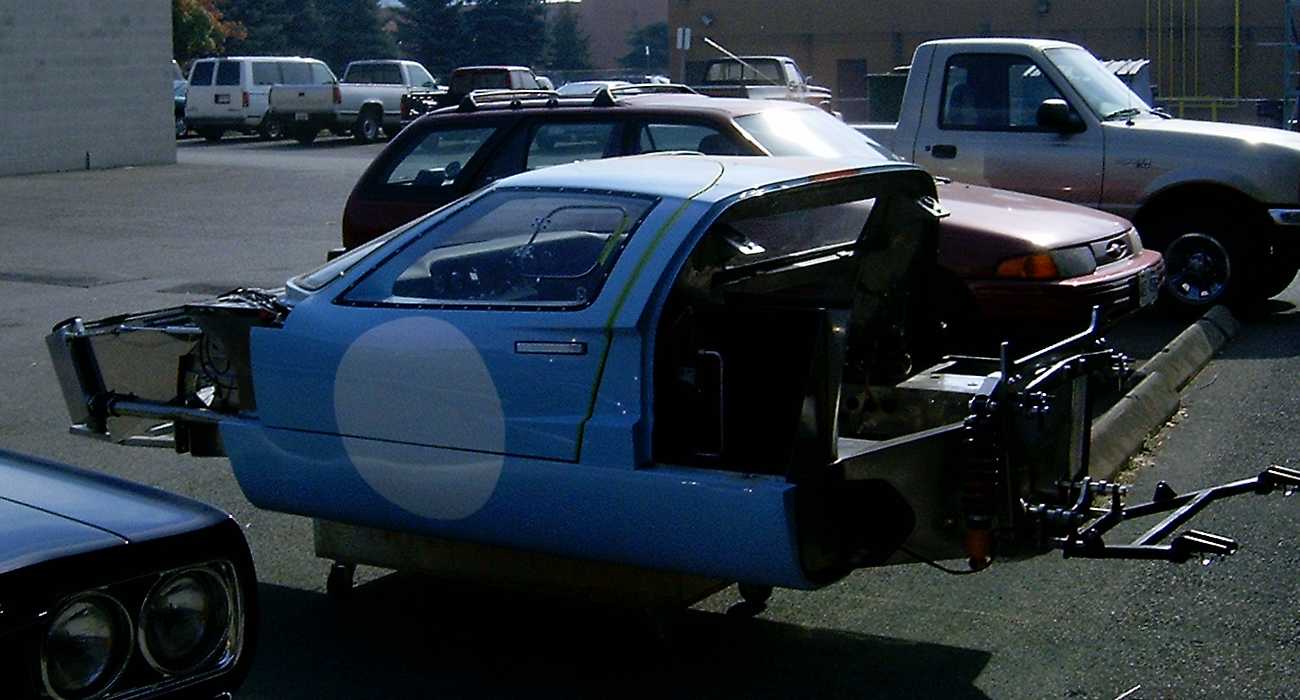

Pic 2, You gotta start somewhere, protect those edges!
