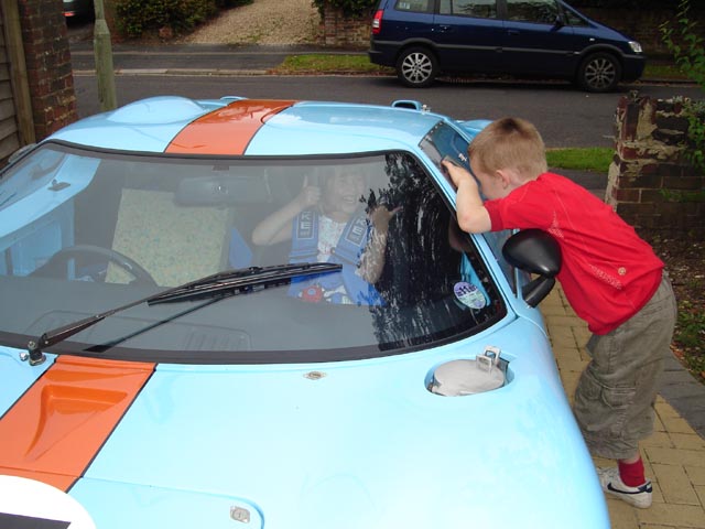

Depends what age of child you are looking at. I fitted Rebecca's seat (aged 5.5 years) which is just a regular child seat from Halfords but I don't know the make at present as Wendy has taken her car out for the morning. Below is a picture.
However I did have some reservations on doing this and so waited a long time before going onto public highway with a child in a child seat in the car. Grace is not going out in the car for a good time yet.
I use harness straps. Our child seat has two slots above the shoulders that I was able to put the straps through to prevent Rebecca going between the straps in a shunt. Also I raised the seat up so that the shoulder straps were horizontal at the top end. This also made the lap belts work better. I couldn't get the crutch strap to work as the bar it is attached too was really digging in to Rebecca's legs. This is a weak point in the set up although reduced by making sure the lap strap is correctly positioned. But then Wendy and I also didn't go too fast driving with her in the car. In additon I also gave her ear defenders to wear. Rebecca loved it.
I guess things may be easier with a typical car seat belt arrangement and also with a standard seat and not the high sided race seats I use.
