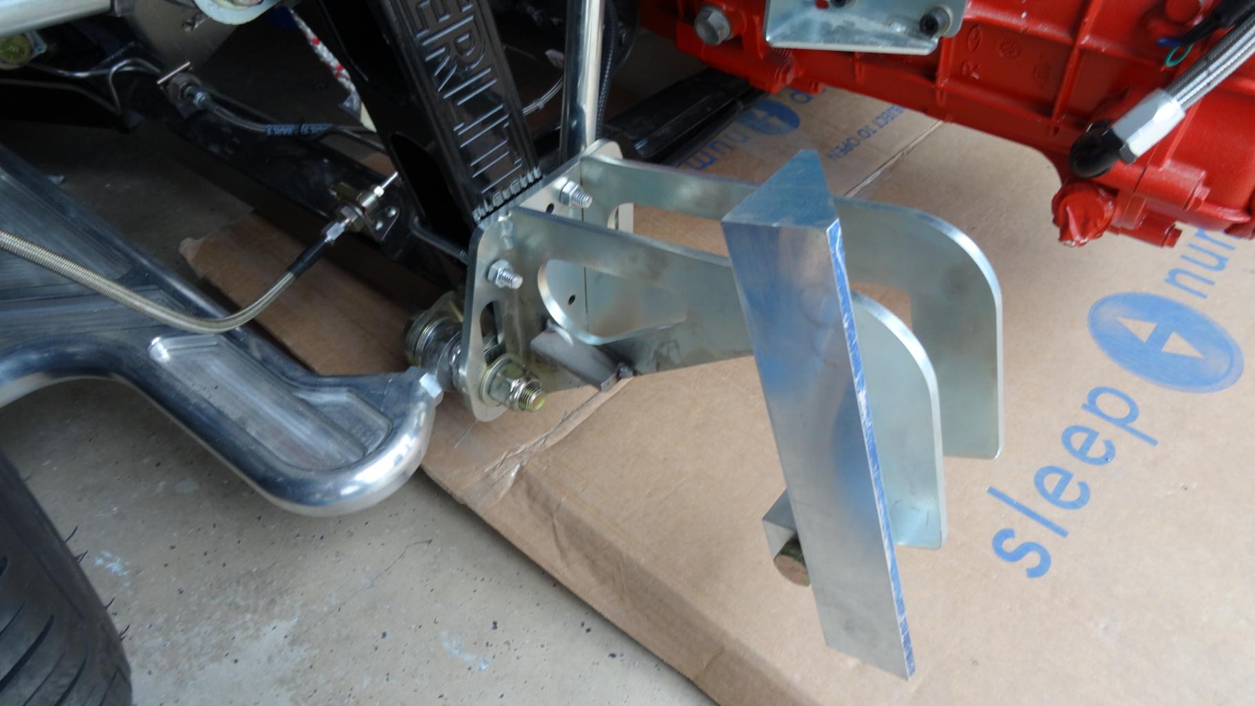

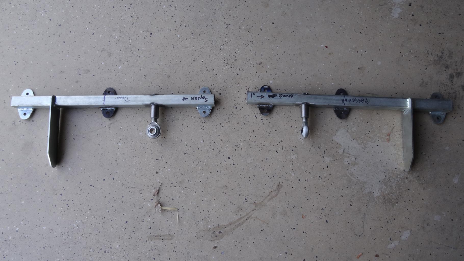

Purchased the 90 degree hinges. Working the tail to cover the hole for the Graz and to make the area around the hinges and street tail bottom bigger to hide the necessary slots cut into the tail.<?xml:namespace prefix = "o" ns = "urn:schemas-microsoft-com<img src=" /><o:p></o:p>
Modified the mounting bar to beef up the heim joint attachment bar by replacing the nut with a threaded tube. <o:p></o:p>

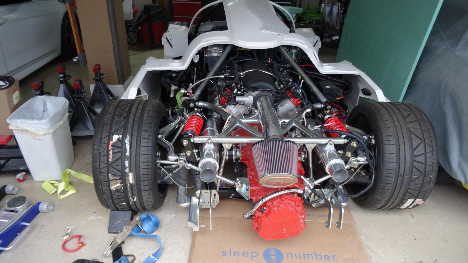

Been focused on clean up the last week or so.
1. Straightened out the exhaust and added muffler hangers
2. Adapted the 90 hinges to transfer the street tail wing to the frame (copied Mikes approach and added my own twist). Note the U clamp on the top of the hinge to add support as well as the stop to hold the rotating bracket.

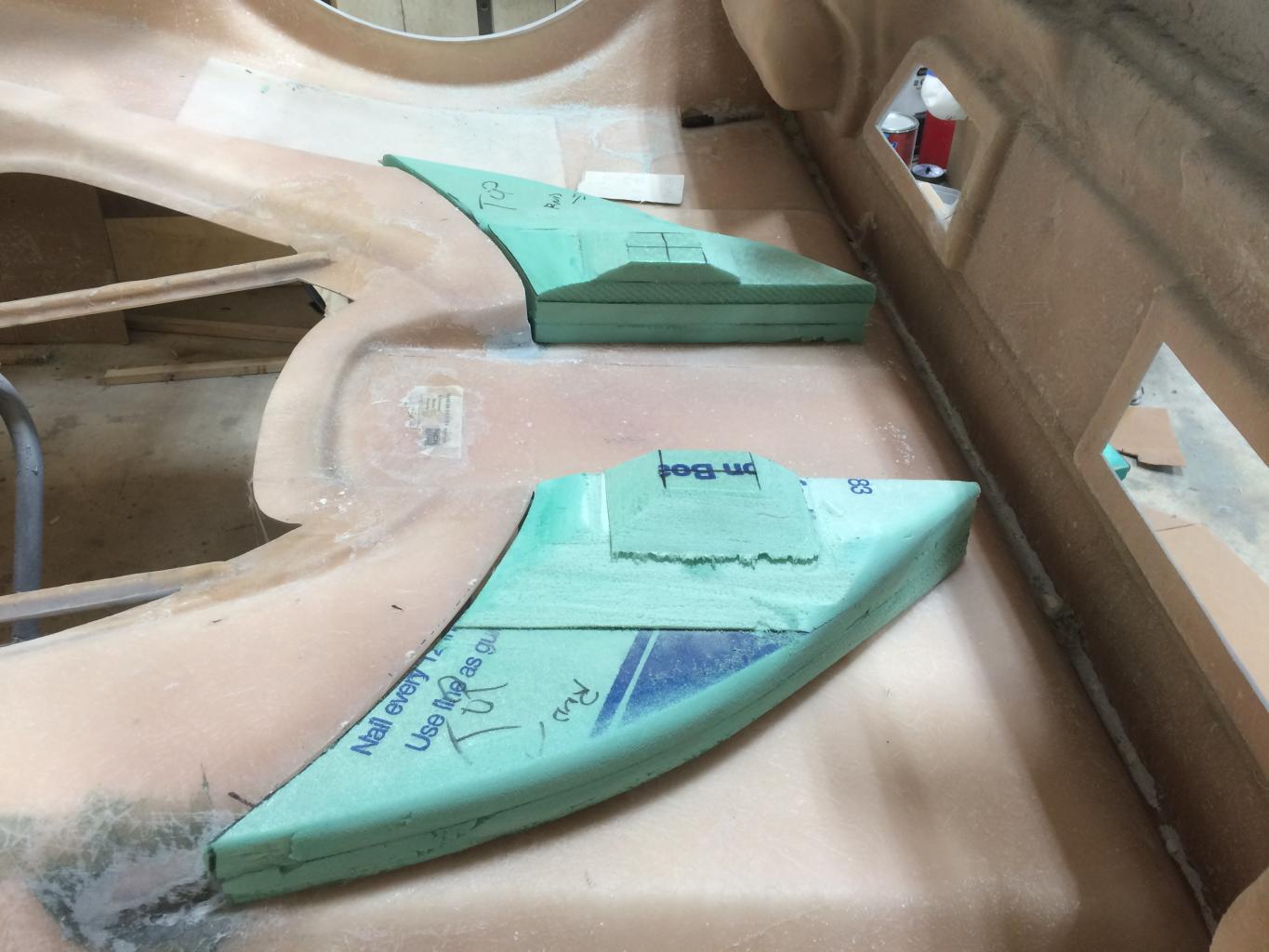

3. Prototyping the tail scoops to direct air into the air filter box (not yet built).
4. Glassed in the revised lower tail section, primed, blocked and ready for paint.
5. Added fuel to the fuel system. Pressure check is next.
6. Re-primed the engine. added the fuel inlet tubes to the tank (not clamped yet) which required me to adjust some heater hoses. Getting ready to hit the start button for the first time.

Big day today
We had engine start. A few systems leaks to clean up.
Infinity one start is a bit touchy and doesn't start every time. Touching throttle pedal prior to a start seems to helps, not sure why. Any Ideas?
GM MIL light is on at fuse box but OBD2 (tech2 compatible??) reader shows no codes. A power cycle turns light off but comes back on once started.
Congratulations!!!! That had to feel good. Until you actually build one of these, you have no appreciation of the many things that could go wrong if not done properly. Great Job!
I had a bad hose on one radiator section. Replaced it and all is good. Some of the fuel line AN fittings were not tight enough, nothing a wrench could not fix.
So a few more SS brake line fittings to tighten and the major systems are leak free (fingers crossed).
Have yet to fill the AC system , but expect a few leaks there to be consistent.
Hearing the engine fire up for the first time was incredible. It remotivates you to reach that finish line......

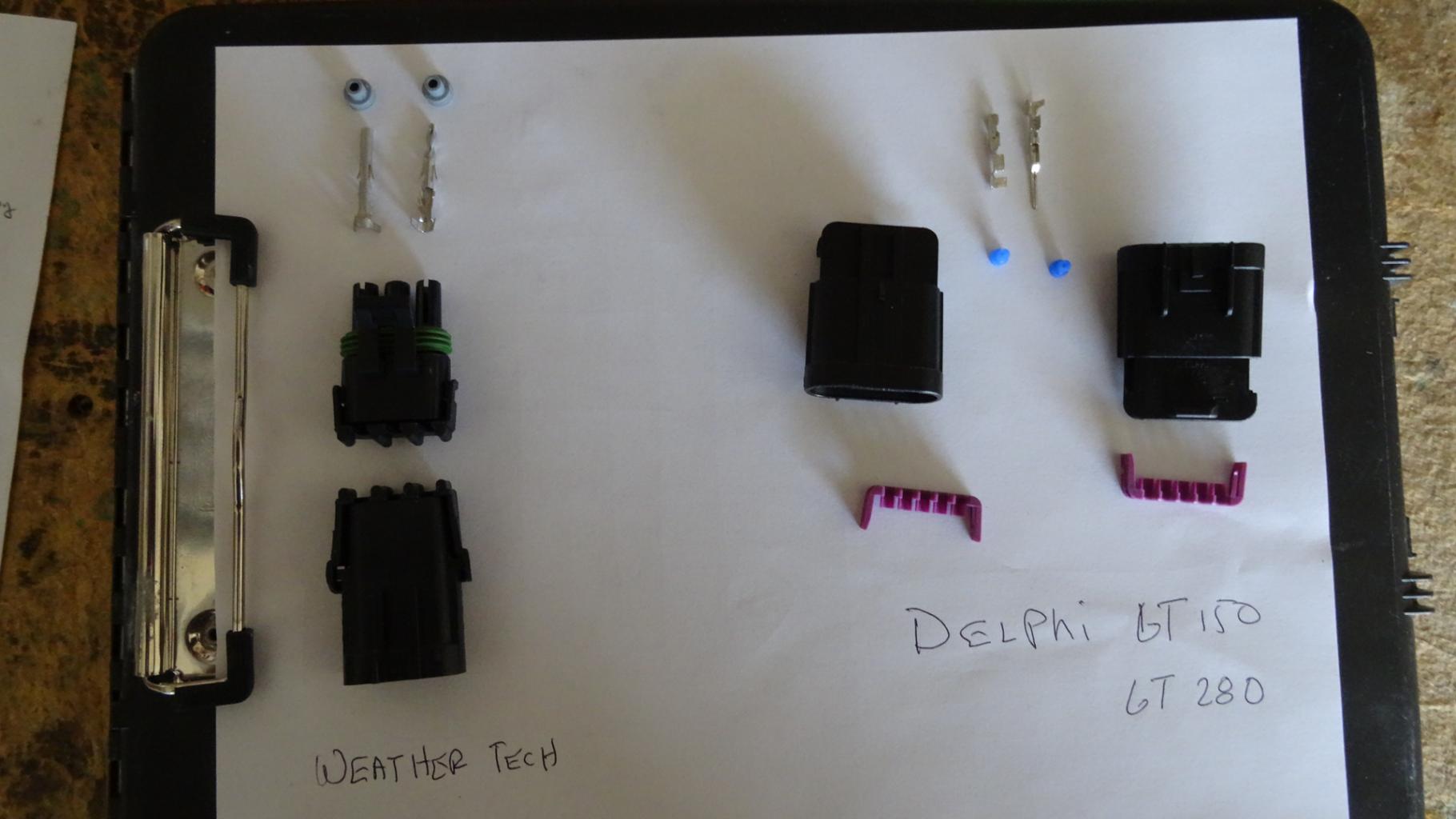

I thought I would share with the new builders a perspective that I know I did not have going into wiring and alignment. This is my opinion which may vary from others, but it’s what I experienced during these two phases.
1. During the wiring phase, I elected to abandoned the factory instrumentation and purchased gauges which were non-digital (I like gauges that I can see relative needle location aka aircraft style). Anyway, this change made me take a hard look at differing wire connection styles. In the attached photo, there are two basic styles that I used, Weather Tech and Delphi. The Weather Tech are physically larger and easy enough to work with, however, I found that the male pins had a propensity to deform at times while being plugged into the female side of the plug. On the other hand, I really liked the Delphi GT 150 and 280 series connectors (other side of picture). The differences in the 150 and 280 series are the pin sizes hence the AMP loads. The 150 series is smaller (aka instrument panel stuff) and the 280 has larger pins for bigger loads. I found that the connectors had more pin quantity variety (aka 2 up to 10 or more pins). This made it possible to design more flexibility into my harness. It is the builder’s choice, but I really found the Delphi (and there are other brands with similar features), a better choice and merits your consideration.

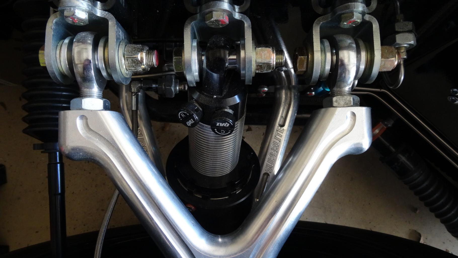

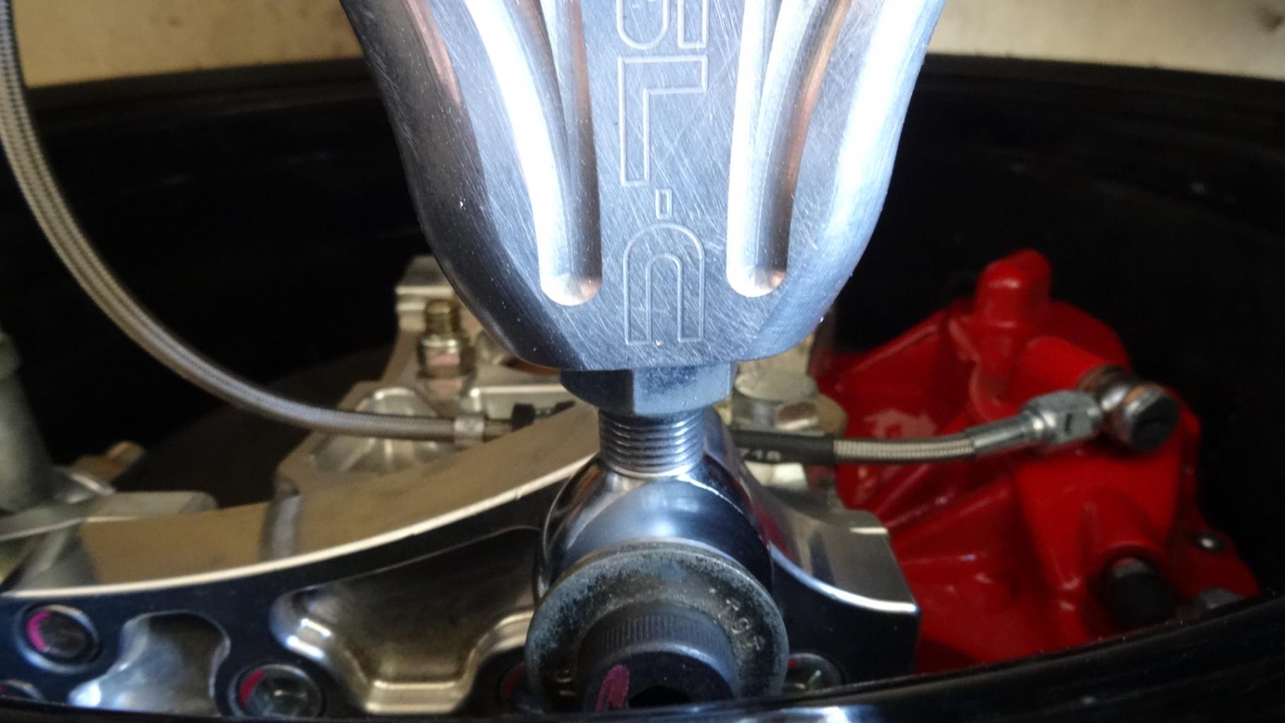

2. As for alignment, it really starts the moment you put your suspension parts back on the frame. To achieve the camber (~1 degree), caster (5-6 degrees) and tow (1/16) for a street machine, I would suggest you set your inside heim joints with about 4 threads showing outside the nut. I discovered that the outside top A arm heim, gave me 1/10 a degree change in camber for a full rotation of the heim. I set my system on the ground by using two vinyl tile with grease between them, placed this under each tire so the suspension could move as I adjusted it. I accepted the caster settings preset by the factory which ended up around 5.5 to 6 degrees. I take my caster measure with a little grain of salt, as I lacked the precision needed to measure the caster, but it was close. As for tow, I used the string method and adjusted the front and back to achieve 1/16-inch toe. There are a lot of variations on how to achieve the rough alignment, but this is the technique I used and it’s not far off. I will eventually have it professionally aligned, but this gives me enough confidence to get the body aligned.

Hey Dan. You did the alignment part a touch backwards. You must first locate square, parallel, track and wheel base. First is making sure the frame mounting points are correct. You were able to get each corner relative to itself, but you don't know if your track is offset, or parallel. Or, if wb is exact each side. So basically, your car could still crab without doing the full process.
Basically to do this, you will be creating a large rectangle, with an X in the middle for your measurements. With chassis lifted, you will be using a plumb bob to transfer the mounting point locations to the ground, and put some tape on the floor, and mark position of mounting points on chassis. Based on marks, measure for equal wb, equal track (based on centerline), then square with diagonal measurements. If that all checks out, then proceed to installing the lower control arms with spacers side to side, and depth of the rod end equal (unless you had to correct for anything in your previous chassis measurements).
Now, with lower control arms installed, set them at 0 degree angle. This is how you want to set them to measure again. This time, you will be using a consistent position near end of control arms ( I use ball joint zerk fittings if equal, or ball joint centerline for measuring) and repeating your square, and parallel measurements a second time. If all checks out, then you are ready to install uppers, and use then you can use your basic alignment procedure to set uppers. If you cannot get the uppers in the correct position, then you will need to move the lower. If you move one lower, you must move them all, or you loose you previous squareness.

I can't seem to get the lower A arm to adjust as the cup holding the lower A arm will not come lose (4 bolts) I'm afraid I'll strip out the bolts.
:huh:
You cannot adjust anything inside the rear most lower front control arm pocket
That is the fixed zero point from which the suspension needs to be set
