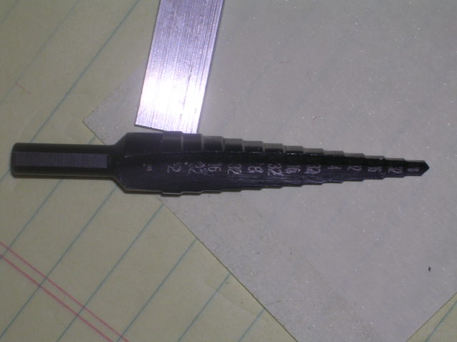

For drilling plexiglass (lexan), I have had a lot of luck with the drill bit shown in the pic, (assumining I uploaded correctly). I call it a step bit, but I am sure that is not the name of this type of bit. This bit is graduated sequentially from small size to next larger increment and is not a twist bit, so it does not grab lexan and crack it like often happens with twist bits. (read: twist bits grab the material much like the action from a threaded bolt).
For those of you who want to step up the size of your hole to accomodate a small o-ring around the screw as recommended by Hershel
"You also need a very small rubber O-ring that will fit under the screw head. This O-ring seals the hole and allows the plexi or lexan to expand or contract without cracking it"
this is the best way I have tried to increase the hole size. I am also looking at small sections of silicone tubing in order to cut small slices and make simple, correctly sized O-rings.
As always, practice on scraps, use 2 felt covered wood pieces under and to the sides of the hole and I like the idea of warming up lexan (sounds like a good idea, but havent tried it yet).
