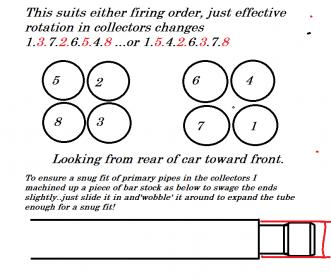

Looking from the rear of the collectors the firing order:
- 8 3 - 7 4 -
- 5 2 - 6 1 -
This seems to be what the originals had.
Looking at the firing order for the 289, the left collector fires in a circular fashion right collector, it seems like that 6 and 7 should trade places?
- 8 3 - 7 4 -
- 5 2 - 6 1 -
