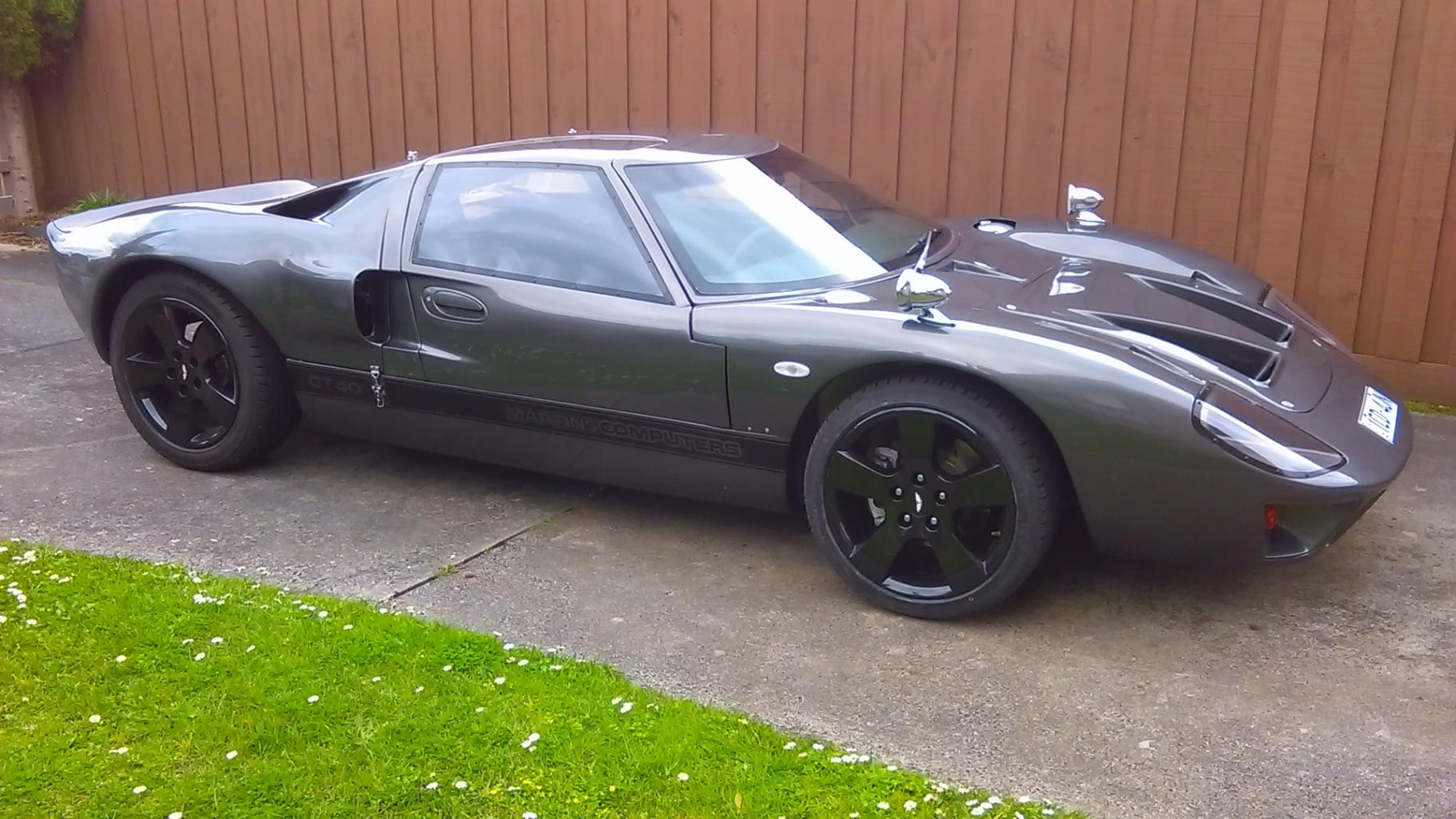

Hi All,After driving the GT for 6 months I noticed it was wandering a higher speed,as my front wheels are 17" with 245 tyres I couldn,t get much caster Tyres hit on fenders.
I changed the front tyres to 215 x 40 and got 40mm more clearance,now I am able to get 5 1/2 POS caster,what a difference its like a different car.

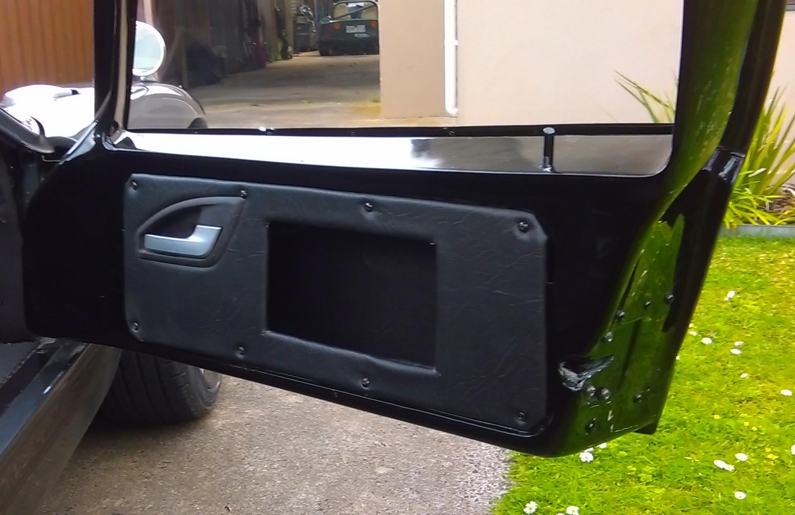

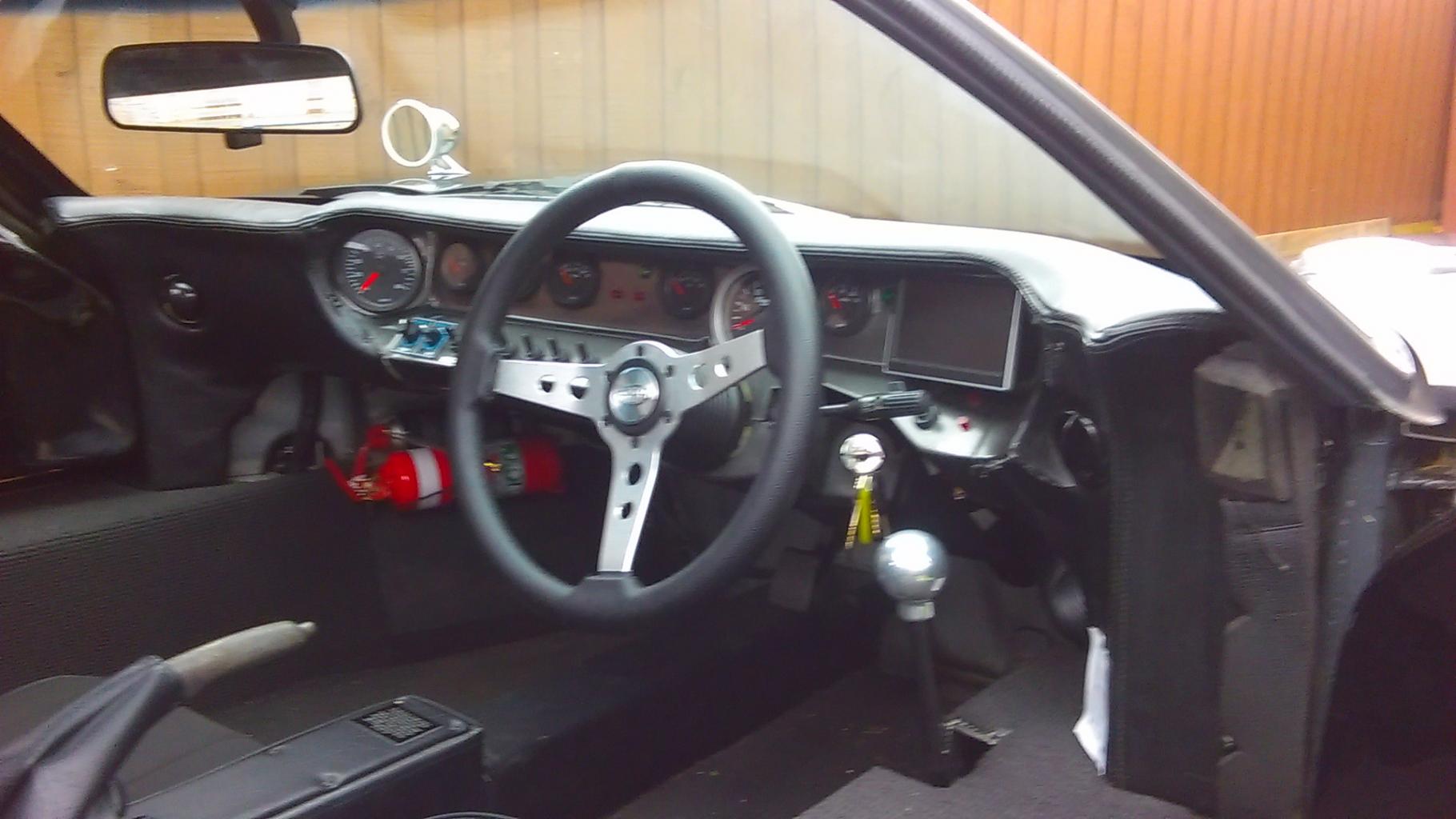

I also added smaller steering wheel and now have a lot more leg room,with the doors modified for a bit of luggage space my wife is happier ,I also have sealed a lot of air leaks its gets better everytime I drive it!!Also had my rims painted now it looks the parts
