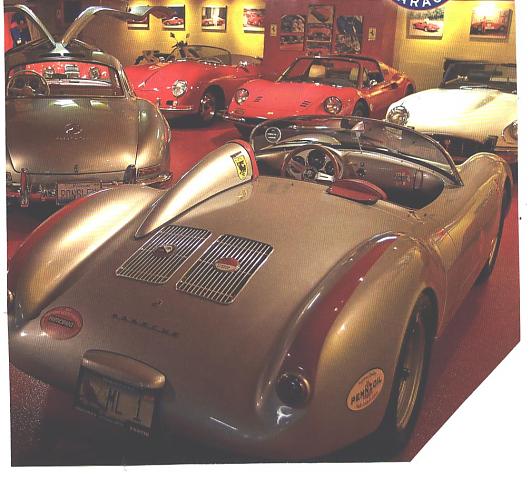

Garage - What features would you select?
GARAGE: Very Nice, Huh?

John, not sure about that garage there, a bit to showy to use for a working garage to run race cars out of for sure!

Wow!!! Diecast18, what a fabulous garage! In my dreams. I'm ashamed to show this photo of my garage which has a combo of Racedeck and epoxy flooring. 2 four post Eagle lifts. It allows me to store 4 cars in a 2 1/2 car garage, and i could probably get 2 more in if I used Quickjacks (lets you slide the car around 360 degrees).
Now I'm looking for lighting, but I'll guess that the large round lights in the photo are extremely $$$, plus they look like they would have to go deep into the ceiling. Anyone have any ideas on specific high output lighting units?

The photo in the link you posted is not my garage. The photo I posted awhile back is not mine either. It was taken from Griot's Garage website to show what can be done. If I had a larger garage, that is how I would set mine up.
