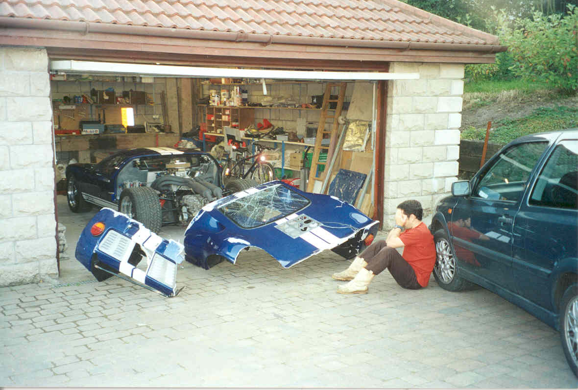

Very sad to have parted with my beloved 40 a few weeks back. Frank Catt prompted me to post the picture below - one of the more dramatic and exciting moments I have to say, in my 6000 miles of GTD experience. I shall never, ever, forget it.
The back flipped up whilst travelling "at speed", acted like a parachute for a couple of seconds before ripping off, and during this time the steering went very light - when I suddenly got steering back, I had turned the wheel in my panic, and the car promptly did a 360 spin, landing neatly in a layby on the opposite side of the road.
I had switched off the motor, unclipped my harness, and jumped out of the car all in one frantic moment - my heart thumping so hard I thought it would burst! The rear deck was still sliding up the road, bounced off the kerb and landed down a banking.
The look of shock / astonishment on the faces of the couple behind me in an Impreza were matched only by the look on my wifes face as she saw the rescue truck bringing the "bits" back (admittedly, all I had told her was that a bit had fallen off the back of the car....mmmmh!)

It took me a long time to get my confidence back, but it did not for one single moment dent my enjoyment. Thanks again to Frank Catt for reminding me that 40 ownership is never dull, and for a class job of putting it all back together.

Ouch!! The rear-clip-parachute thing seems to be one of the more common afflictions of the GT40.
Glad to hear that you were not injured in your excursion.
Nice looking GTD, by the way, even in a damaged state.

Hello Tom - Sorry to hear about your mishap. It must have been a very scary moment. Glad that there were no personal injuries, only broken bits which can be repaired.
I am curious as to what type of latching mechanism(s) you were employing on the rear clip and what type of improvements you (or anyone else) might have made or plan to make as I don't want to have to learn the hard way. Thanks. Best regards, Orin Meyer
As I understand the story, and from our investigations when the car got back to my workshop, it seems that Tom left the Knockhill race circuit, not far from his home, in a fairly healthy manner and sufficient speed to be illegal, and heavily hit a bump in the road which unseated one of the slam catches on the rear deck. As his speed increased to two x illegal air pressure under the deck slightly twisted the body to a point where the other slam catch was torn out of the glass fibre but remained closed and still fixed to the main tub( poor glass fibre work bonding the catch to the clip) The remaining lower catches were only held down by two self tapped screws (standard GTD practice) and these could not hold against the enormous pressure built up under the rear clip. Morals are :- make sure any metal work bonded onto glass fibre bodies are fully molded in and secure, fix the lower catches with threaded screws, preferably with nuts,and dont go ballistic on Scottish country lanes! Having said that, Tom never managed to tear the new rear deck off so we must have made a more secure job, or he has slowed down a lot, which I just do not believe to be possible. Frank

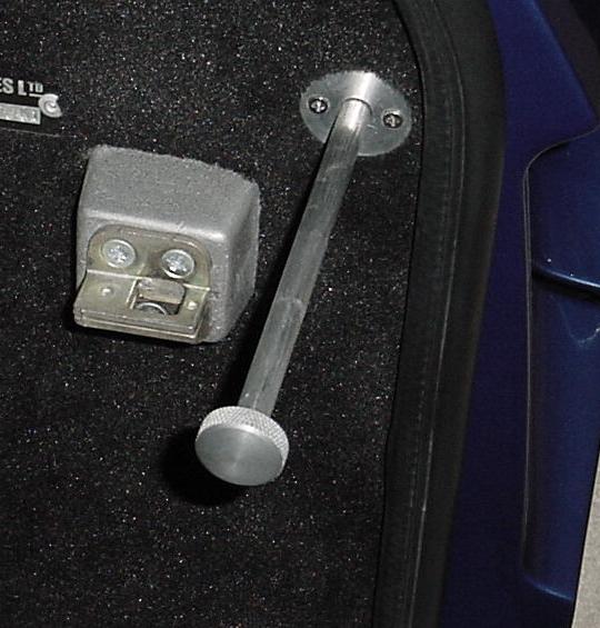

Frank,
My car would have to fall from a cliff, for the rear clip to
come open with the safety pin in place. The pin is locked in
securely, and cannot be removed, whenever the door is closed.
