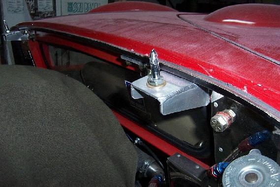

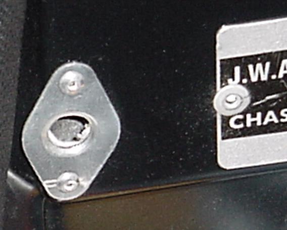

The safety pin passes through a billet ferrule affixed to the door jamb inside the cockpit. On the engine bay side of the spider, and on the rear clip, it passes through Dzus plates, which are drilled out to the size of the pin.

I have the DRB system as well and just to make the system overly safe (I'm not too fond of the actual rear clip latches - may redesign) I've added another one of those pins to the passenger side as well. With both pins in, as Bill said, you would have to rip out a couple of FEET of fiberglass!

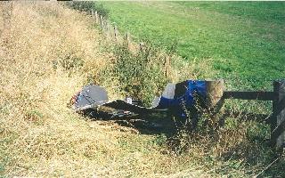

To close out this particular thread, here is a picture of where the rear deck landed.
I'm pretty sure what happened to me was as follows:
I got the car airborne over a bump, and the landing was quite severe (should have stopped to check, but did not).
I had been having trouble getting one of the slam catches adjusted to my liking - ie nice and solid closing action. Also, I had not packed the shutline around the "toblerone" with rubber - so, with the deck closed, there was still 3mm or so of downward movement on the deck, with all latches closed (ie until the top of the toblerone made contact with the top of the aperture it fits into).
When I went over the bump, I think the deck slammed down then back up, the impact of this shock load opened the poorly adjusted slam catch, and possibly damaged the
overlocking catch on that side (as Frank says - secured by 2 self tappers into the chassis rails).
Later, at speed (4000revs in top and accelerating), I think the twisting motion of the deck (now loose at one side) was enough to open up the other side & away she went!
The car now has 2 bonnet pins, in addition to well adjusted slam catches, with heavier release cables, and Frank modified the fibreglass on the rear deck, local to the slam catch mounting, to ensure the release cables were not fouled as the deck closes - which we thought mine were being. I'd advise anyone who has just the standard slam catches without additional bonnet pins etc to check this aspect.
It has been good to share these ideas & different solutions we all have - plenty for me to think about and take account of when I build my next 40 !!
Thanks to all of you for sharing your thoughts!
Tom Gollan.
