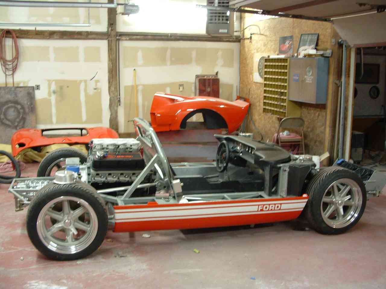

Been working on the GT. Installed shift cables, Tack welded the bundle of snakes, Steering column and wheel in for final.Things moving along now. Ordered all brake calipers and pedal assemblies. will post photos next time.
Started the engine yesterday!!IT'S ALIVE!!!! What a great feeling. I have done alot since my last post.All the radiator hoses, heater hoses, wiring, brake cables,fuel pump, filters, fuel injection computer wiring. I used a "Simple Digital System" to run the injection. This is all new to me, yet the engine ran with only one wiring problem. The hot wire to the sds would not be hot when the key was in start position so the engine would not run.Putting power direct to the sds solved that problem and the gt fired up. I still need to dial it in. I will read up on the details and hopefully I will have it running properly.I can see the light at the end of the tunnel now. I am anxious to assemble the body,but shall remain patient until all is complete inside the driving compartment.I hope to have time the week between Christmas and New Years to complete the rest of the inside. My crew have the week off and I will try to do the same and spend the time in the shop.
A little setback!! Was trying to lean out the engine and heard a squeeling coming out of the bell housing?? One step forward and ten back.Had to remove the transaxle. Found a throw out bearing that exploded? This was new as is most everything so what gives??I replaced it and checked clearance. I made some adjusments and did manage to get the bearing to clear the pressure plate a little more. we will see. I guess I won,t make the World of Wheels show in Boston this week with the GT.I am very close though. I will have time to finish up before spring.I will post photos when assembled

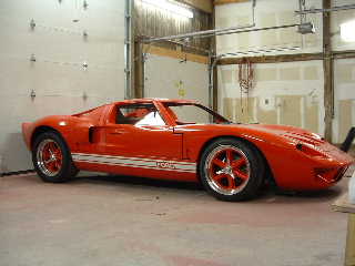

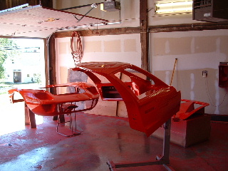

Final assembly now in progress.I,ll try to post a photo or 2.
Sorry for the bad photo. rebatched to a poor setting. ow to color sand and buffing, YUK!! At least you can see production at this point. It seems as though the GT did not change much since Sept. when I painted it. I should be all set for spring running. Will post completed photos soon I hope.

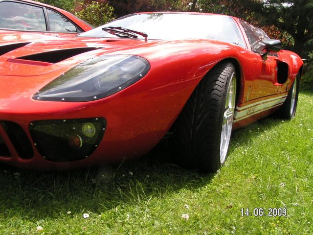

this car has now reached its final destination.(hopefully)
it is living and roaring in Luxembourg, in good ol Europe. It arrived here in May 2009, with, yes, the same problems it had over there in the states, coolant leaking, shifter problems and most annoying of all, impossible to drive the car for more than 5 miles, and several more problems. A big big mess.
But finally we solved the major issues, which can be attributed solely to the engineering skills of the constructor/builder.
But apart from those "minor" issues:shocked:, this car is very well build.
Investment to bring it on the road so far: $10000:po:, with still oversized 48 throttle bodies sitting on top.
will keep on posting when the season starts
J-C
Hi Jean Claude
Congrats to your purchase
as we use to say here, a post like this is worthless without pics :)))
TOM

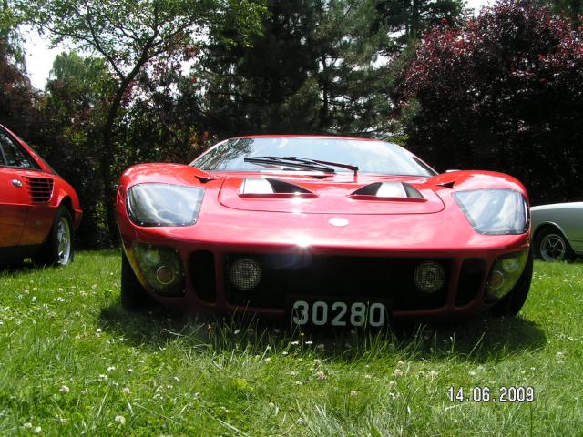

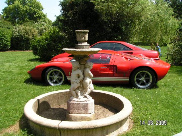

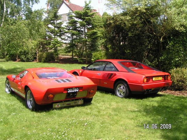

you`re right man,
here we go......
:pepper:
J-C
